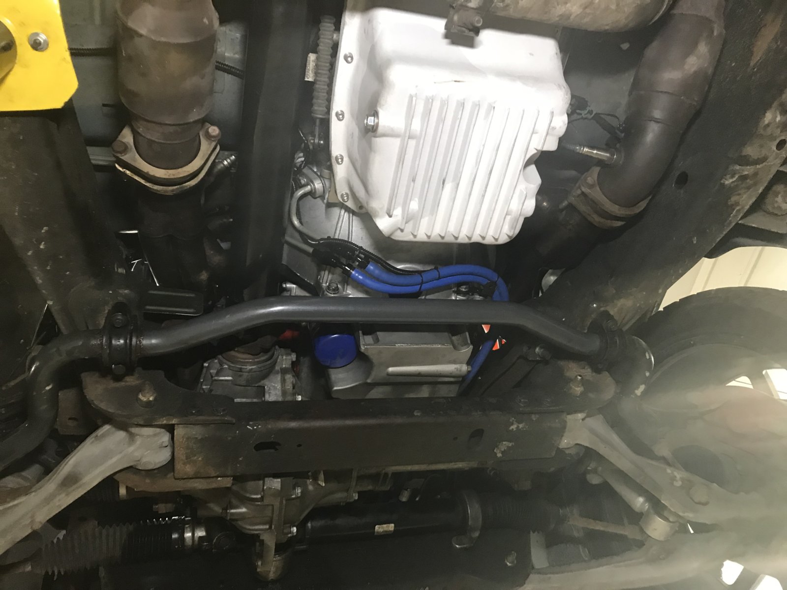

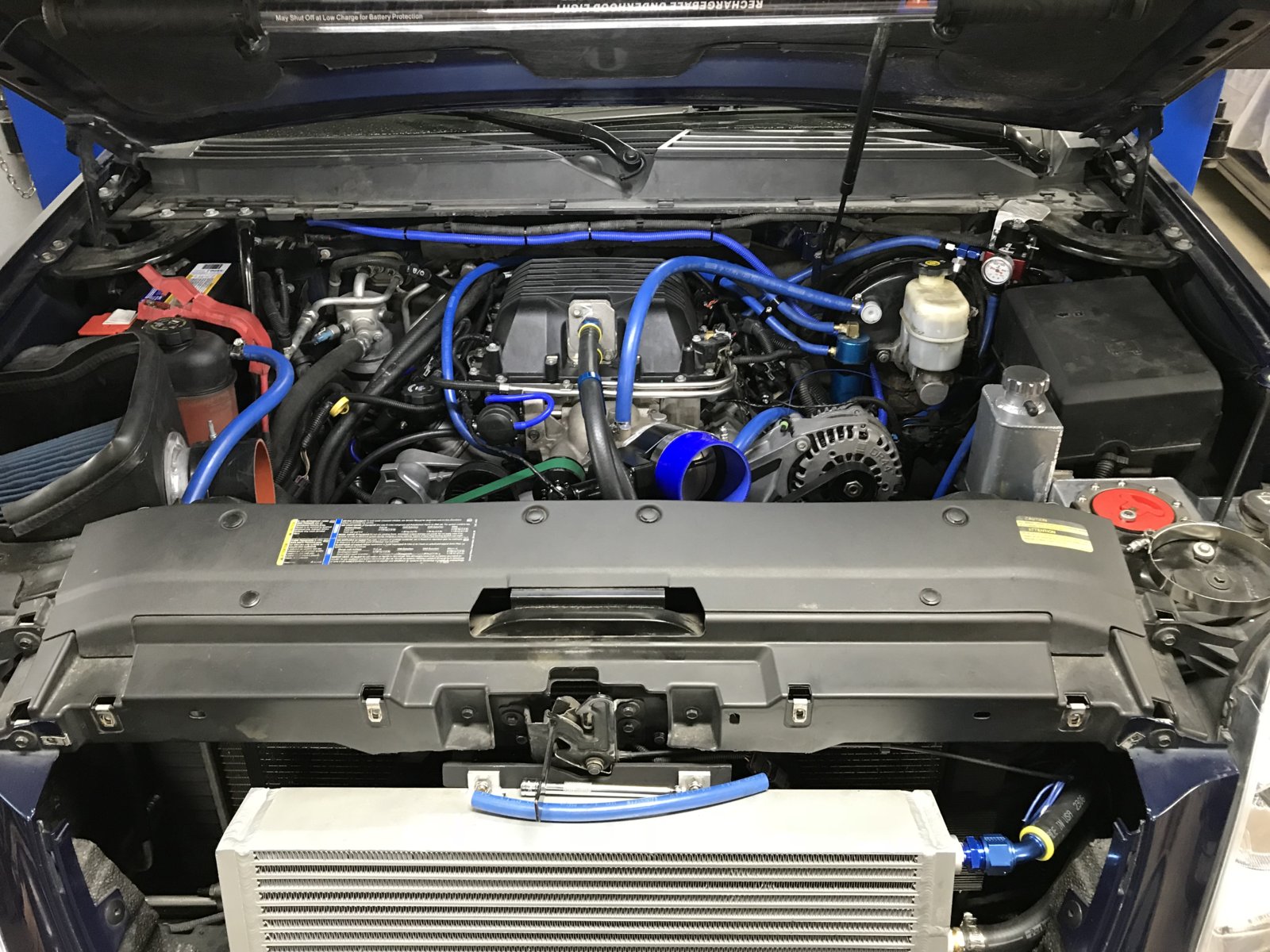

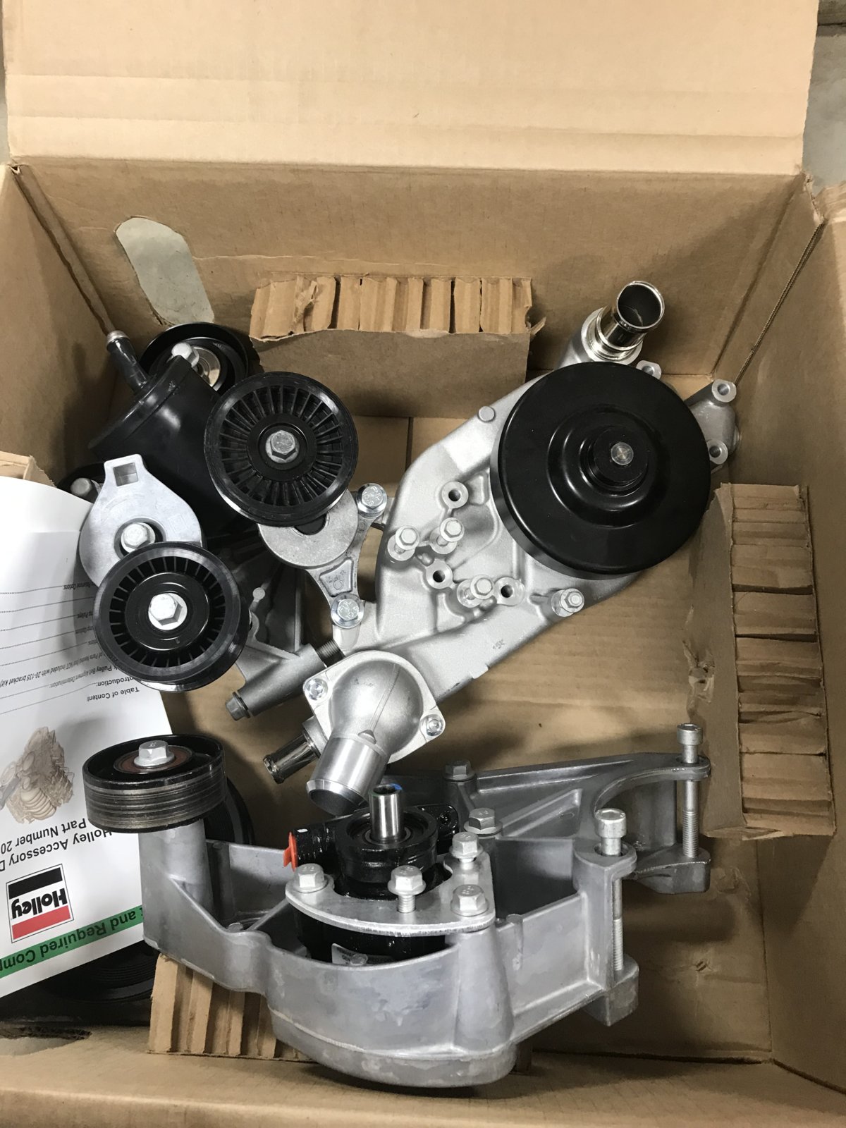

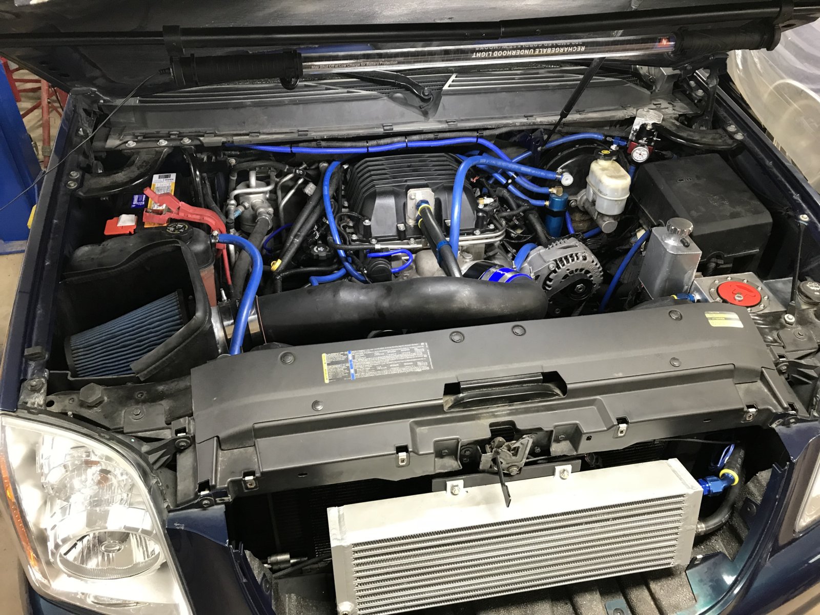

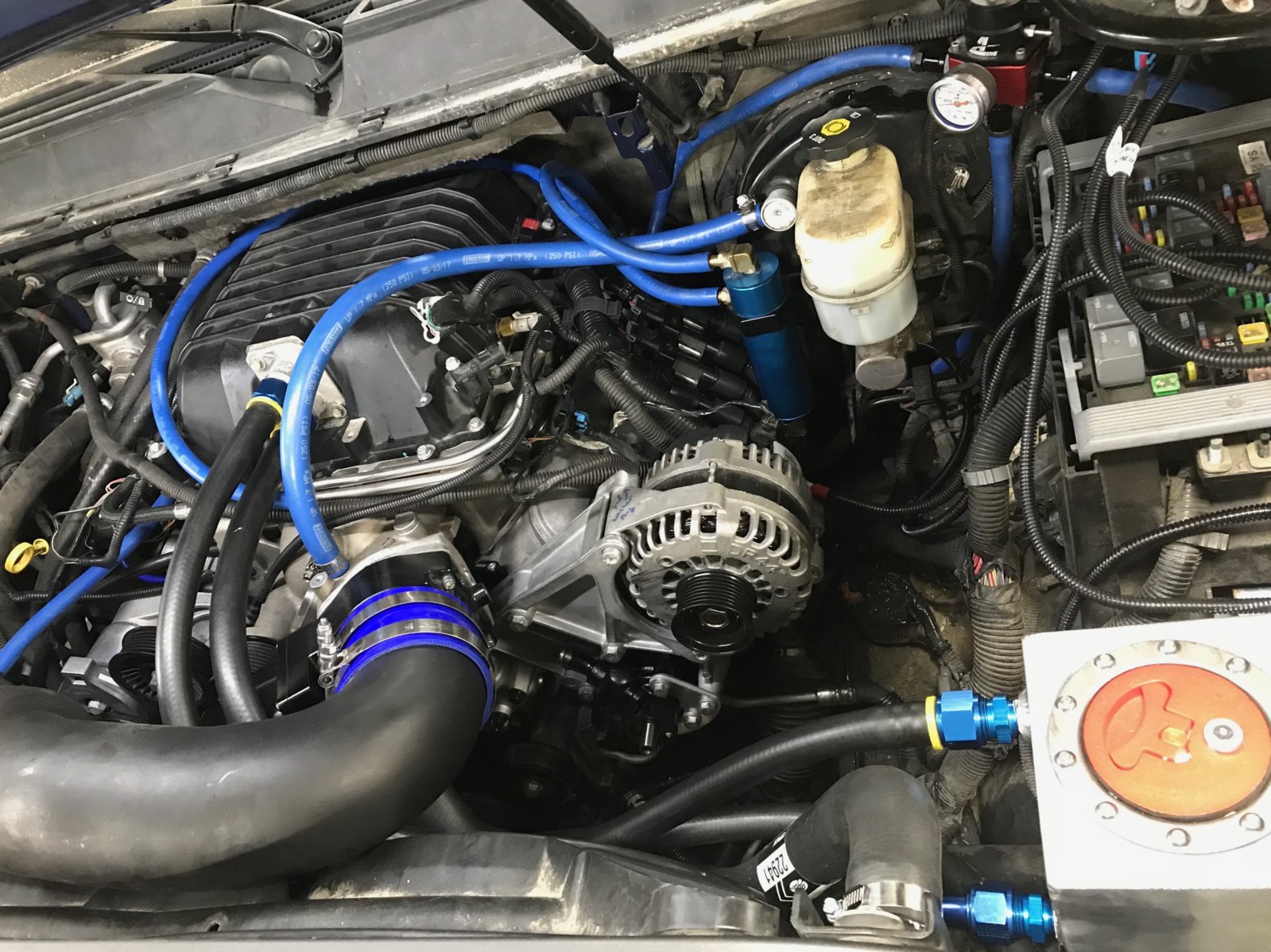

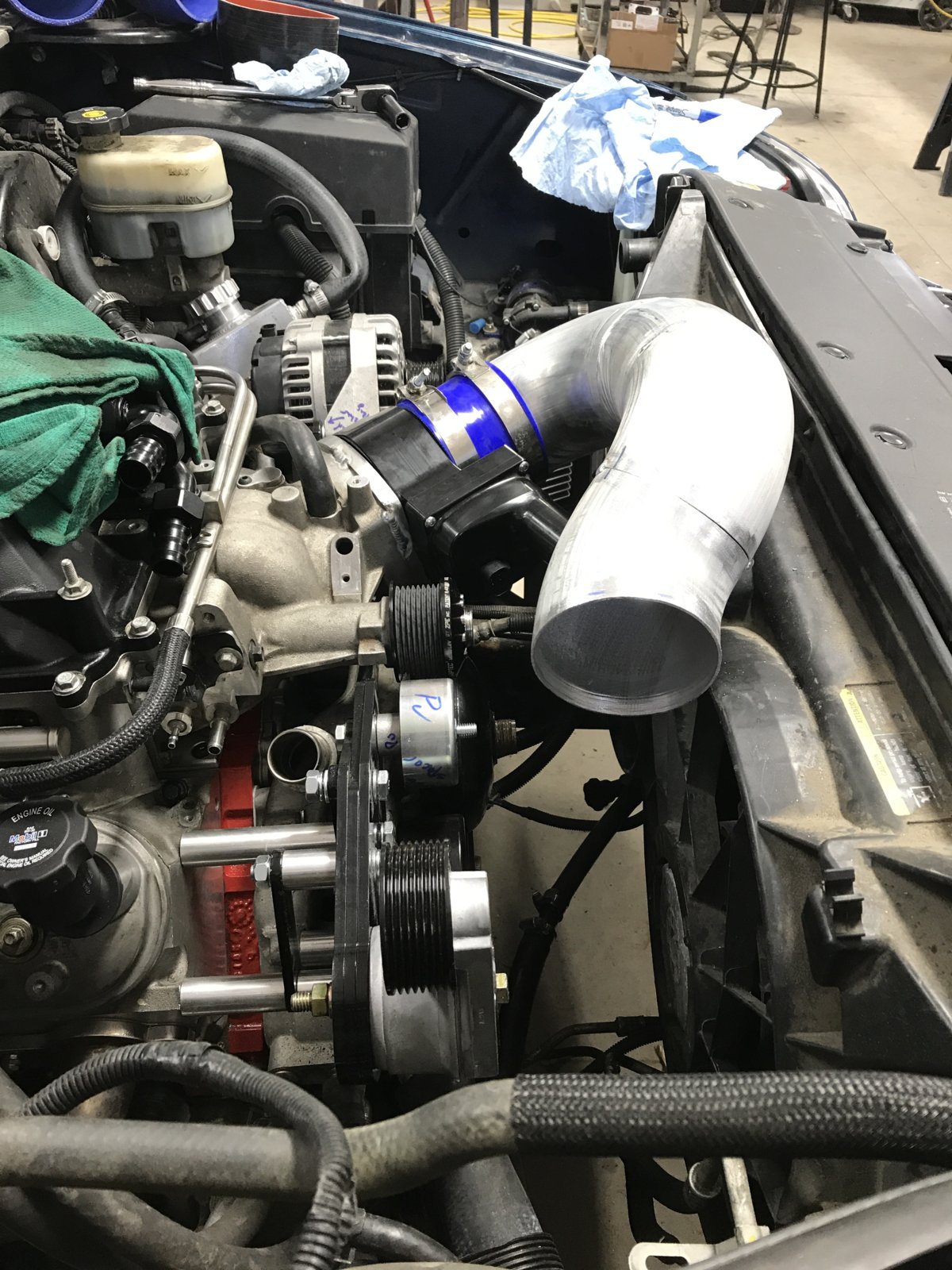

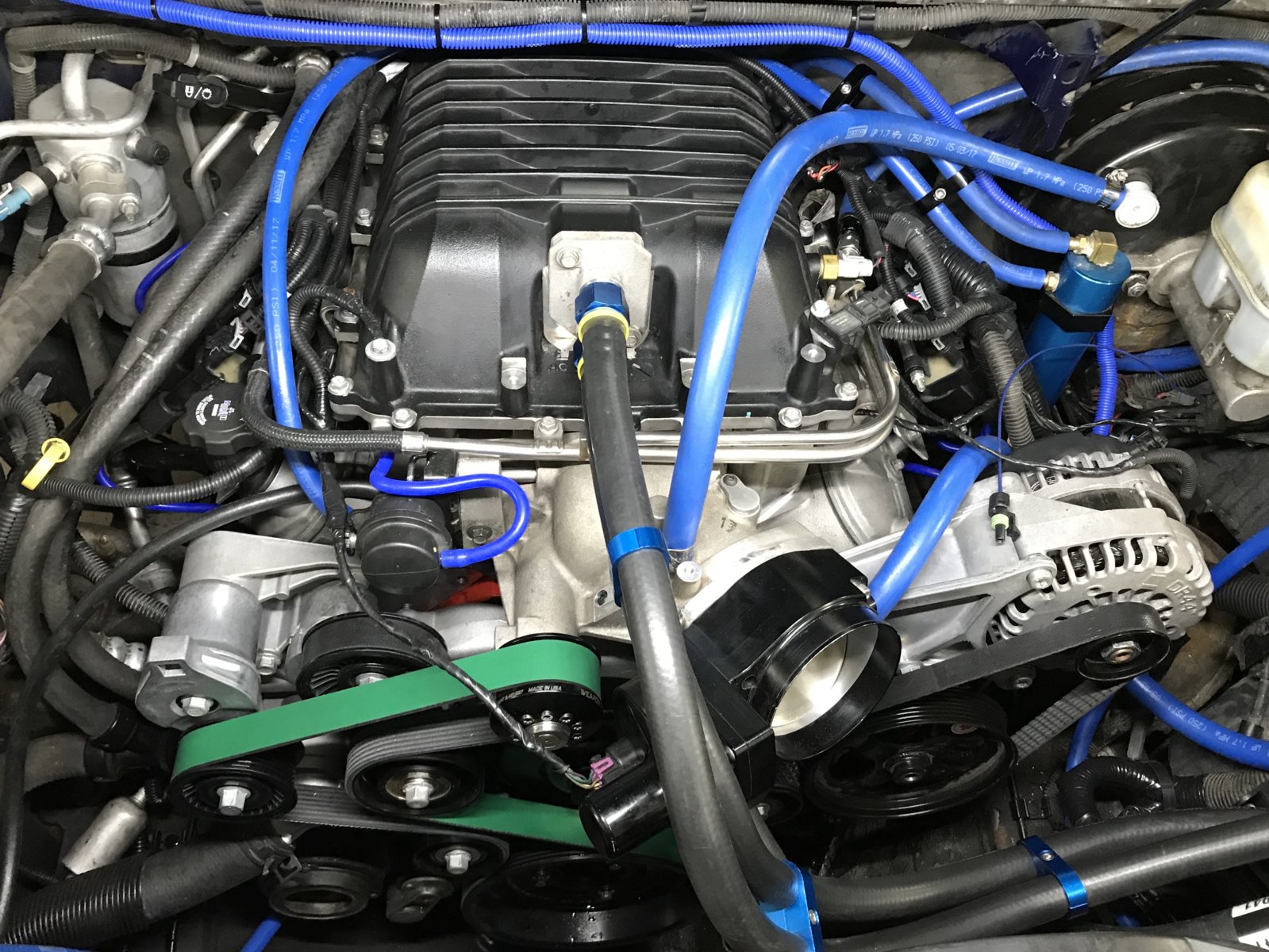

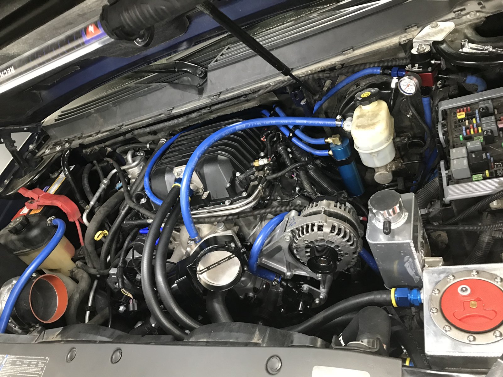

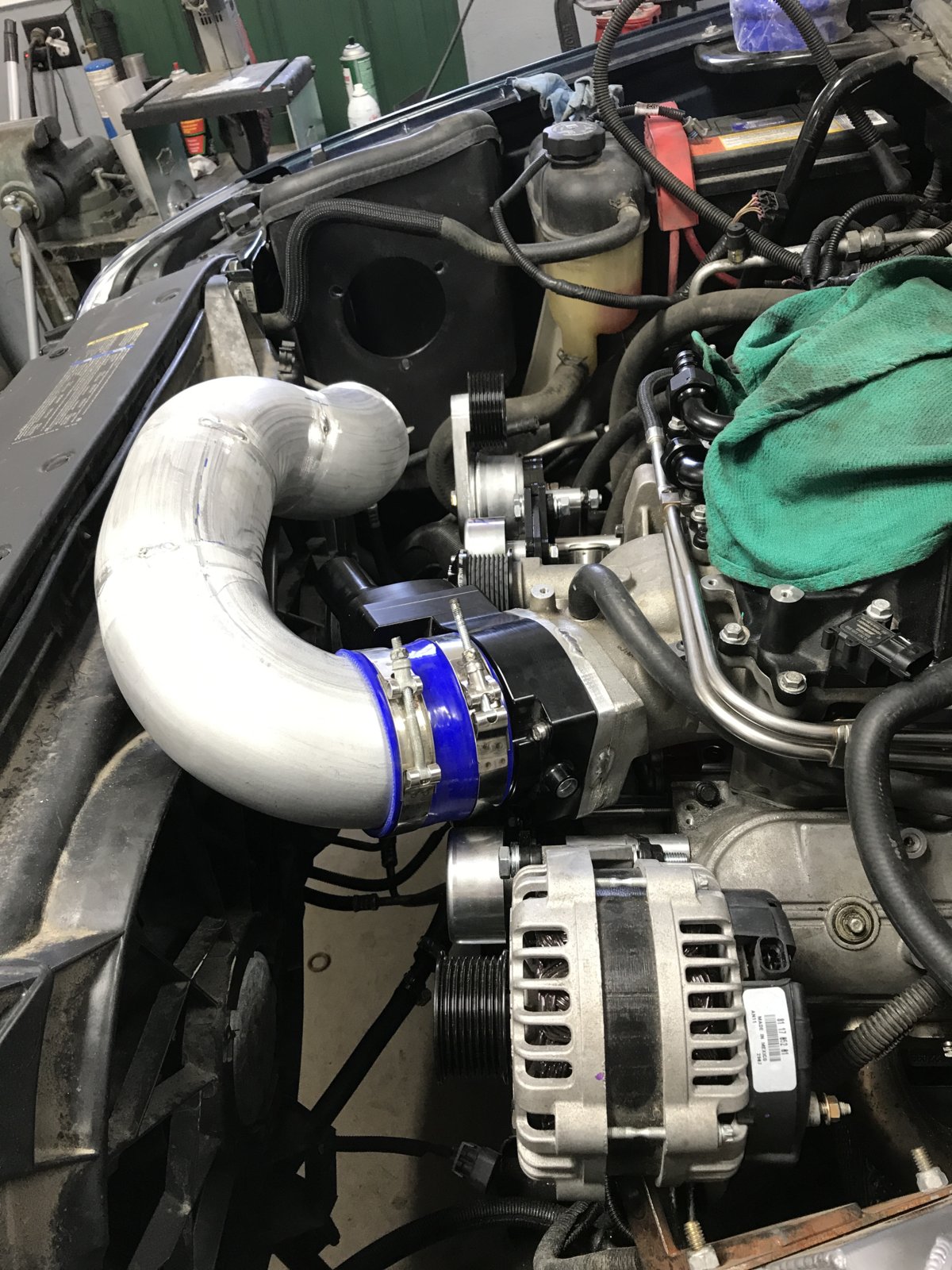

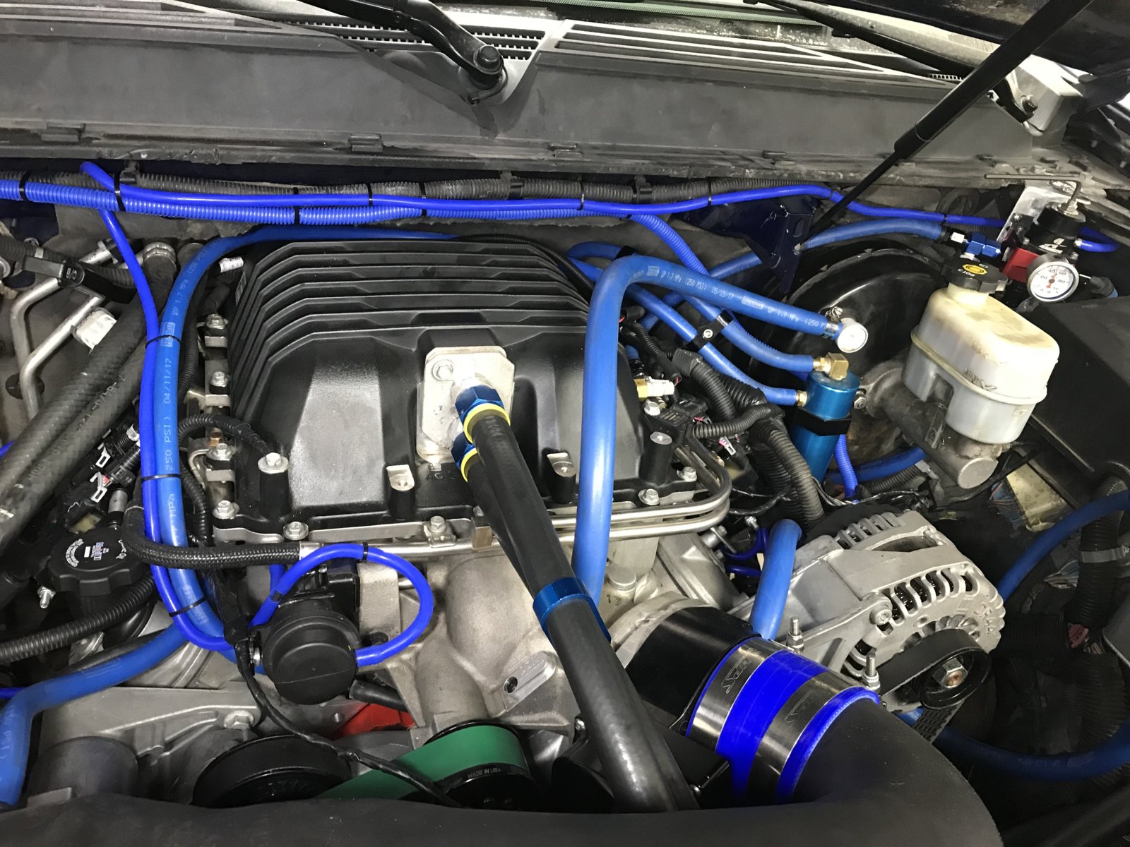

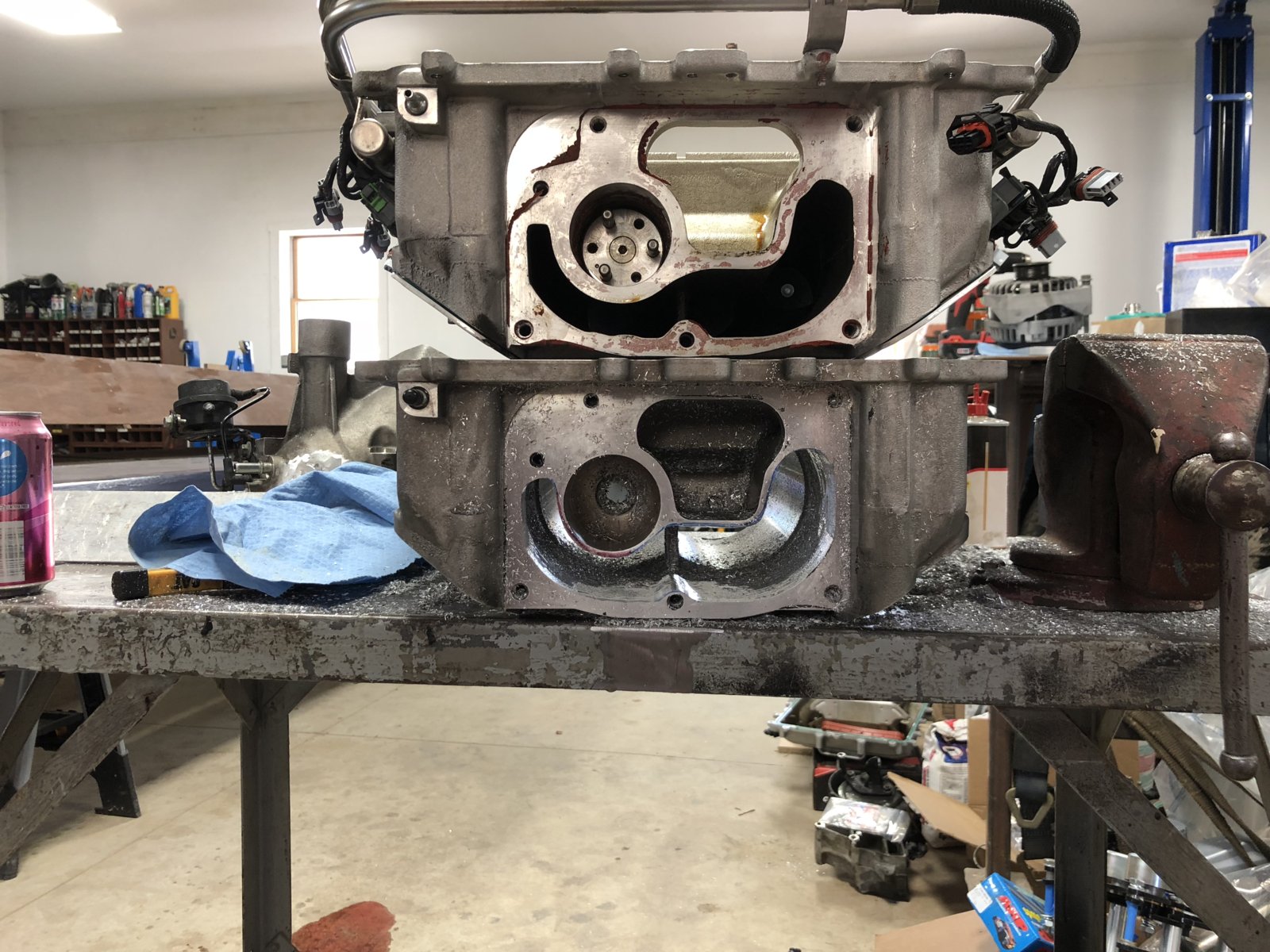

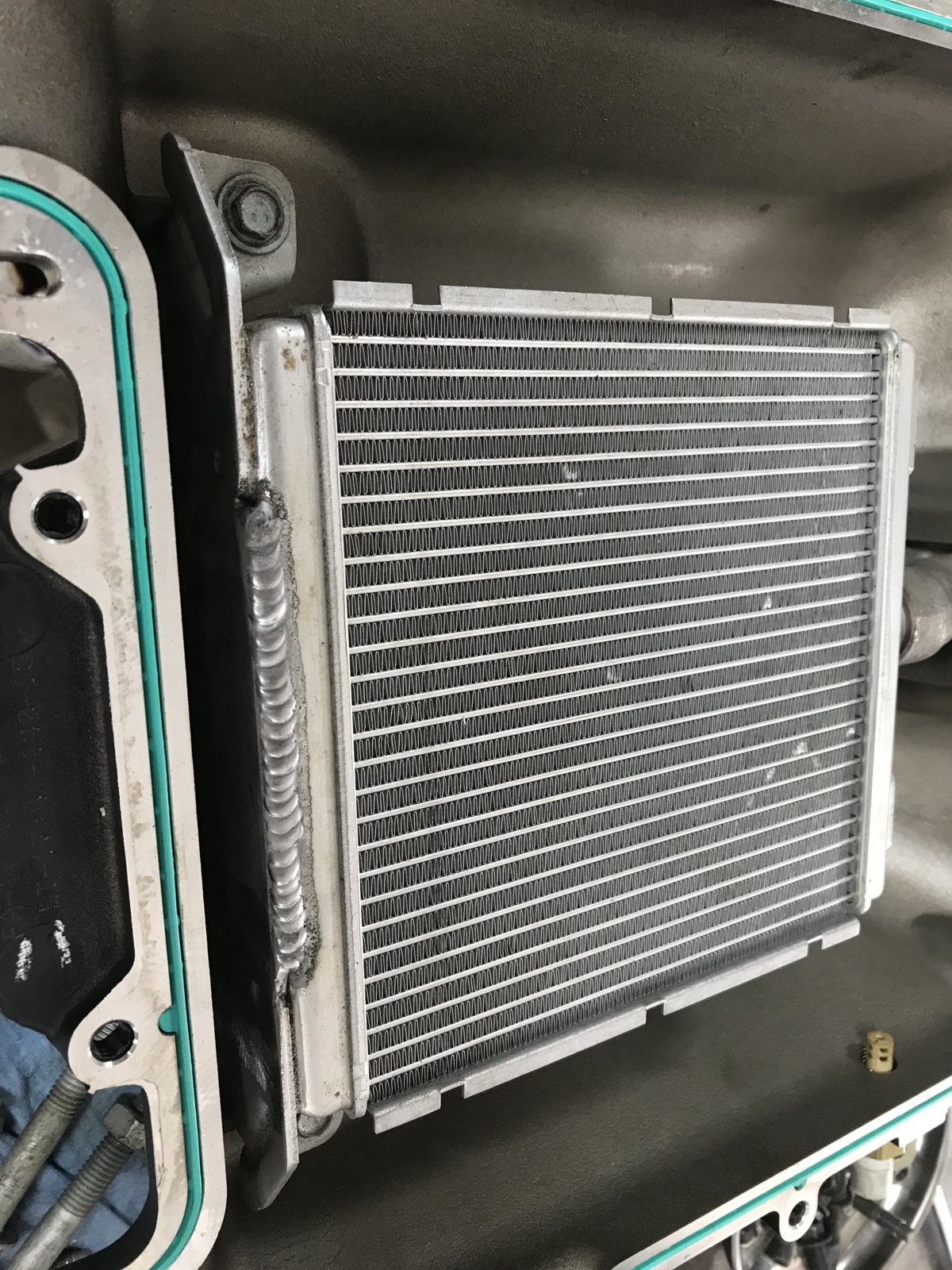

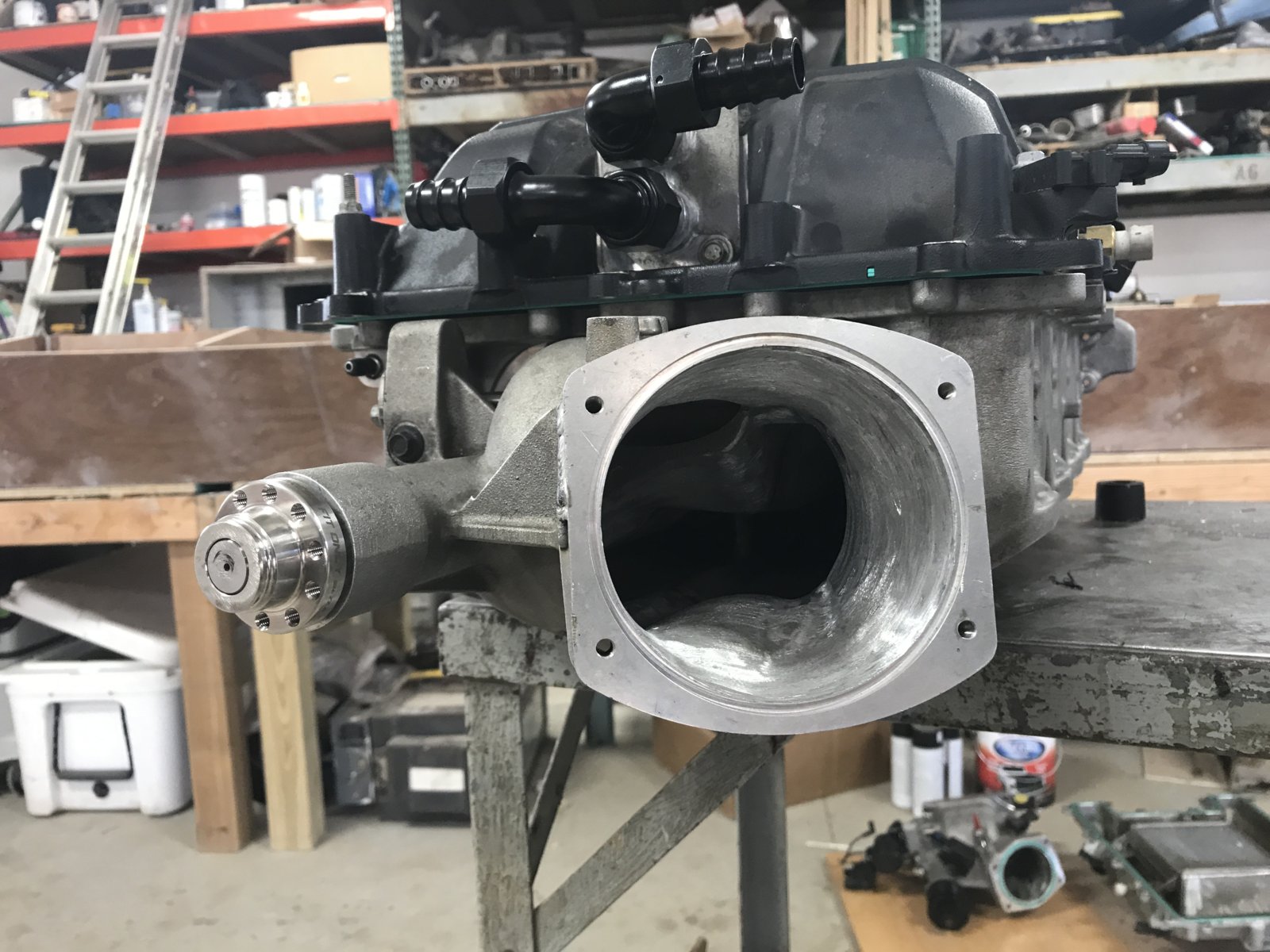

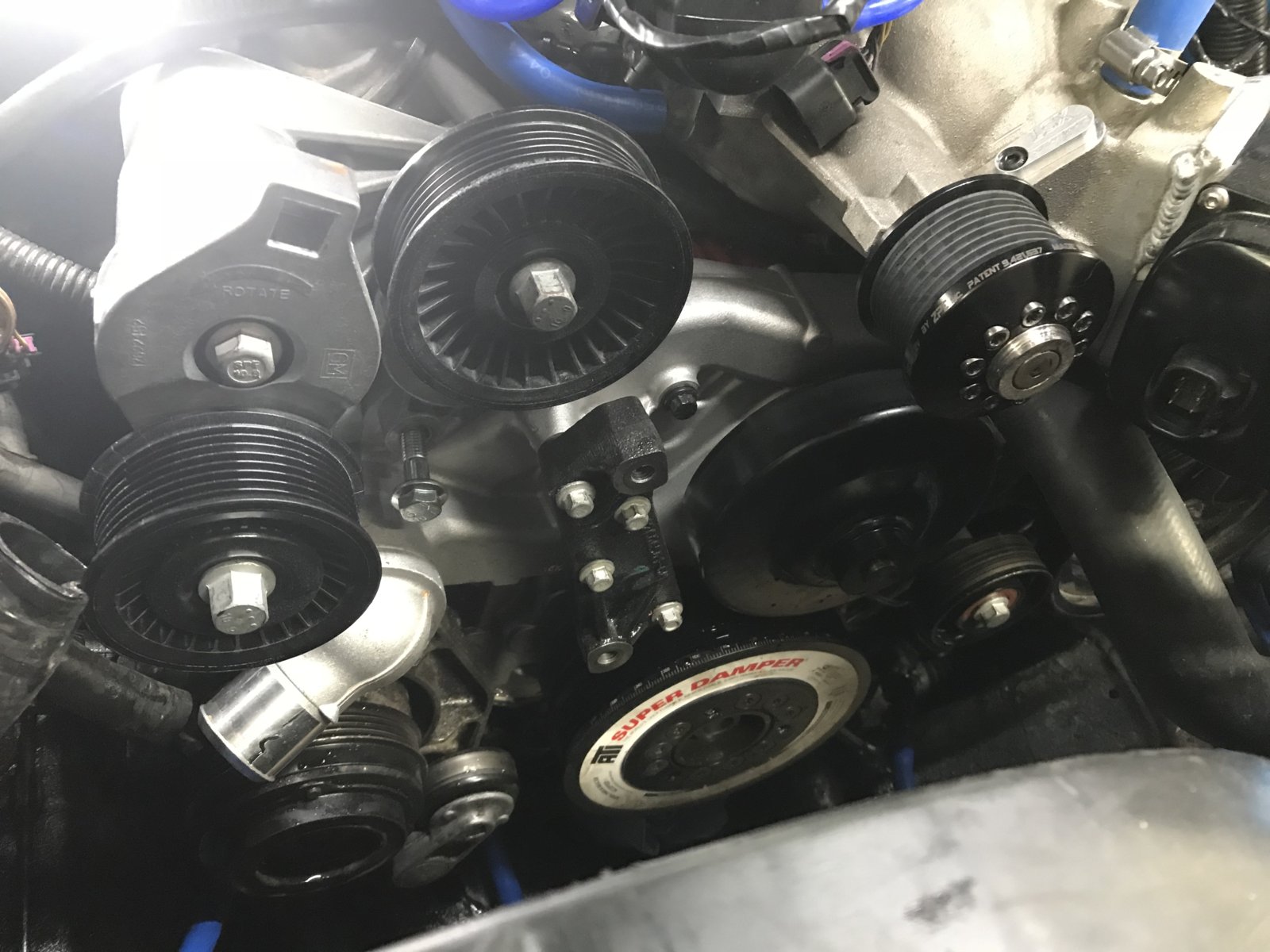

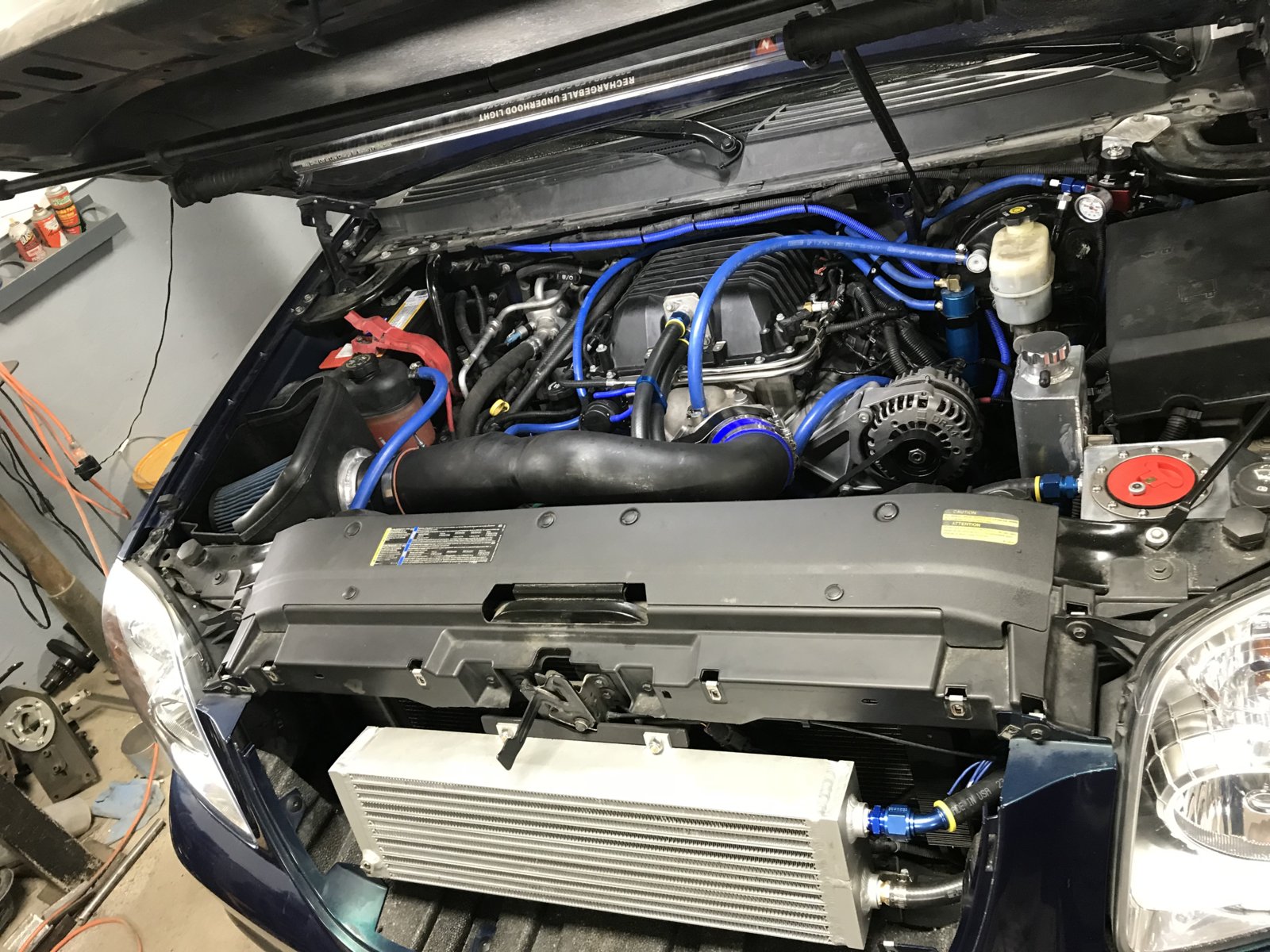

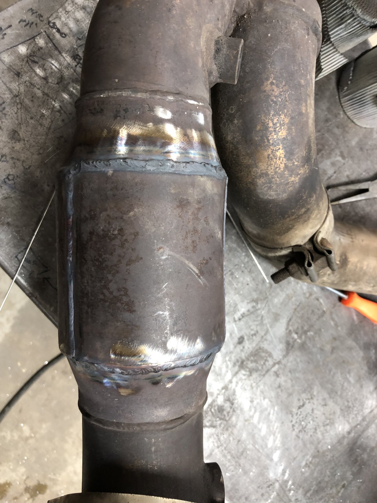

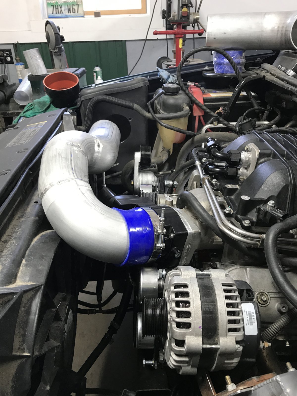

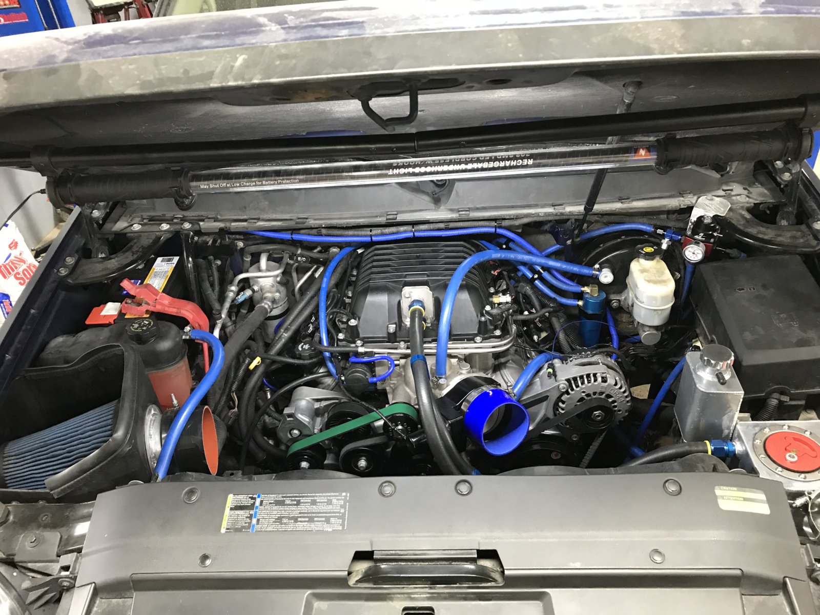

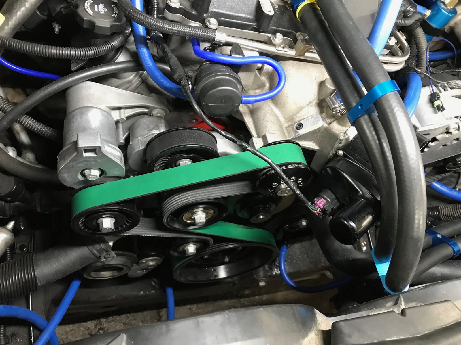

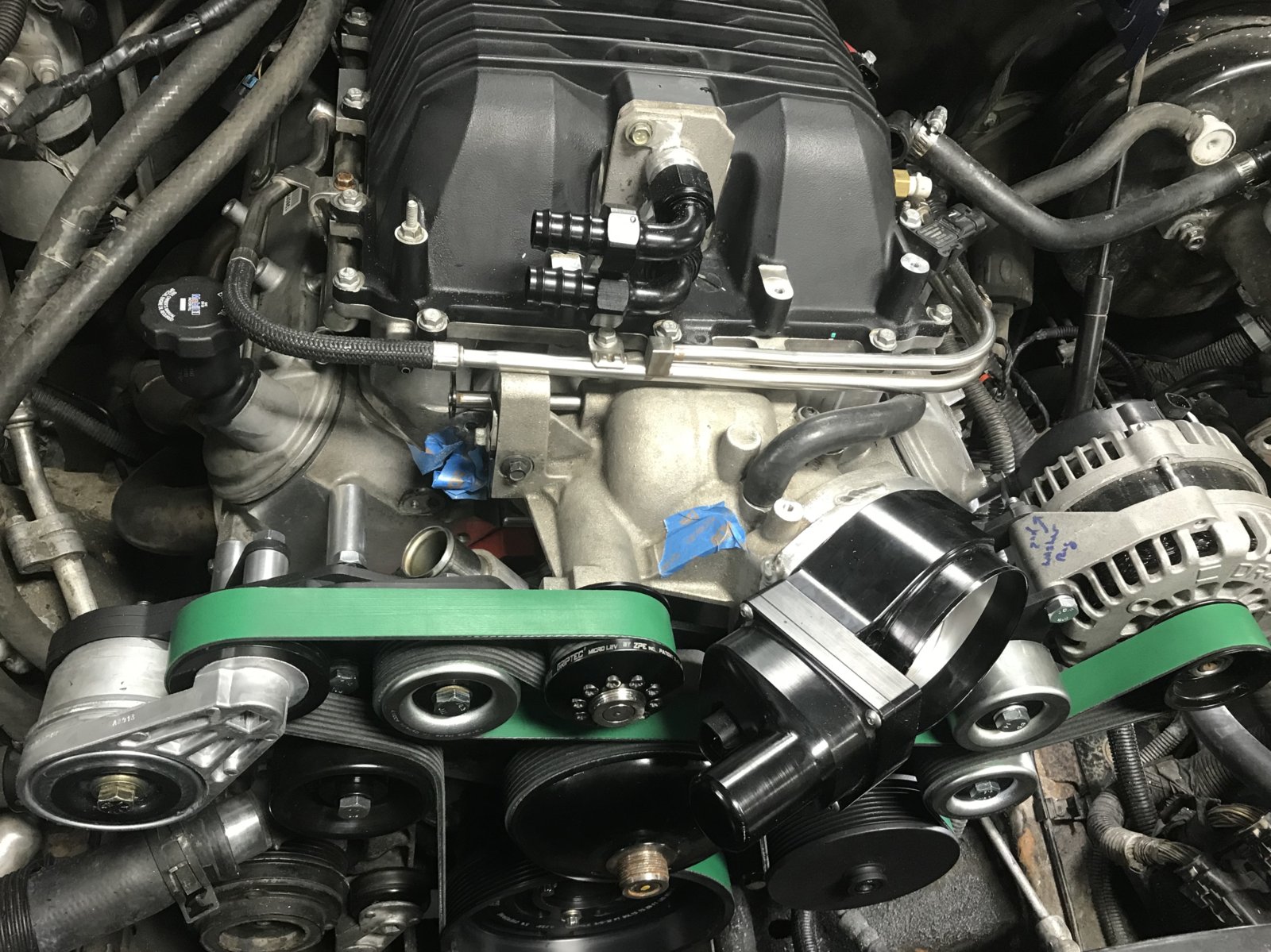

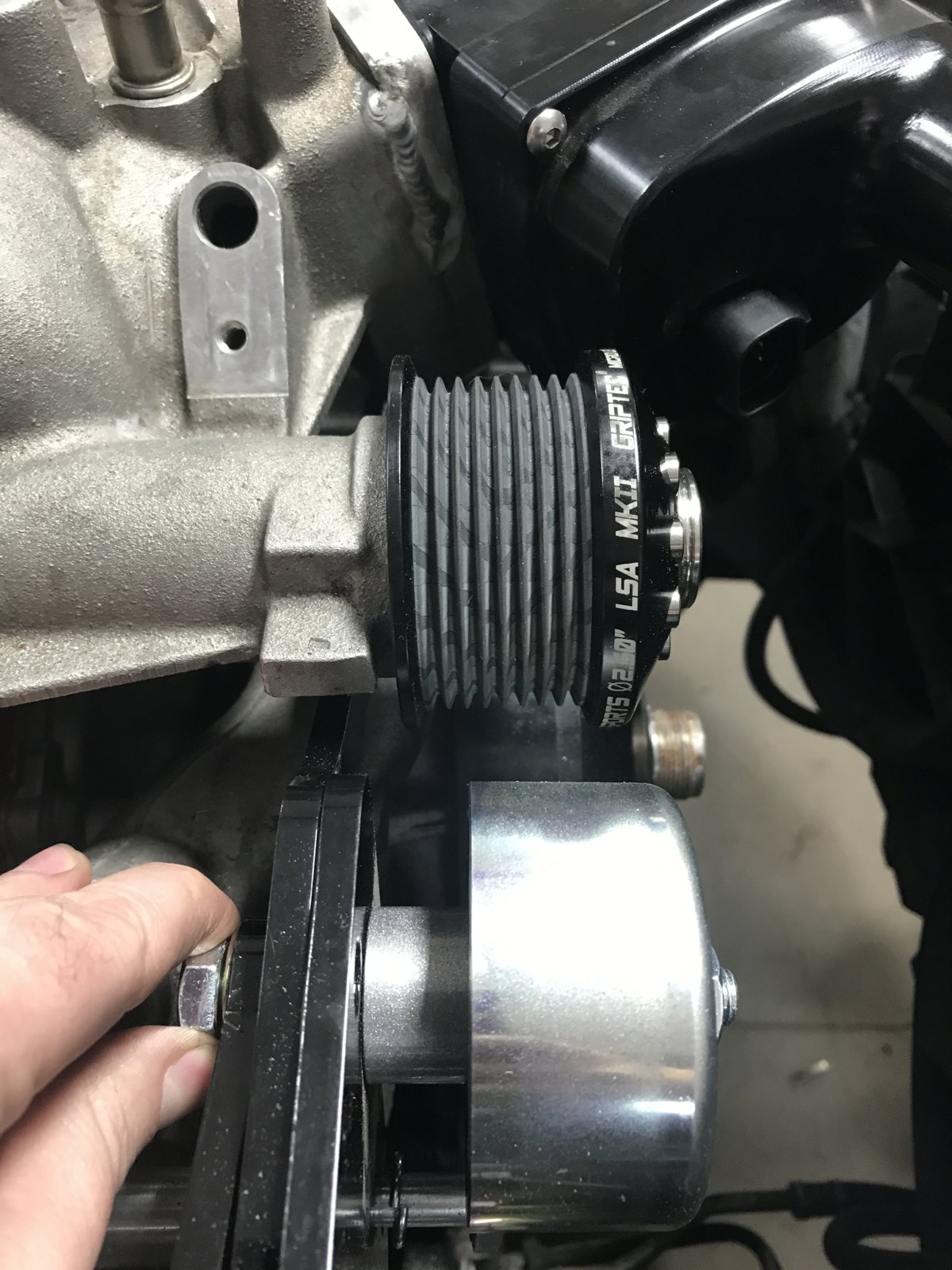

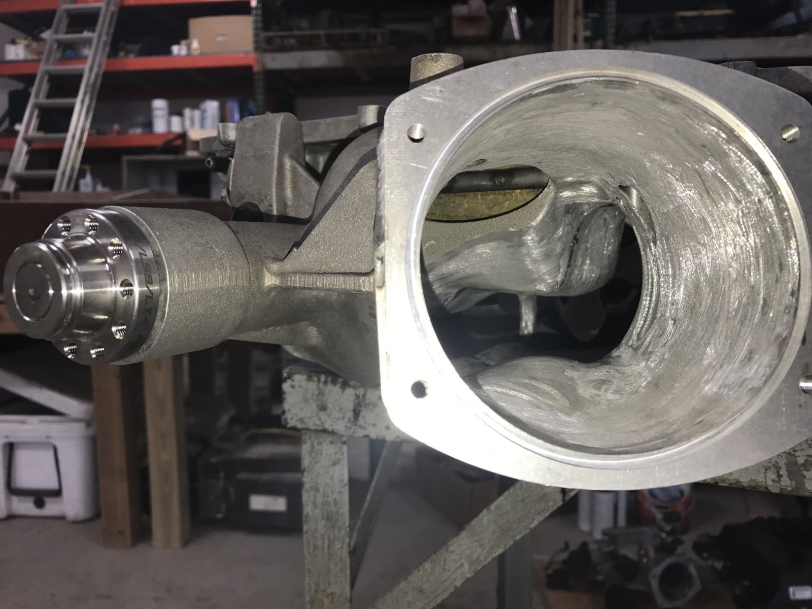

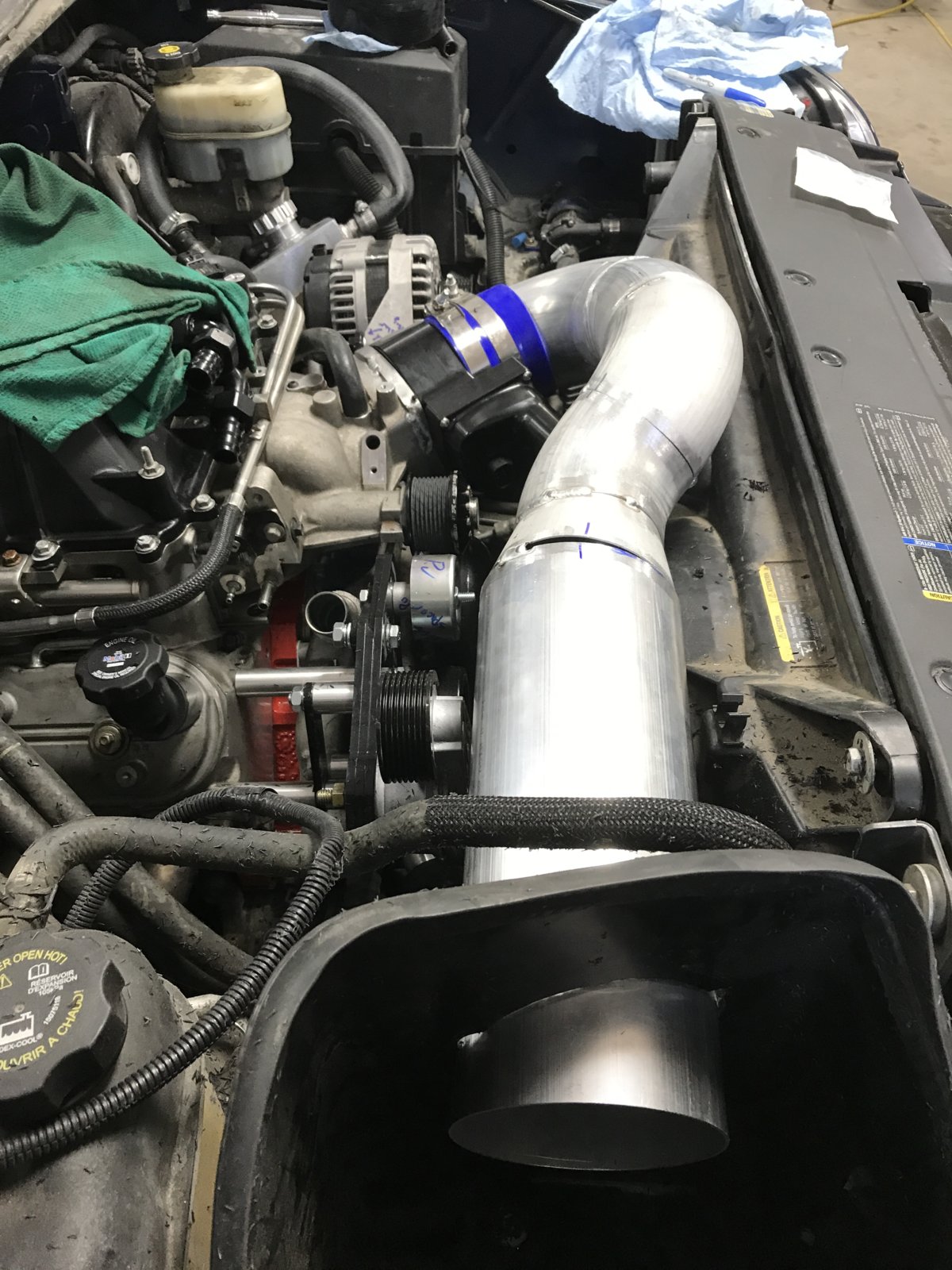

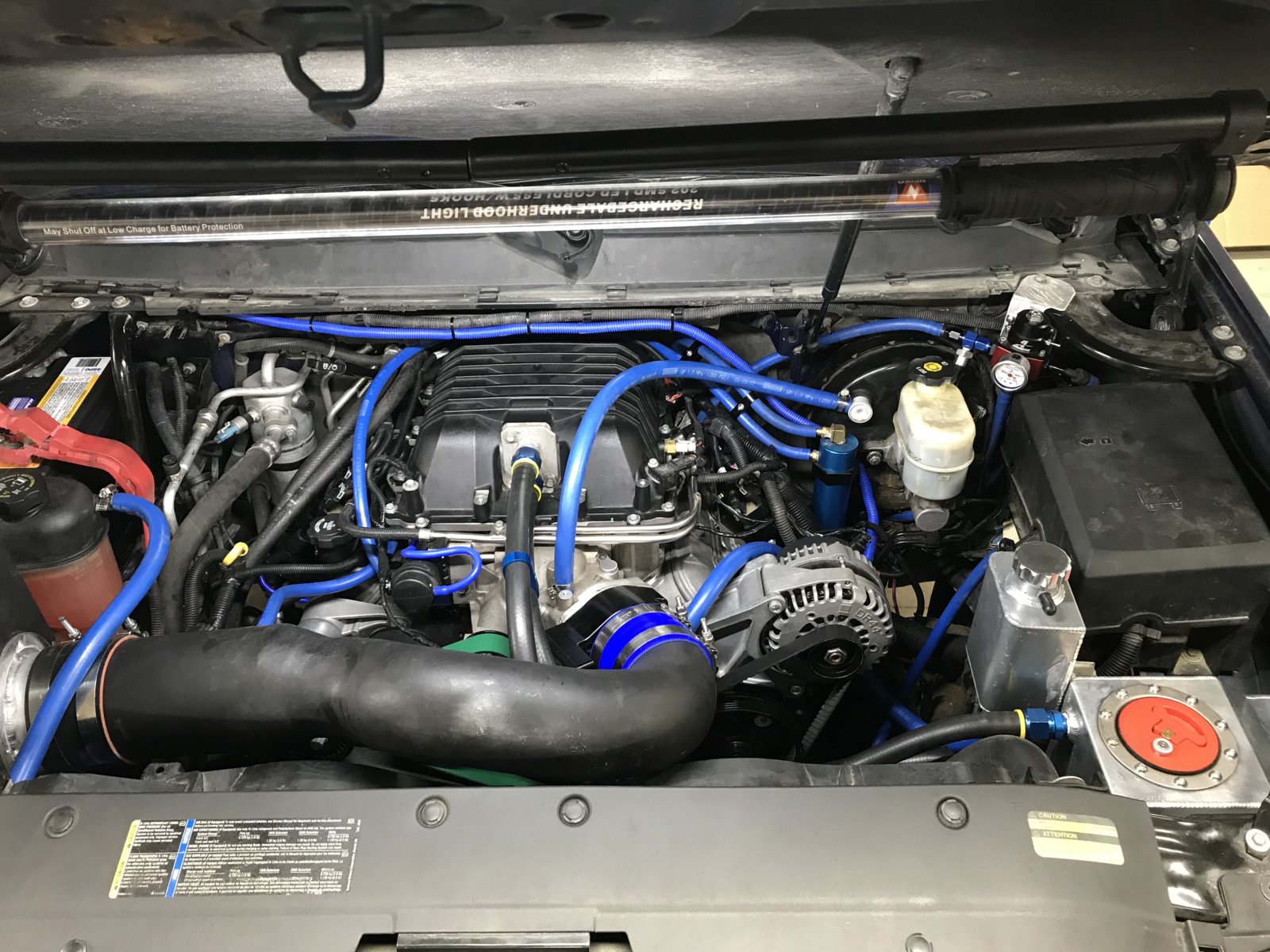

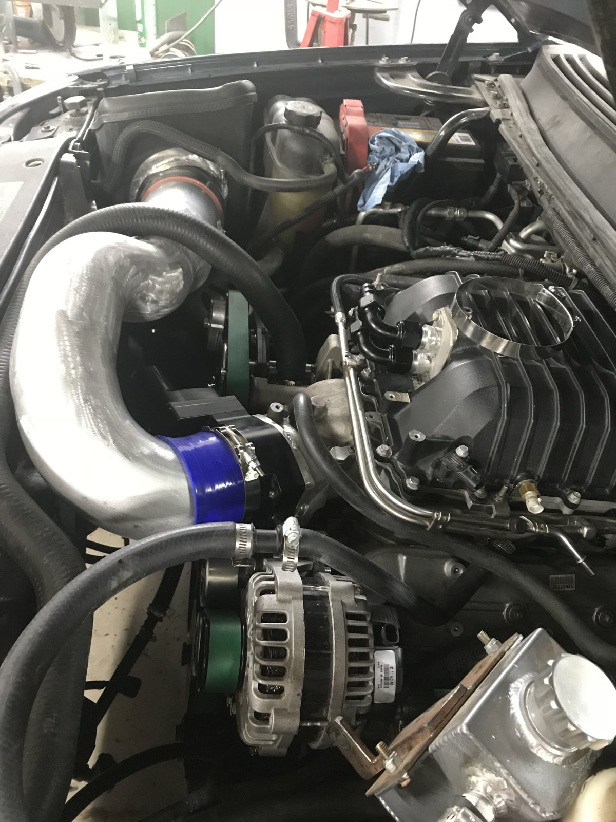

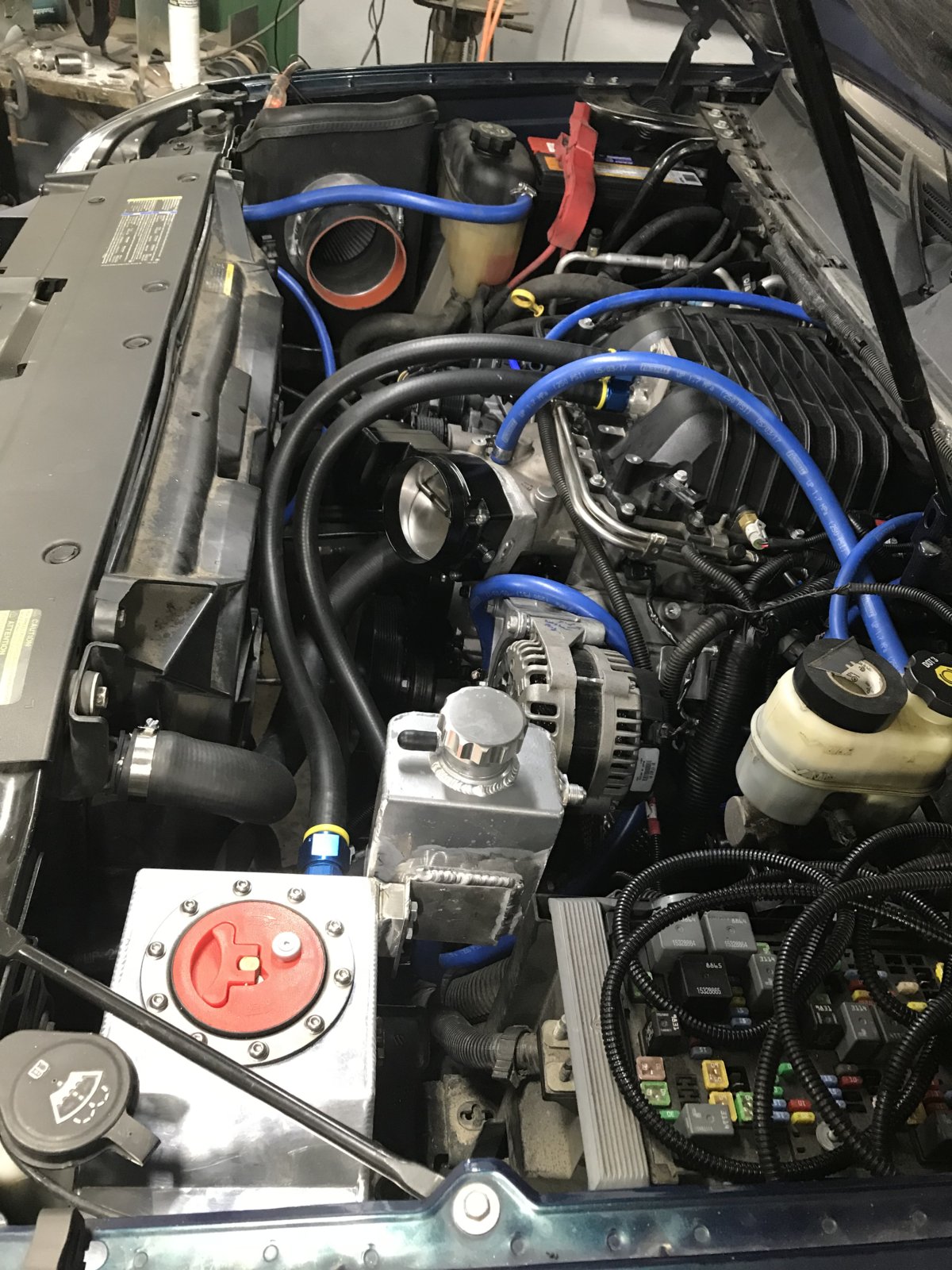

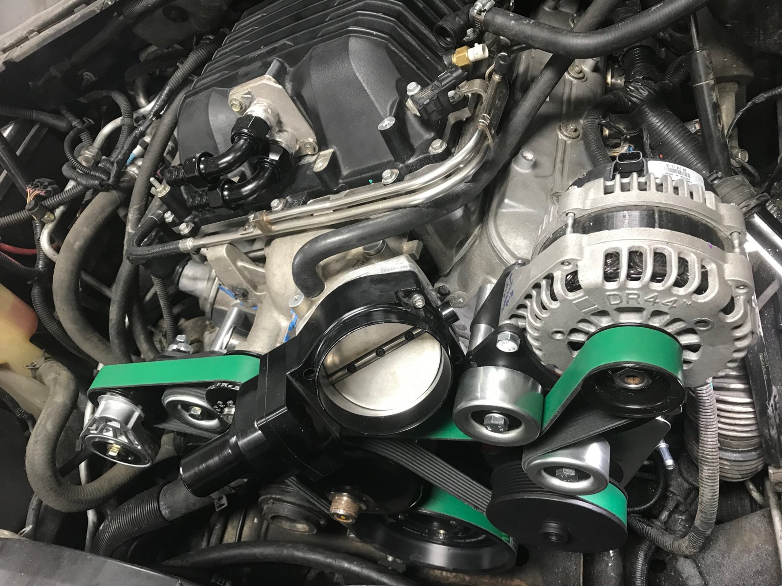

Thursday I was able to get both heads back on with the +.060" Cometic gaskets and ARP bolts torqued, also received my new comp pushrods so I also got the new lifters and rockers in. We were even able to get the LSA installed but I didn't have time to take pics. Getting back at it at 8am on Friday. Here are a few teaser pics below, blower coming pics tomorrow. Headers and Y pipe already back on as well. Should have Muffler and SLP resonator delete installed and the belt drive all finished tomorrow. Had some alignment issues with the idler pulley bracket so I might have to machine something. Will see how the alternator lines up in the AM... Stay tuned!
