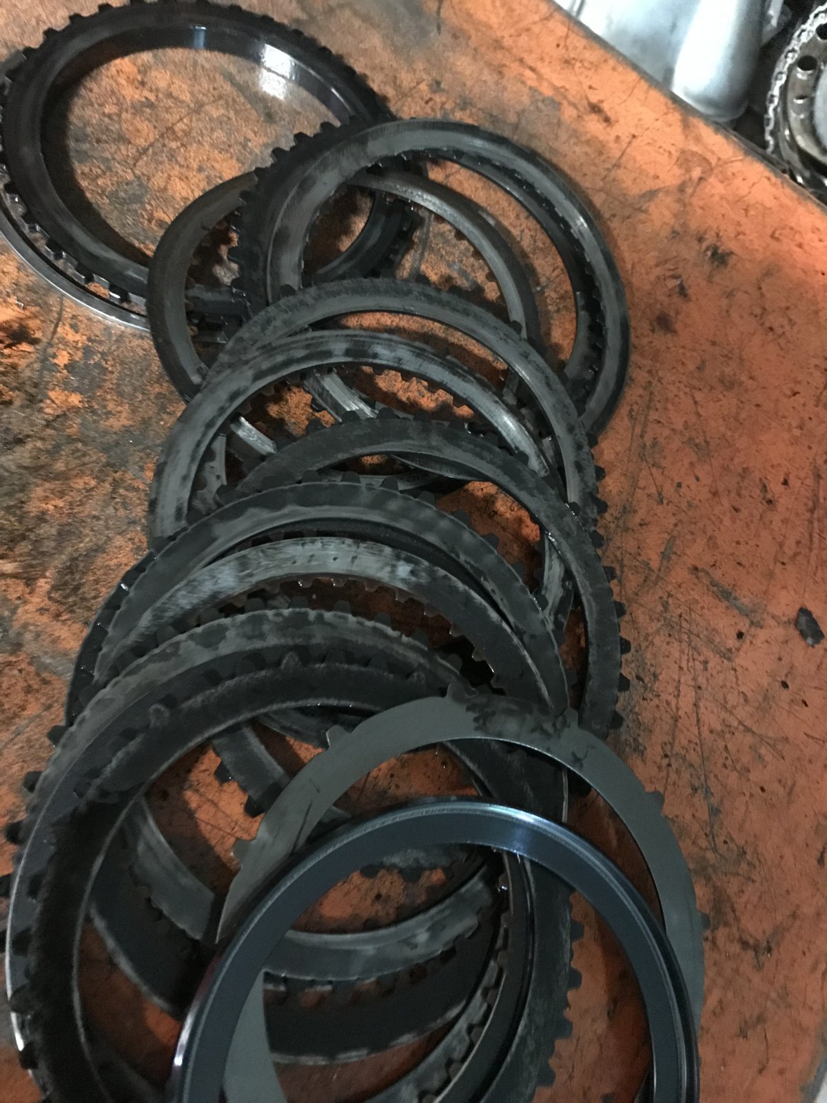

The plan wasn't to have the truck down for weeks at a time and this was my DD as well (have a 01 Jeep with no A/C though I'v been driving). It was all for the better in the end however. The transmission rebuild took 2.5 weeks and should have taken 24hrs but what can you do, they guys mother and mother-in-law passed away. Because of the delay with my wrong Y pipes, I decided to do a check of my cylinder heads and as mentioned in my previous post, found the drivers side head was barely torqued and was about to throw a head gasket. The added time to machine my heads and upgrading a few components there was well worth the extra few days took to get parts and install. My other big delay was with my friend/fabricator just busy and up north for most of June. I also did get the blower installed and tuned in about 2 - 3 days, could have been done in a day but I chose not to rush it. I was delayed ANOTHER day yesterday because the transmission was rebuilt, the TECM needed to be reprogrammed. I thought HP Tuners was capable but apparently only a dealer with a special Tech II like device (newer). I found a guy that should be here in the next 2 hours to do it and we should have it running and driving. I will post finish pics and videos, AWD burnouts coming very soon :chewie:

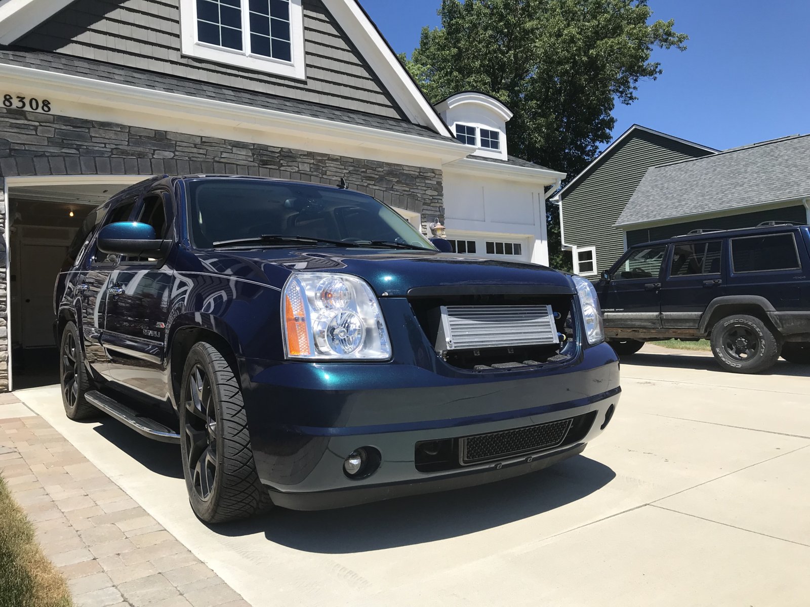

***Getting ready to fire this thing. Excited but very nervous as well lol
