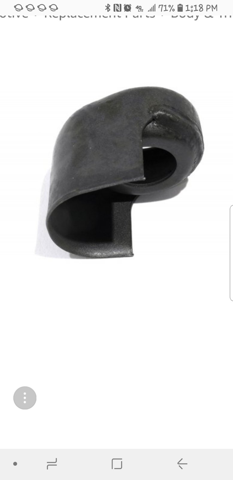

Did you install that deflector too?Screenshot_20190304-131858_Samsung Internet.jpg
https://www.amazon.com/General-Moto...XW7JJF4VAGZ&psc=1&refRID=M2CW0KYYFXW7JJF4VAGZ

No, I did NOT install the deflector. Missed that.
As for oil pump. I thought about that too; however, sufficient researched proved that would be too much for me to tackle. I didn't have the right tools to remove crank wheel properly and removing most of the front end components was just more than I was prepared for. Also, I know oil pumps can fail but I don't see reports of that many completely going bad.
