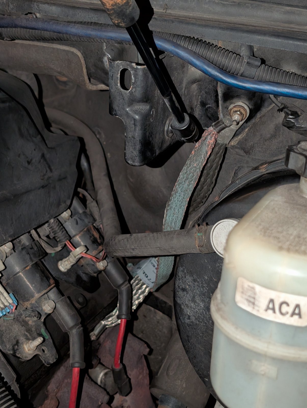

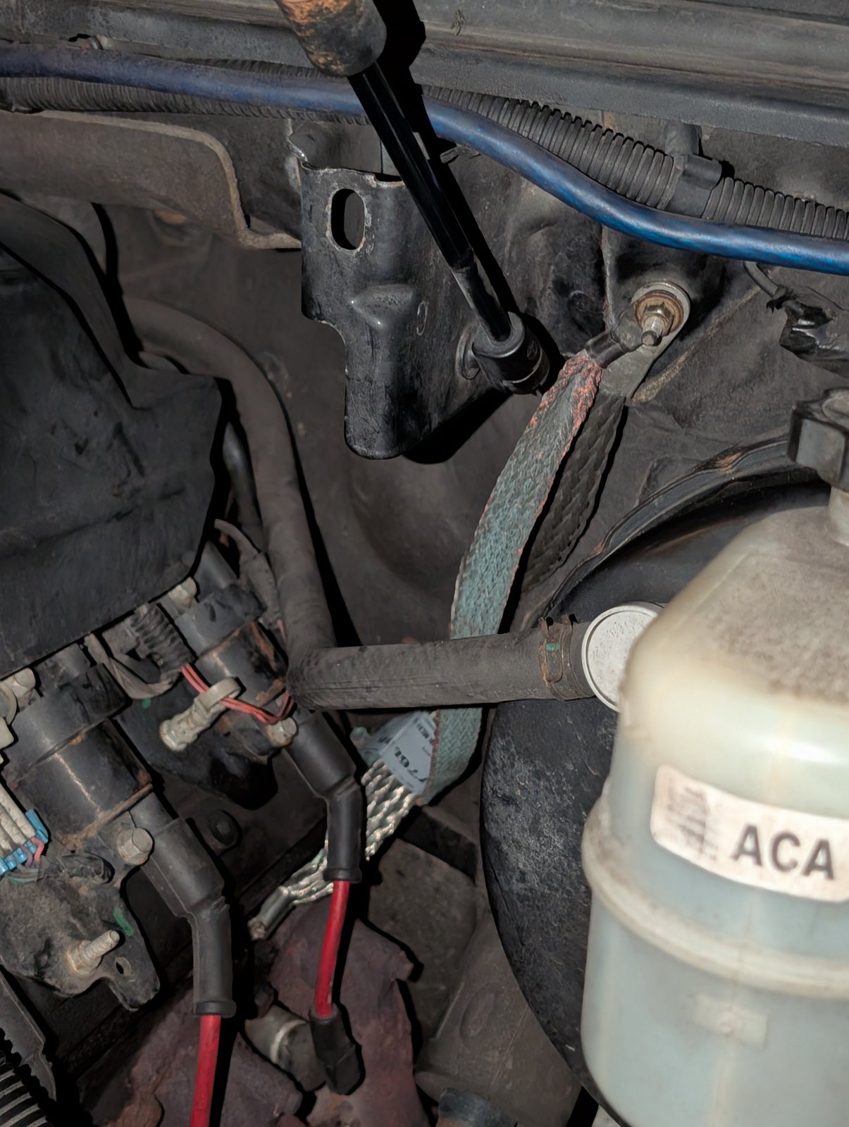

Here's a video. Also I found a voltage drop! Hooking up one lead to the starter casing and the other end on the battery negative I get what you see in the video. Looks like massive voltage drop. Problem is, i'm not sure where to go from here because testing with one lead on battery negative and the other on the ground that's on the engine that comes from the battery, there's no drop. As far as I know that's the ground the starter/block uses because i'm not seeing anything else. Other than the strap going from the back of the head to the firewall on drivers side which is new. Unless i'm missing one. I know the 5.3 has one hiding behind the PS Pump but the 6.2 doesn't so not sure where to go from here.
