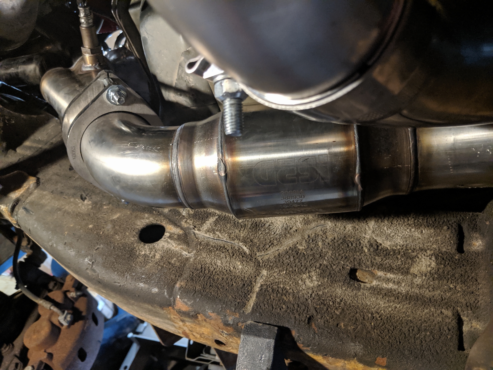

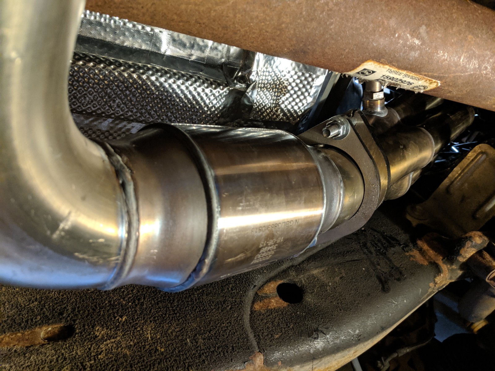

I tried to fit the piping to tie the headers to muffler portion of the exhaust. I need to drop the transmission cross member to do so. Next to the ypipe, the 2nd most hated thing for me is dropping a cross member.
I suppose one could leave the headers unbolted to get it all done without dropping the cross member but that would be even more a pain in the ass to balance all that piping, headers, getting everything in place for gaskets, O2 sensors, and header bolts.
I did however get the passenger side header almost all done.
Slow progress. I have tomorrow night and Sat to get it done "hopefully".
Boring posts. I guess this thread is more of a journal for me. ;)

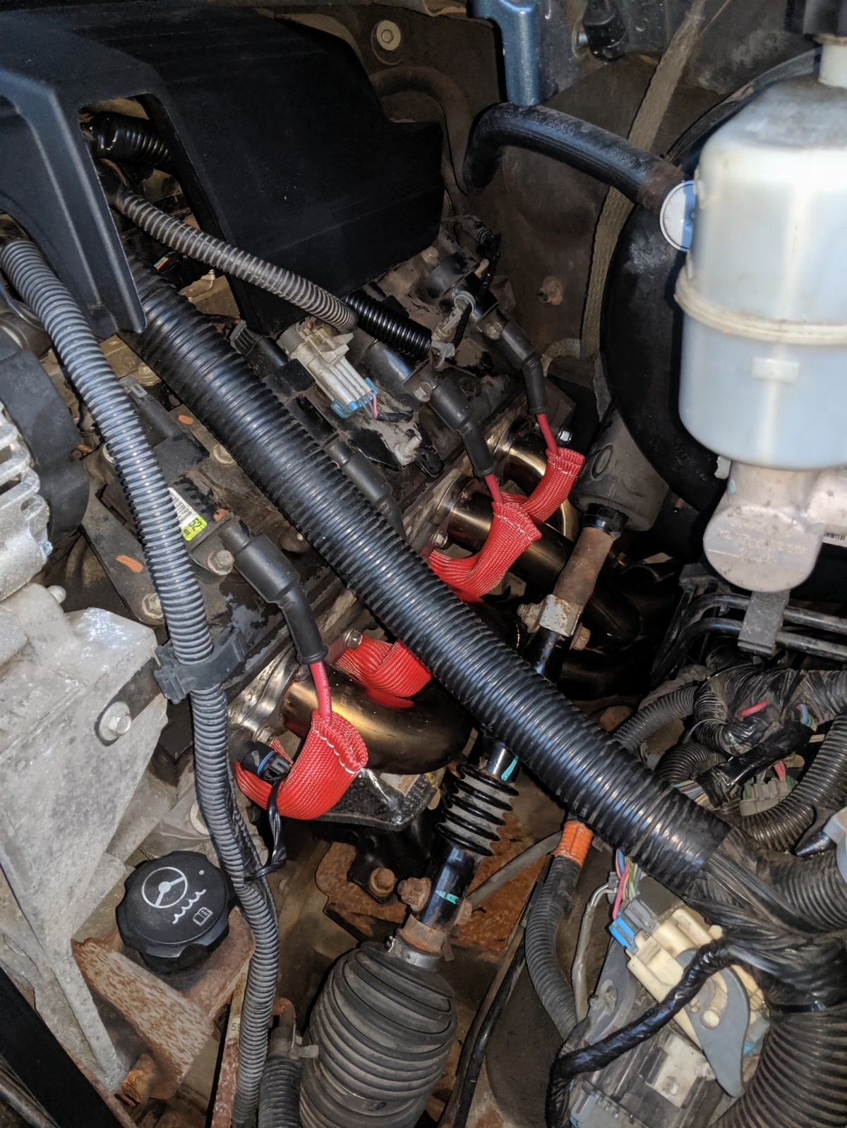

Question: I have 1 spark plug wire that touches the header no matter what I do. What do? Heat shielding? Custom short wire?
Spark plug is fully seated. I tested. 2nd from left.

I wrapped some aluminum foil around the touching spark plug wire.
Then I tested the engine with open headers. HOLY SHIT LOUD BATMAN!!

prob going to have to get a different set of wires, i had the fiberglass sleeves on mine and even with those it burnt through the cable inside them, msd makes a set that the boot can be formed and keeps them away pretty good, i got the set "for trucks" and they're long as shit i actually have the 45 off the coil pointed up on some of them.
driverside o2 sensor - make sure you tyrap the cable going to it up and tight, mine fell and rubbed thru on the front driveshaft

Aligned the headers and now the O2 sensor doesn't hut the body. It's close though.
Trimmed the wire boot.
Slips on snug
Fits ok. Used a zip tie to keep it from touching the header.
