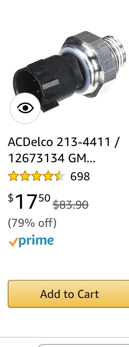

Look like 4 afm lifters and trays are around $300....man I'm torn right now...the solid lifters are as the say.."solid"? You blocked the oil to the solenoids with the collar under the oil pressure sensor?
