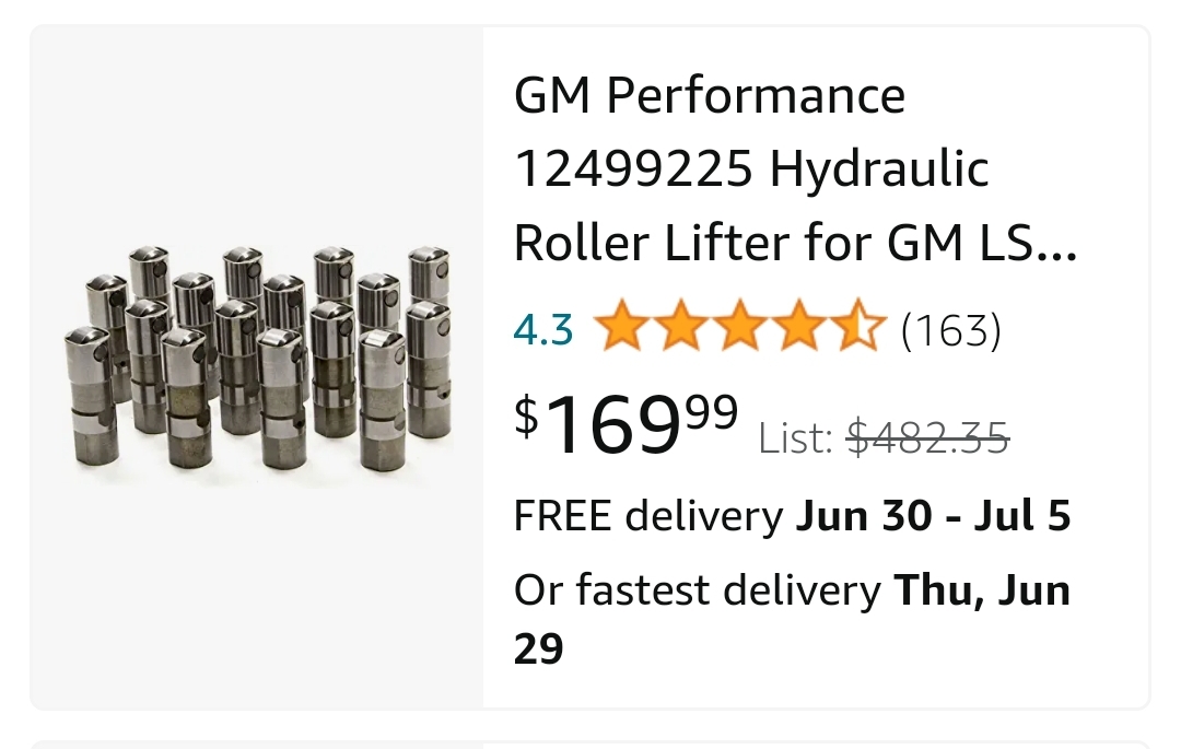

yeah I would only reuse the lifter because new ones are so expensive and if I did buy new afm lifters I'd want to turn it all back on.
