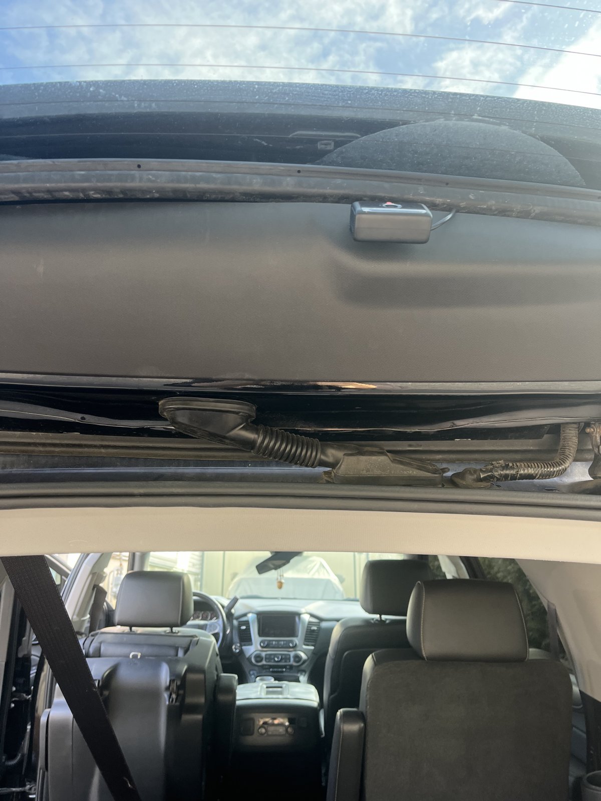

Using a Viofo a229 plus. Seems to work OK. Very similar packaging to mountie's Street Guardian. 50% screenshot below.
I mounted mine behind the passenger side of rearview mirror. So I can't operate it when I'm driving, but a passenger can.
I put it there so that it would not block my vision. Mainly use it as a parking security camera, so I don't really operate the unit.
I had my rear camera up high, but with my camera I was getting bad glare. So I mounted it at the bottom of the glass, which helped significantly.
There is a little loop so I can still open the liftglass, which is visible, but not much worse than the factory defroster wires.

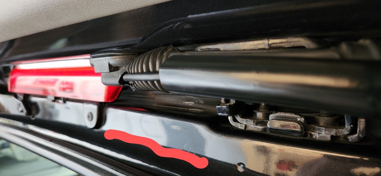

For the rear, I ran the cable through the existing wire harness to the glass, coming from under the vent cover.
  • from flex-rubber cover and under plastic hatch trim, to camera  (glass is raised).jpg

Don't know why I had bad glare with it up top.. Below is the only shot I have left from upper location. It was really distracting watching videos with glare.
I was able to get the miniusb connector through the factory flex rubber, then the cable loops so I can open the liftglass. I notice in the mornings, the area around the rear camera is defrosted!
Cable loop and camera through the rearview. Mirror cable cover wouldn't fit without modification. (I left it out) Camera about 25% visible from passenger side unless you lean forward and look upwards.
