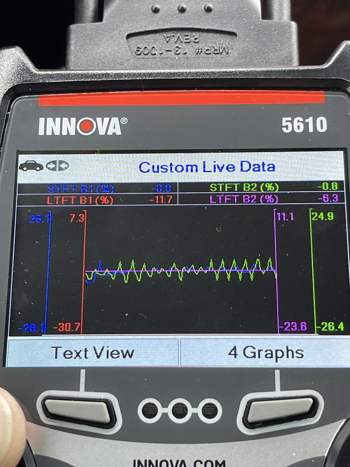

I was able to figure out how to graph some data. Here’s is the O2 difference after 20 minutes on road and parked at idle.

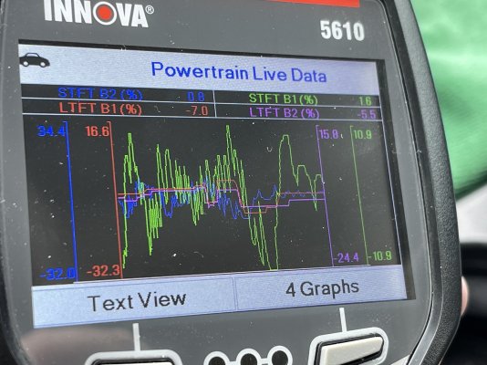

After drive here we’re the fuel trims

Did you try swapping the number 5 injector to another hole? Wonder if the injector is over fueling based on those fuel trims?
j91z28d1
Feb 28, 2022
3,783
4,664
that's removing a lot of fuel from bank one. you like the total to be around 5% long term + short term. you're at almost 20%.
now what's causing it, I don't know.
All the injectors, plugs, and wires were replaced, gave a rundown of all the usual suspects have been swapped then replaced and am down to wiring other than what has been shot or internal failures
Could it be not enough intake valve opening due to cam lobe and pulling fuel? We may find out. I am waiting on a noid light and may be out of other options to check
These things have kinda a noisey valve train at idle when not damaged. I'd be really surprised if you had valve train damage of some kind and it ran smooth and quiet.
but I'm also out of ideas. you'd done really good diagnostic at this point.
