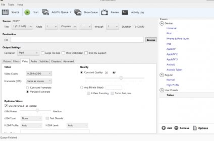

Here's another guide you might want to look over for handbrake.
http://www.gm-trucks.com/forums/topic/154240-playing-videos-on-mylink-intellilnk/page-5#entry1431310
My process is simple I backup the DVd with Any DVD then use handbrake to covert it to a mp4. The thing that had me stuck for hours was the format the SD card had to be in. I even use 1080 resolution when I covert to mp4 in hand break which many say doesn't work. Also i'm using the card reader in the rear of the truck. I'm also able to play 2 separate movies on the 2 rear screens oof the same SD card.
Later this evening I'll take a screen shoot of the properties of one of my backups. Then you can use all the same parameter in hand break. But remember I'm only using AnyDVD to backup my Bluerays movies.
