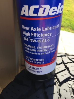

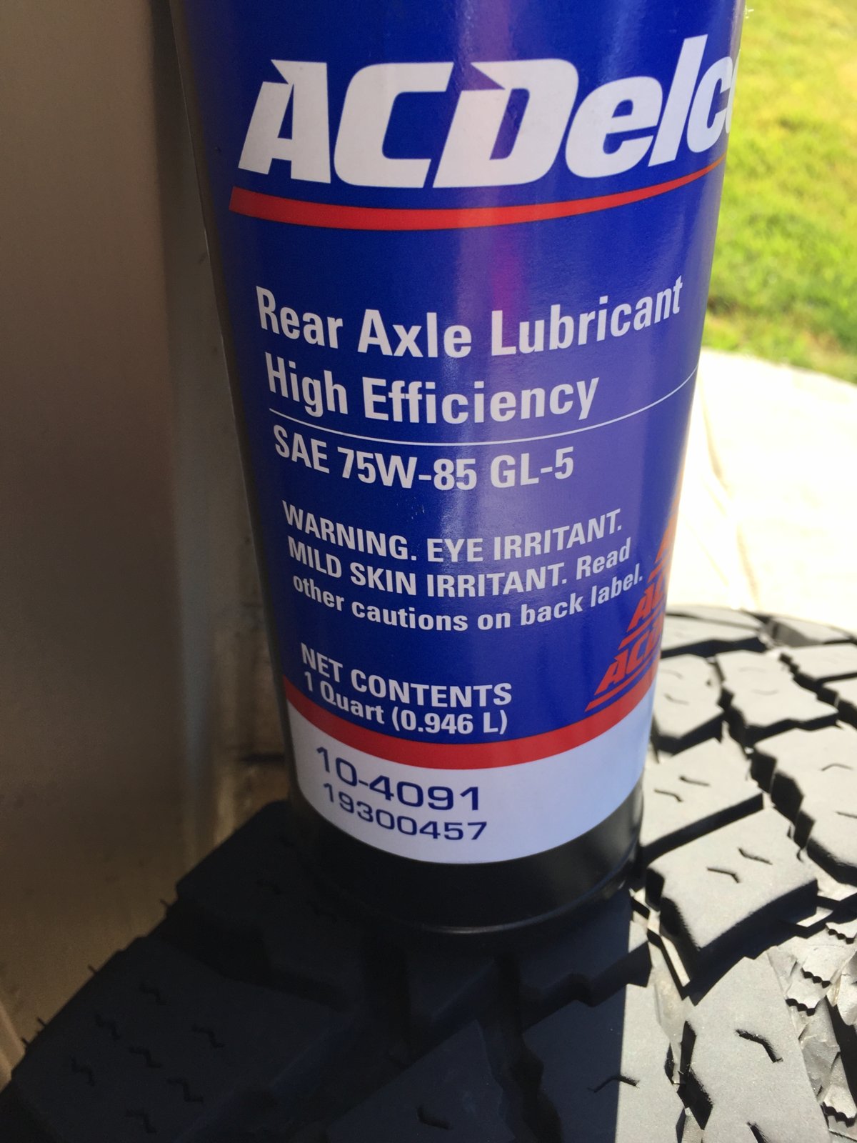

I've been looking around here regarding my rear diff fluid change. On my 16 Stingray and 13 Camaro, I simply remove the drain plug and then fill from the fill plug. No drain plug on 16 Tahoe RWD 3.08? Only a fill?
Pull the cover and let it all drain out, the gasket is reusable, then refill through the side plug or diff cover plug (whichever you have) to just below the opening or just over 2 quarts. The first time I did mine 2.15 quarts was put in, two months later had to do it again because of a leaky axle seal so only 2 quarts went in that time.
