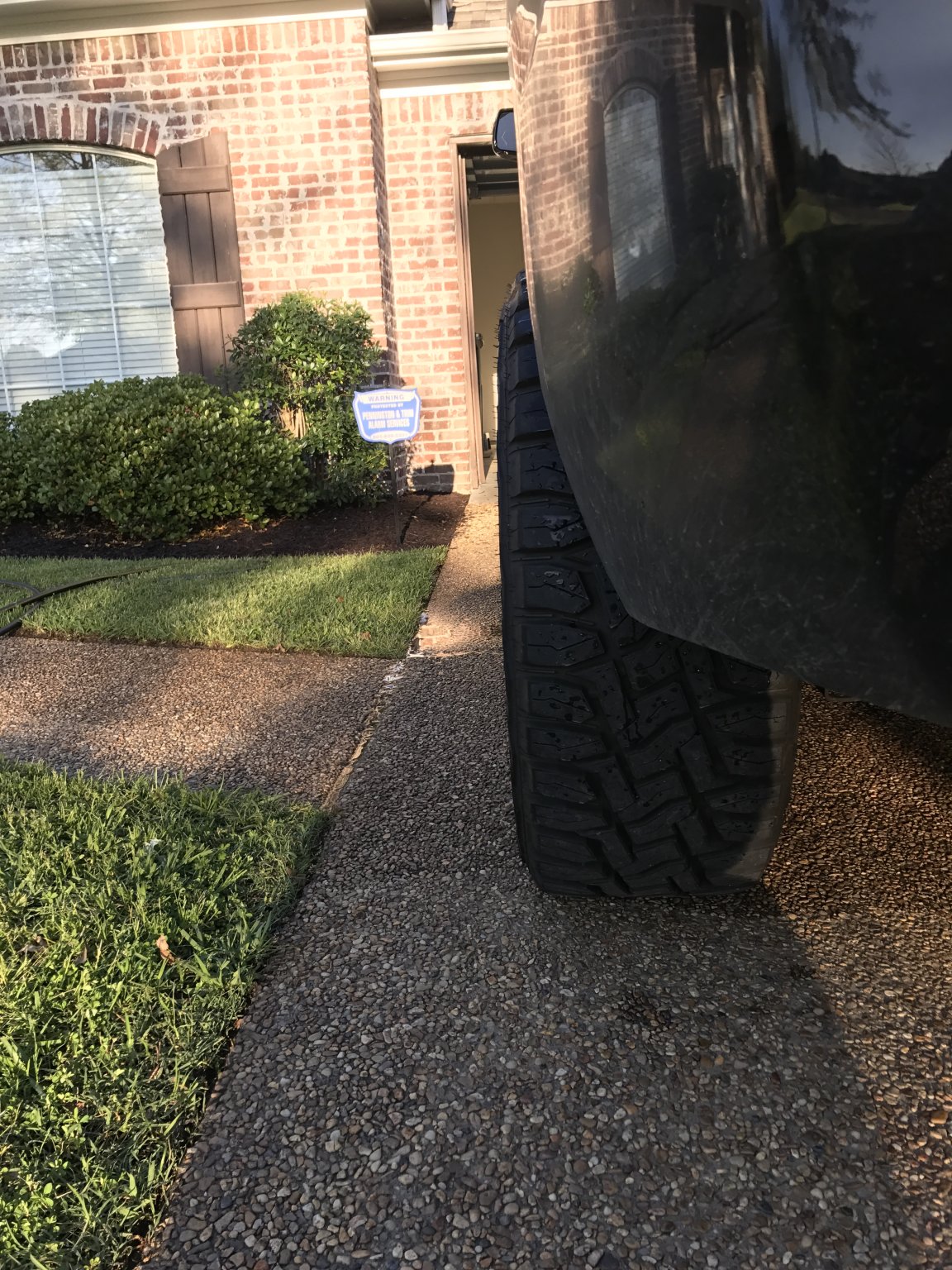

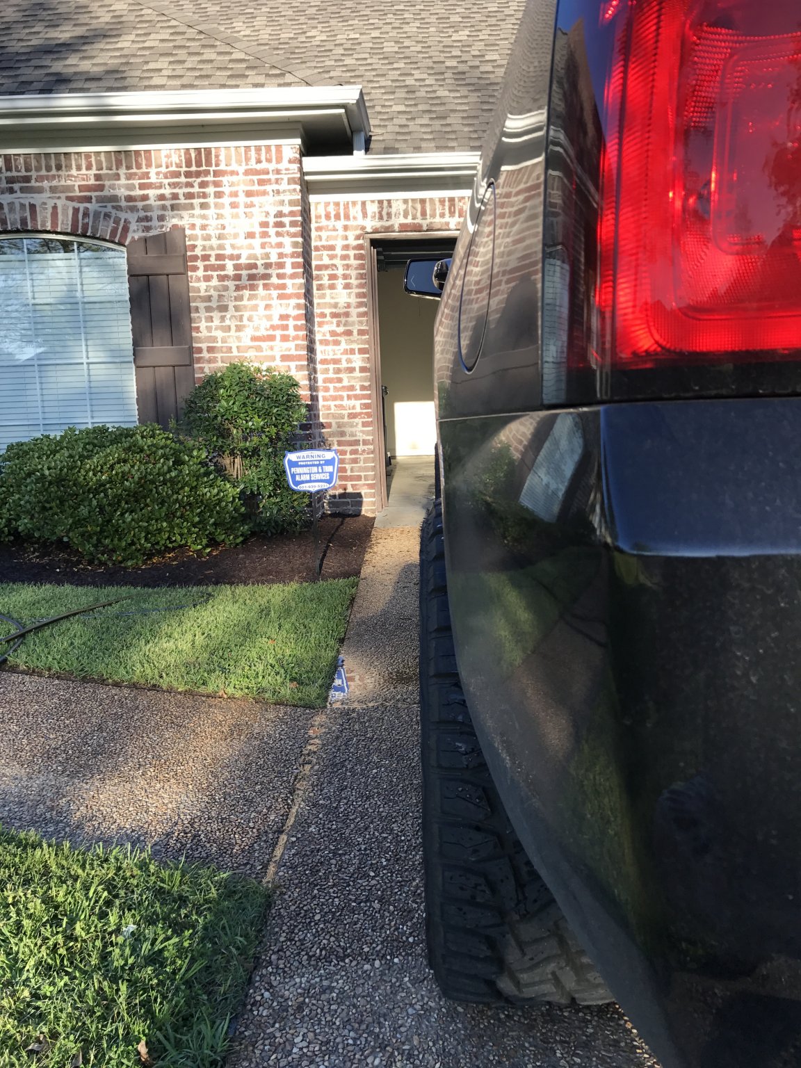

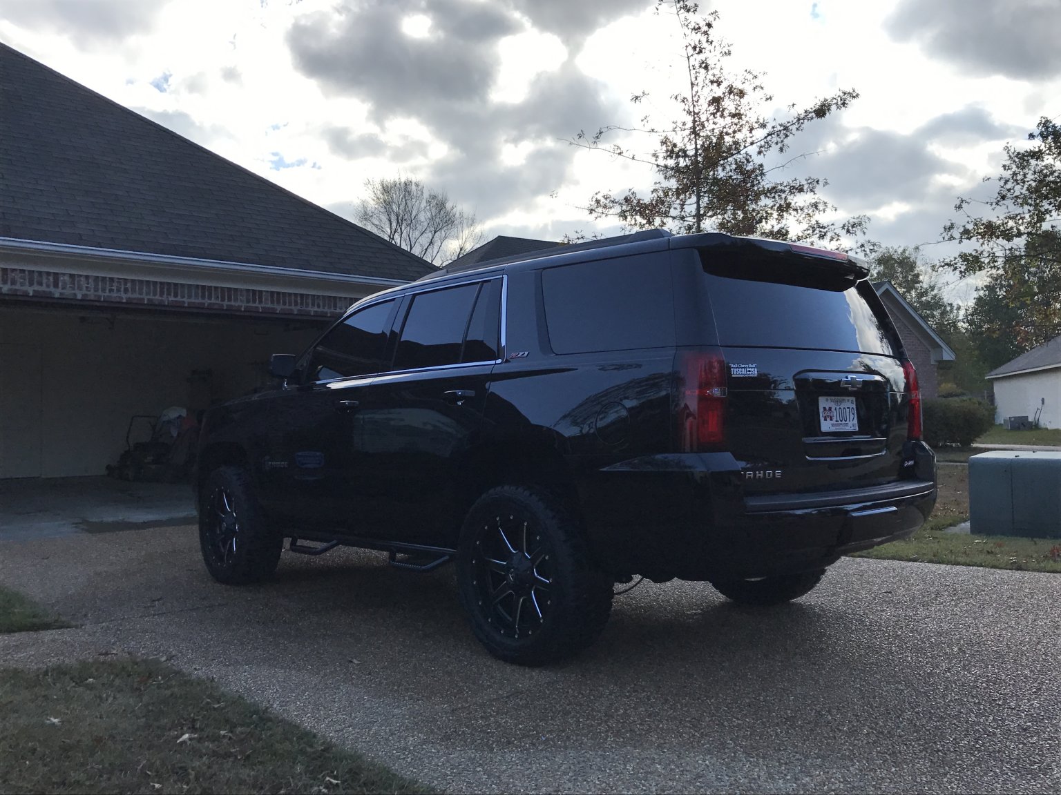

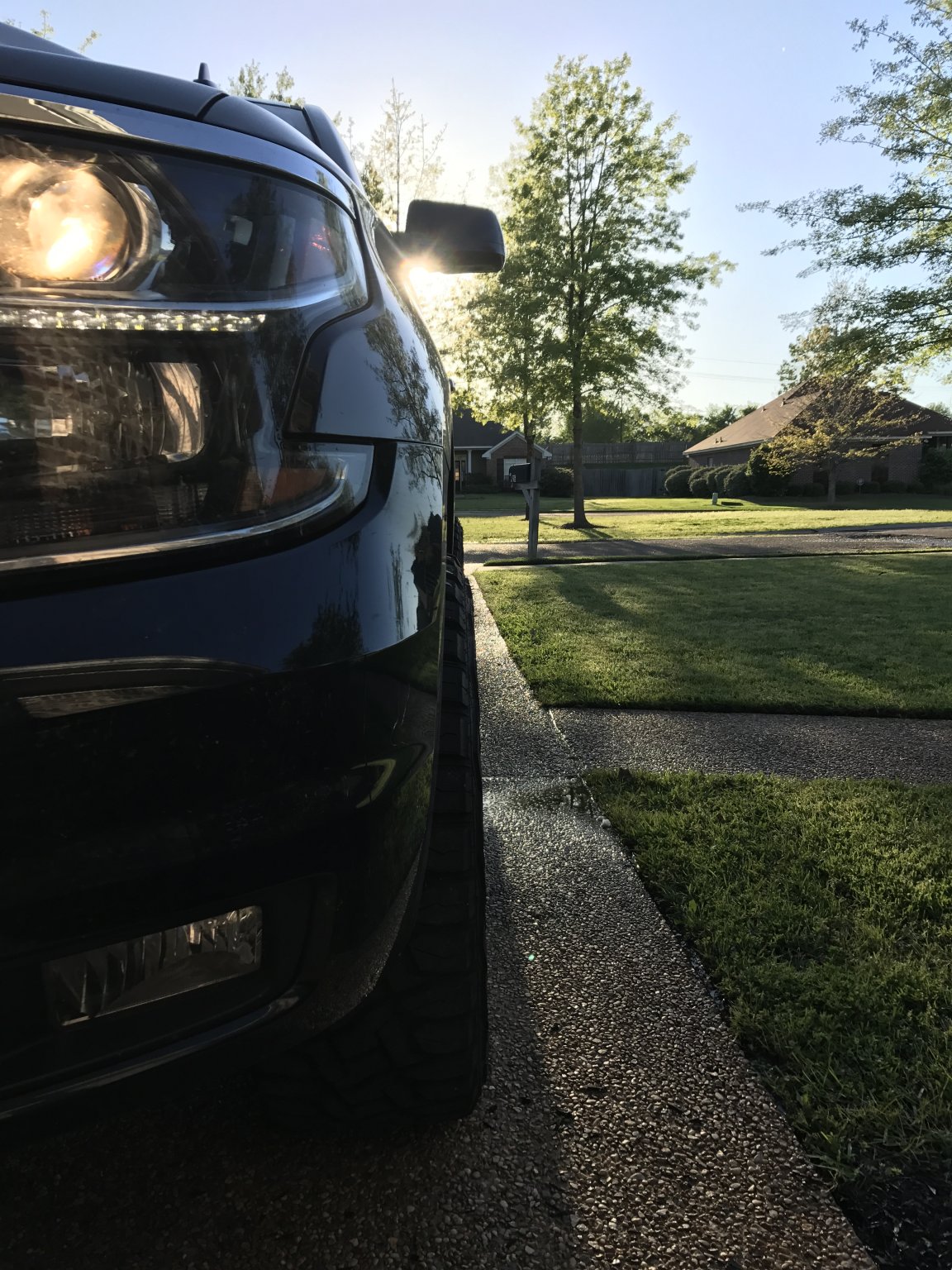

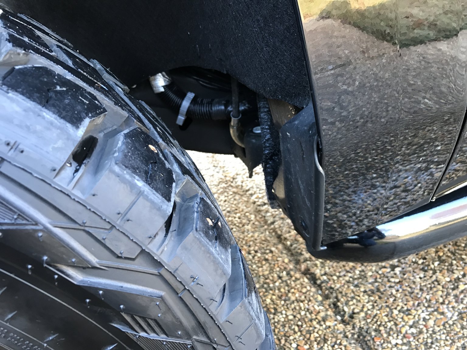

My 305/55 have a slight rub at full lock in reverse, but since the 285 would be skinnier they might work...
Looks good, I am torn between a 305/55/R20 Mickey Thompson or the 285/60R20 Goodyear Duratrac. I got 63k miles and still going on my Mickeys, so I am partial to them but they dont make the 285/60r20 and only can find a Duratac in that size. Decisions, Decisions..........

Yep, 305/55r20 2.25" ProComp Leveling Kit
Do you think a 275/60R20 would fit with your setup? I have your exact vehicle, You have a 2.25" leveling kit, I am installing a 2.5" leveling kit. I am trying to stay with Mickey Thompsons, and wondering if a tire .7" taller, two inches narrower than yours, would fit? Any thoughts?

A 275 should definitely fit as it is shorter by .2" as for the 285 I believe it would fit with the same rubbing I have now. Let us know how it turns out.
