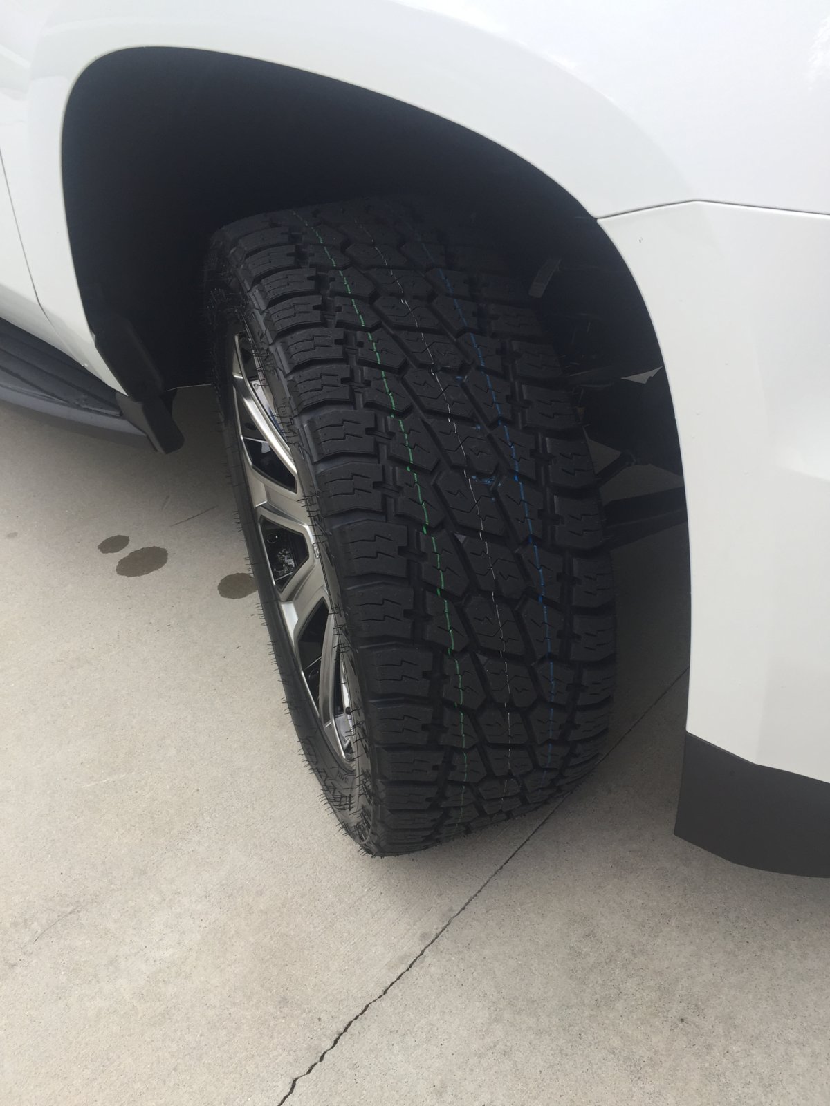

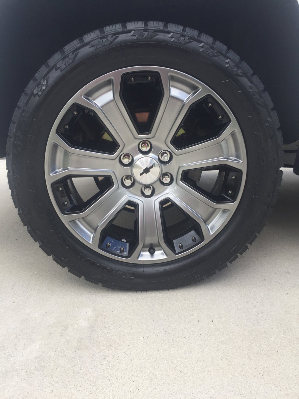

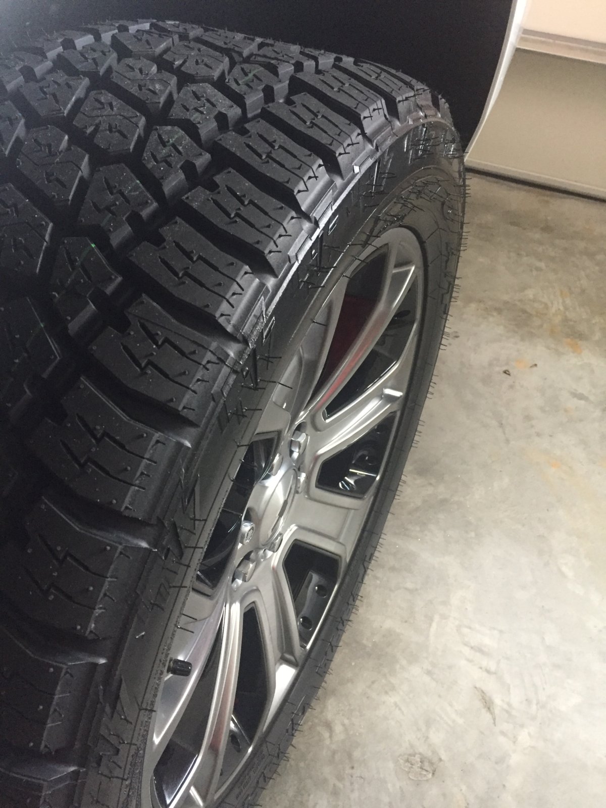

Here's some more pics and also the areas that were trimmed. (left and right front)
