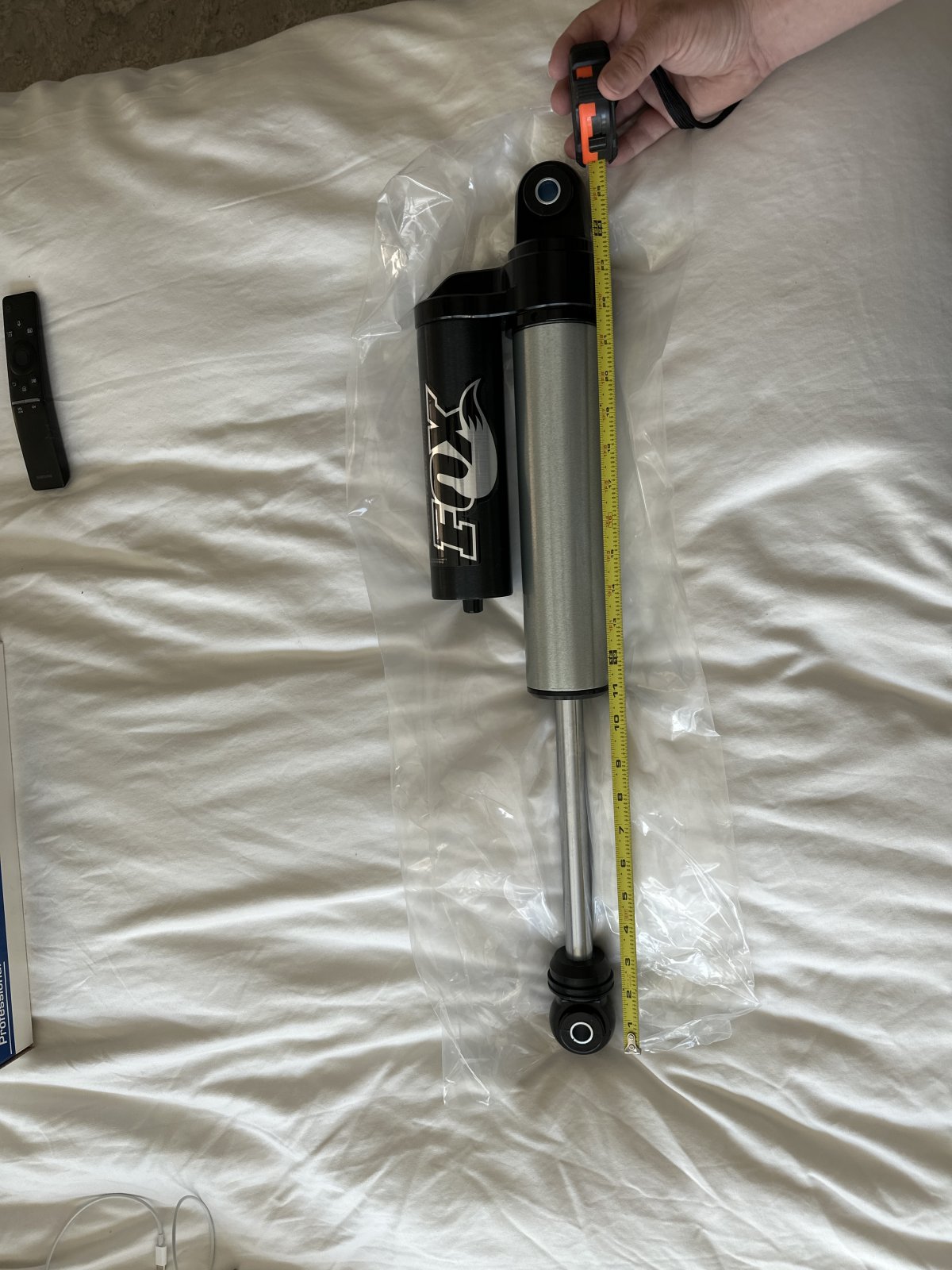

Can you measure the amount of shaft showing when they are fully extended?
Also the length from mounting bearing to mount bearing (fully extended length?)!!
The length of shaft showing is about 8-3/8” and total overall from center on center is about 24-7/8” fully extended. These are for up to 1.5” lift, I’m putting a 1” shock extender to fit these properly.
Fifty
Jun 26, 2015
813
218
Huge thank you!!!
It’s great to get specs so people can make sure what’s out there fits!!
oem magnaride front is 4.25 travel and rears are:
Smooth ride is 15.55” and 7.68” travel.
Z71 is 15.55 and 7.95” travel
Z85 is 15.55 and 7.20” travel
Z95 is 15.42 and 7.22” travel
Arnott as3429 is listed at 14.92 and 6.18” travel
Arnott as3066 is listed at 14.73” and 7.2” travel
Kyb 15.27” and 8.26”travel
Kyb red 15.28” and 8.07” travel
Monroe max air 14.625” and 9.313 travel
ADS is a 9” travel shock. I’m trying to remember its collapsed length. (Use z71 or border patrol spring… stiffer vs softer)
Multimatic dssv is 15.25” and 10” travel
