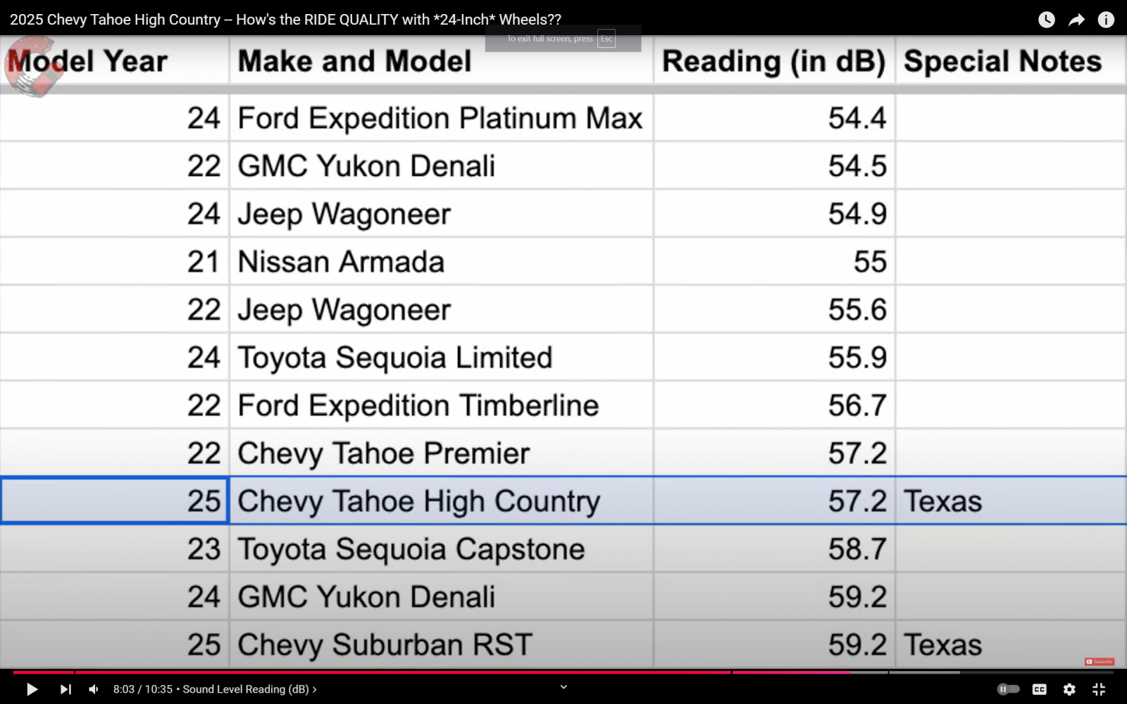

I would download an app on your phone that measure decibles. I was just watching a video on the 2025 High Country and they were getting 57 decibles on the new 24 inch wheels at 55 MPH.
It would be interesting to see what you are getting.
If it is a lot higher, at least you can tell the dealership that you have a data point and your vehicle is a lot higher.
It is easy for the dealership to blow you off if it is based on your feelings, but if yours is off the chart compared to 57 decibles at 55 MPH, at least you can give them that data point.
It would also be interesting to see what other people are seeing with different tire combinations.
BTW, I love that color combination. That really looks awesome.
Below is a chart of different SUV's. I got this from the youtube channel "Car Confections". They have a website that they post this information to.
58 dB. That said its definitely the tires. I rode in my friends high country with the 22's and he did Michelins. Different truck.
