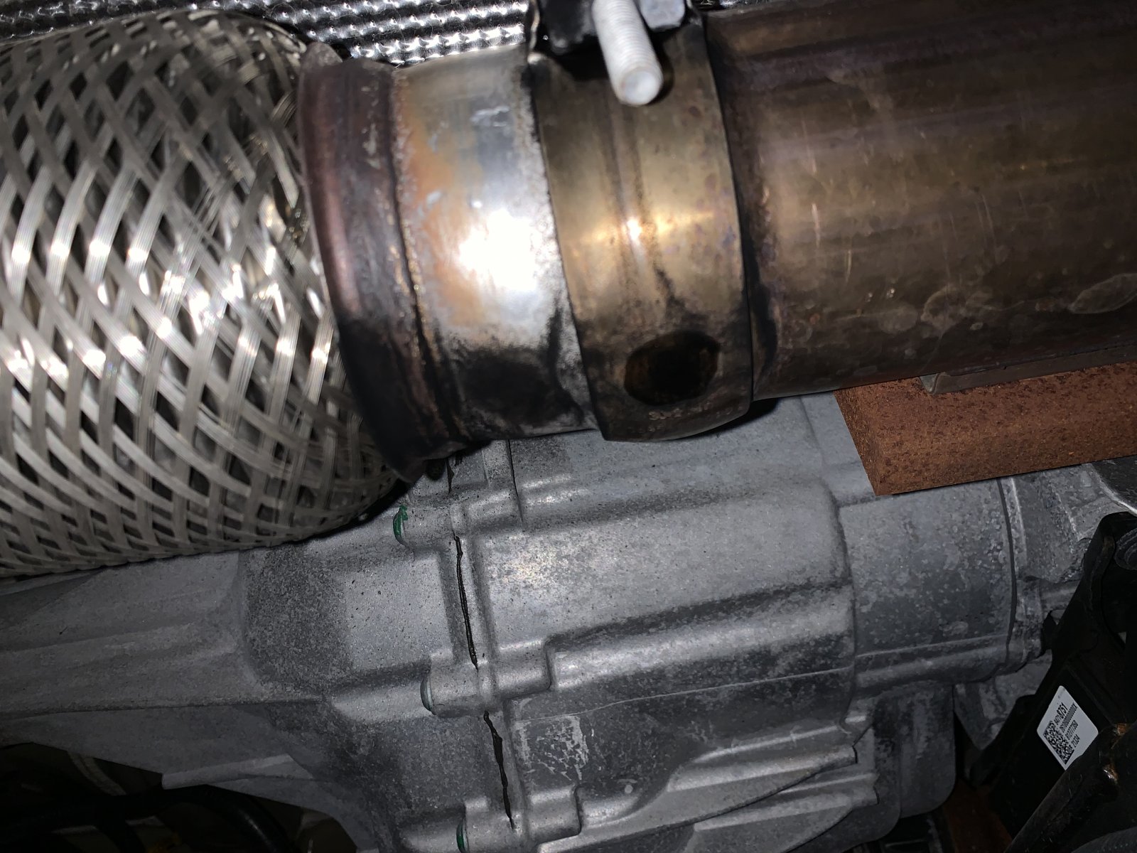

Have a 2022 Denali bought new a few months ago. It is leaking exhaust water at this joint so I can assume it’s also leaking exhaust itself. I tightened the clamp as much as I could but it’s still dripping, especially on first startup. Is this normal to leak from this joint? I would rather it go out the tailpipe. Yes it’s under warranty but I hate the hassle of going to the dealership, especially if they are going to tell me it’s fine.

Condensation in the exhaust is normal and a lot of factory mufflers will have a drain hole in the bottom rear of the case. That's ahead of the muffler and, judging by the soot radiating towards the flex pipe, it looks like an actual leak. Tightening the clamp might not work if the joint is deformed (dropped or bumped during assembly?). You'd have to remove the clamp to clean and inspect the connecting surfaces. If you don't wanna get that deep, bring it to the dealer. It'd take far less time to do the work yourself if you're up for it.

Thanks for the response. When I was under there tightening I attempted to move the clamp out of the way to inspect the joint, but the clamp is unfortunately attached on the top to keep it from moving more than an inch or so each way. I will take another look to see if there is a way to detach it temporarily

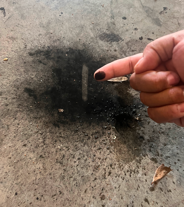

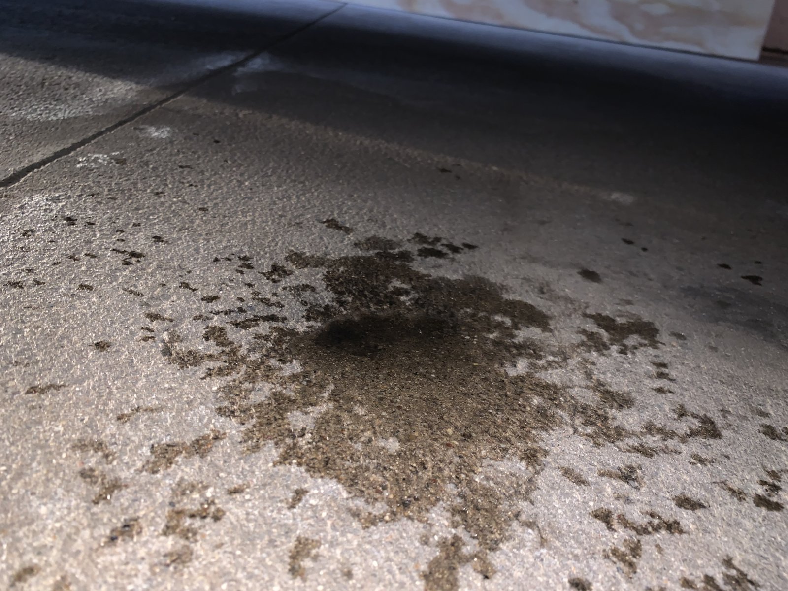

Having the same exact issue. Took it to two dealers and they all say "this is normal" which I completely disagree with. It's damaging my garage floor and I can't park the Tahoe outside as it damages my pavers.
Called GM for one last try to resolve but, based on issues i keep seeing creep up for these year models, I will most likely sell my Tahoe. I already had another issue with it and I am concerned they will keep creeping up.
I feel the quality has gone down on these vehicles during the pandemic.

Did you ever get resolution on this? I talked to the dealership about this and was also told it’s normal but like you said it’s damaging garage floor and paver driveway.
