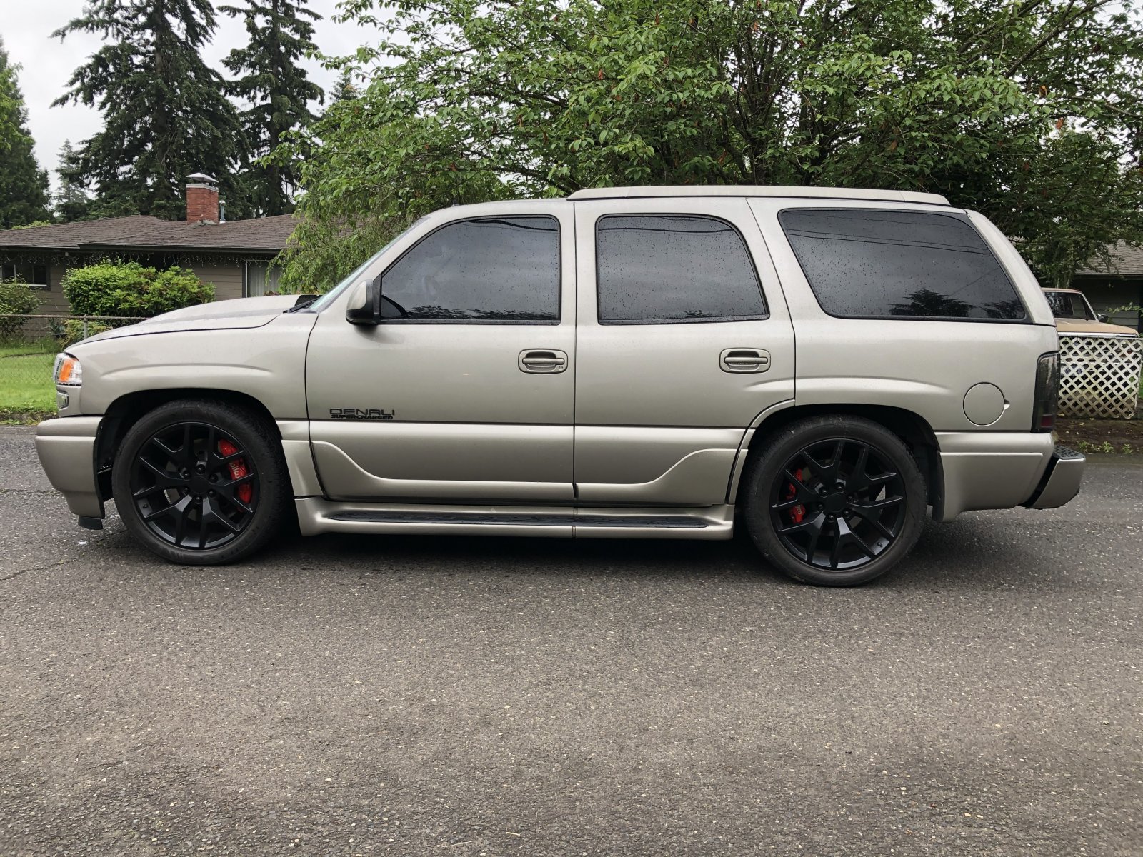

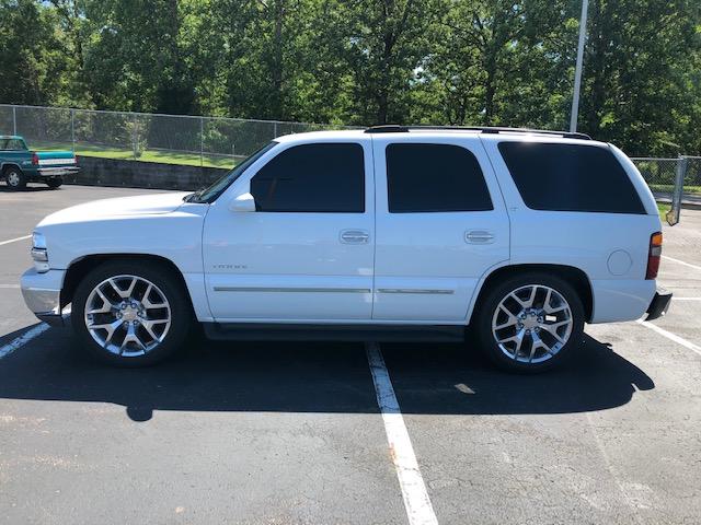

Factory oem Traverse I want to say
Where did you come up with knowing that they would work? Can you get a closer up pic of the center cap on the wheel. I really like that cause most people have to run those chrome center caps on a satin wheel.

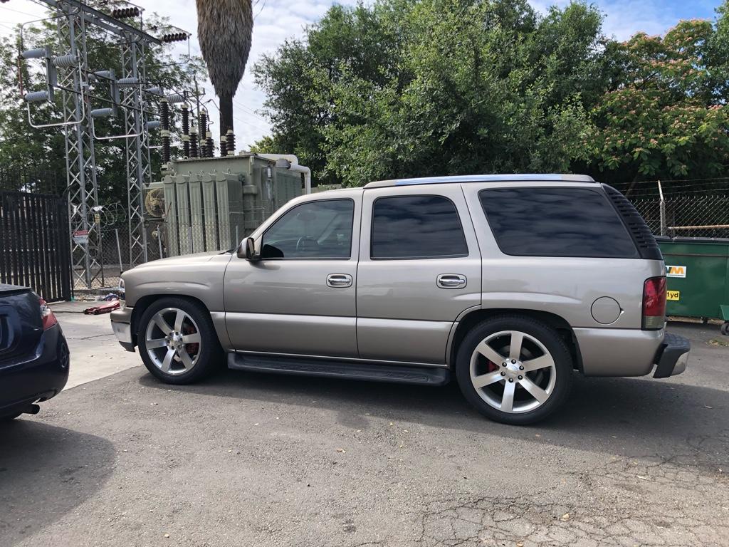

Don’t mind the Philthy wheels lol
I’ll text my buddy to confirm what they are off but he figured it out. They look so much better than chrome, just took those off today .

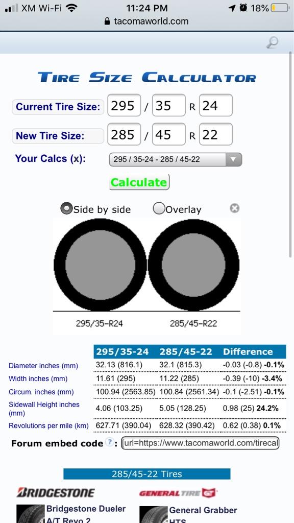

285/45 seems big but I guess if I can run a 295/35/24 I can run a 285/45/22
