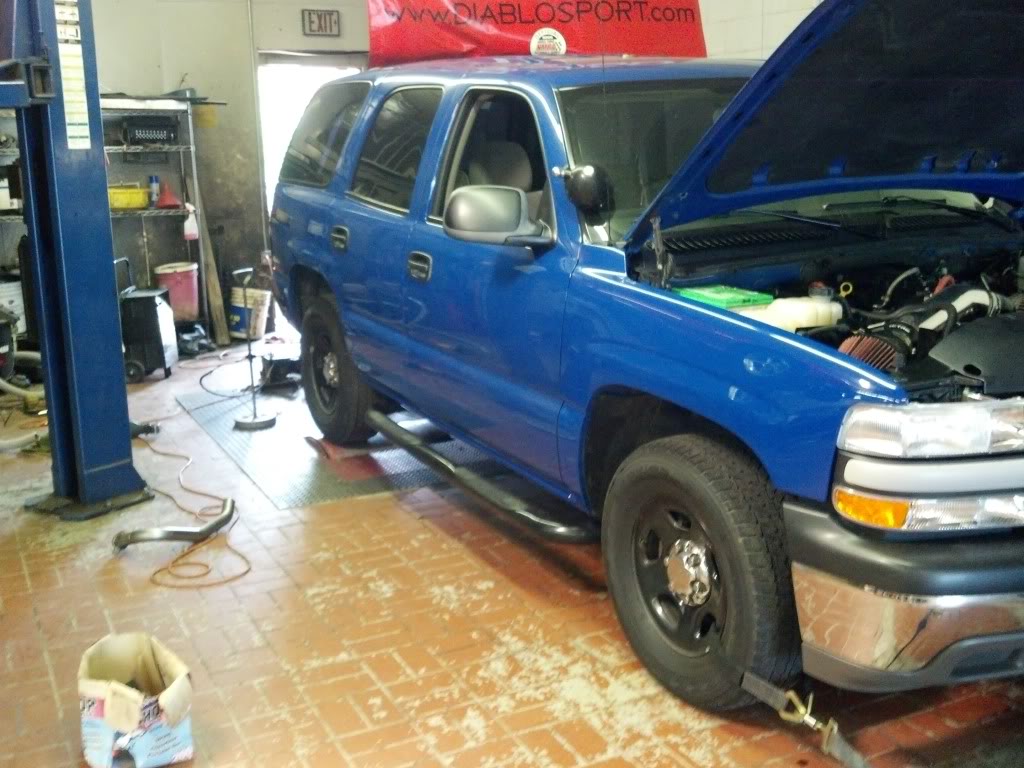

Currently I'm still having issues with the Cam position sensor which come to find out, you CAN NOT relearn....just the crank position sensor :shocked: so after every bit of trouble shooting we could come up with (verified wiring was good, fuel pressure was strong and even replaced the CPS) there is still no joy. Still getting the hard start (2-4 tries then it fires right up) and the SES. Now I'm starting to wonder if the camshaft isnt 100% compatable with my build. the error is a high voltage reading...any ideas? I'd like to fix it instead of code around it.

I'll send thread to JP my buddy that does the EFI live tuning see of he has any ideas.

So...I went to the dyno at lunch today :D
DYNO RUN LINK
