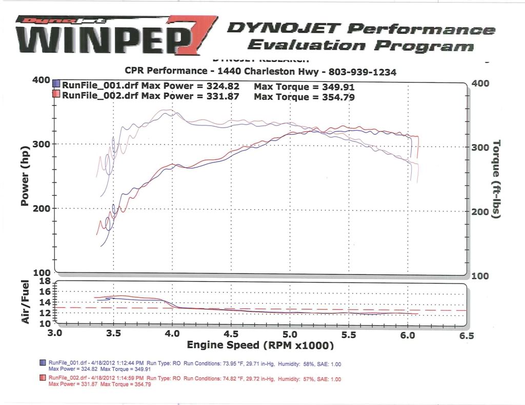

Interesting, so I have 2 questions then:
1) What kind of dyno do you recommend using? You'll have to forgive my lack of blindly following information as I really try to see things for myself.
2) Is a 100HP increase on a dynojet a 100HP increase? Previous dyno of 227HP and now 331HP....is it still a 100HP increase or is that skewed too?
I'm going to track down your recommended dyno and see whats up.
Using the same dyno to compare the before and after is a good way to go about it. So yes, on that dyno you did see an 104HP increase, but it is inflated for real world numbers. But, it is a consistent number for the dyno you used.
We recommend using a load bearing dyno for tuning, however, if you are just looking for numbers, a DynoJet will suffice.
Dales396LT4
Apr 23, 2012
The Dyno is just a tool to gage the improvement or in this case to check A/F and RWHP. TSFR: your tune is on the rich side and will gain some from timing as well… More People tune with Dyno-jet than any other Dyno in the world. A 100rwhp is a 100rwhp and at $2500 you did a Great Job using all GM Parts to do it.

So...I went to the dyno at lunch today :D
DYNO RUN LINK
