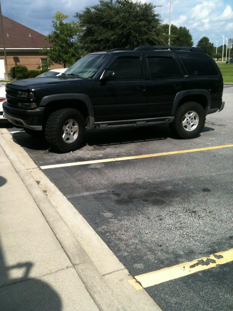

i got 35's on just a level kit(keys and shocks) and i had to trim a tiny little piece of my valance on each side and had to put a quarter inch spacer in the back and im good to go.
2005SnowKon
Jan 27, 2012
630
Fort Collins, CO
How does it look?? Got a pic bc if I can fit it I will do the same also
Donnie Yukonie
Yates Caretaker
Jul 31, 2011
5,125
161
how is it offroad? i could imagine even on stock rims that would rub with any flex x2 on the pics

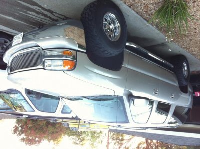

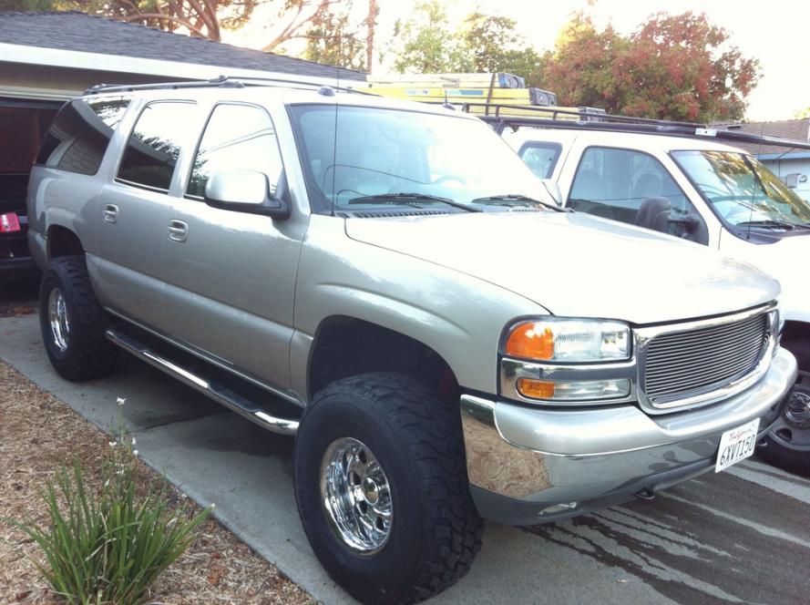

Lots of guys run up to 36" tires with just cranked aftermarket keys and blocks or spacers. Note, stock rims or similar offset and width is a must.
It all depends on the look you are after: stuffed, proportional or towering over the tires
