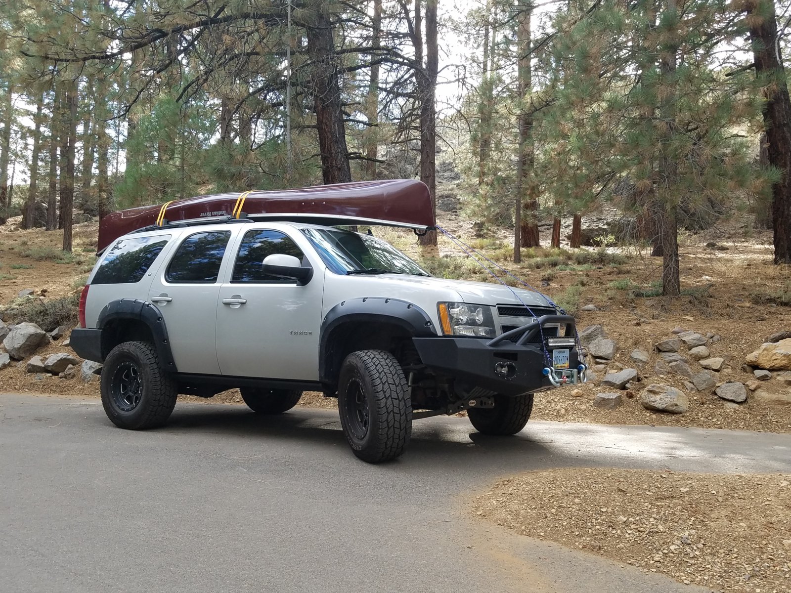

Got out and had some fun this weekend blazing across the desert and doing some hill climbing.. Camping shooting machine guns and watching shooting stars to.. Notice the rear bumper is no longer black at all.18767604.jpg 18740635.jpg

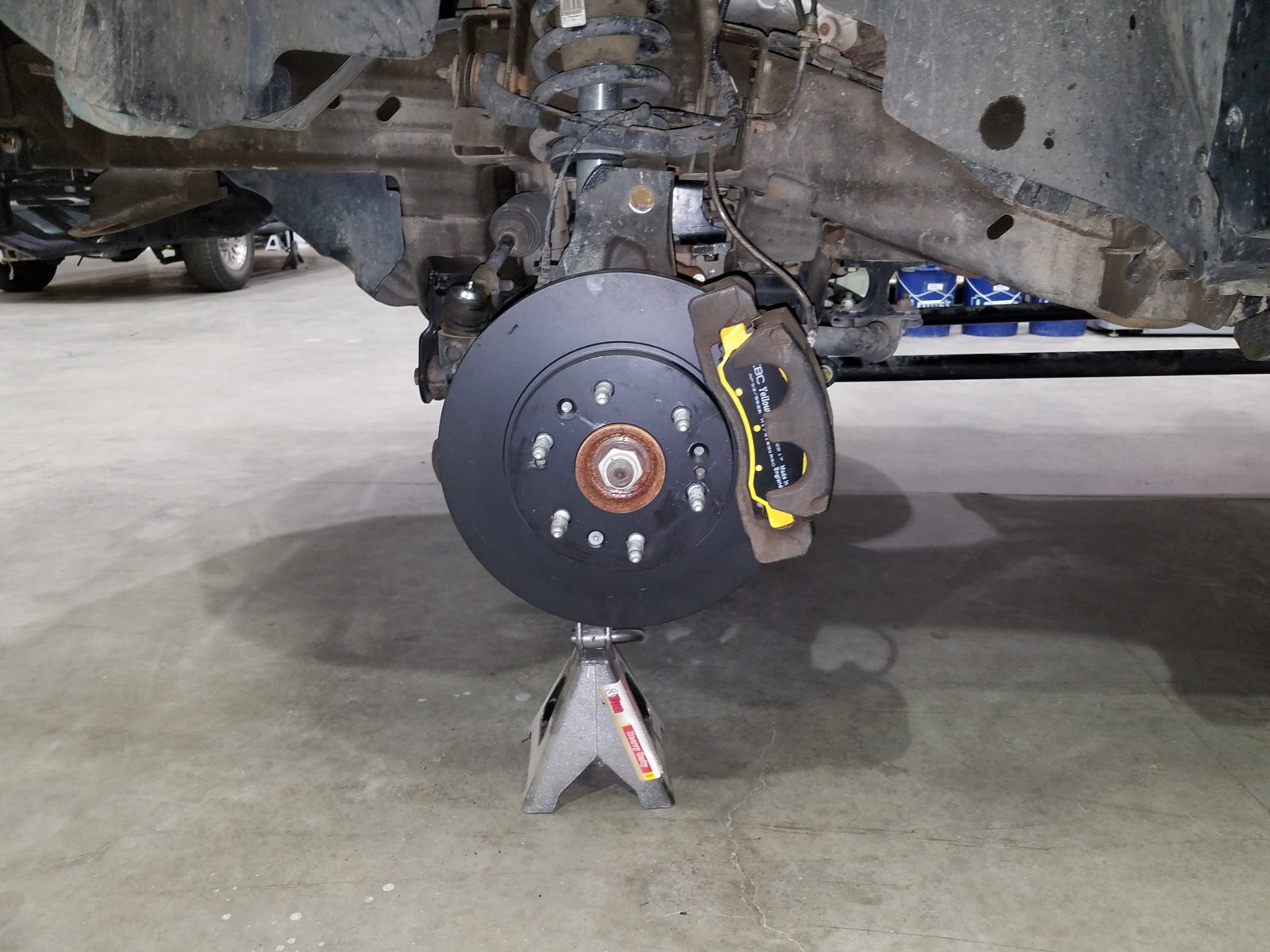

Braking has suffered a little you have to use a little more effort than before to slow those big tires down. The intermittent brake pulse I had seems to be more noticeable and not so intermittent now. I am planning to put some aftermarket rotors, calipers and better brake pads on. Anyone have some braking suggestions?

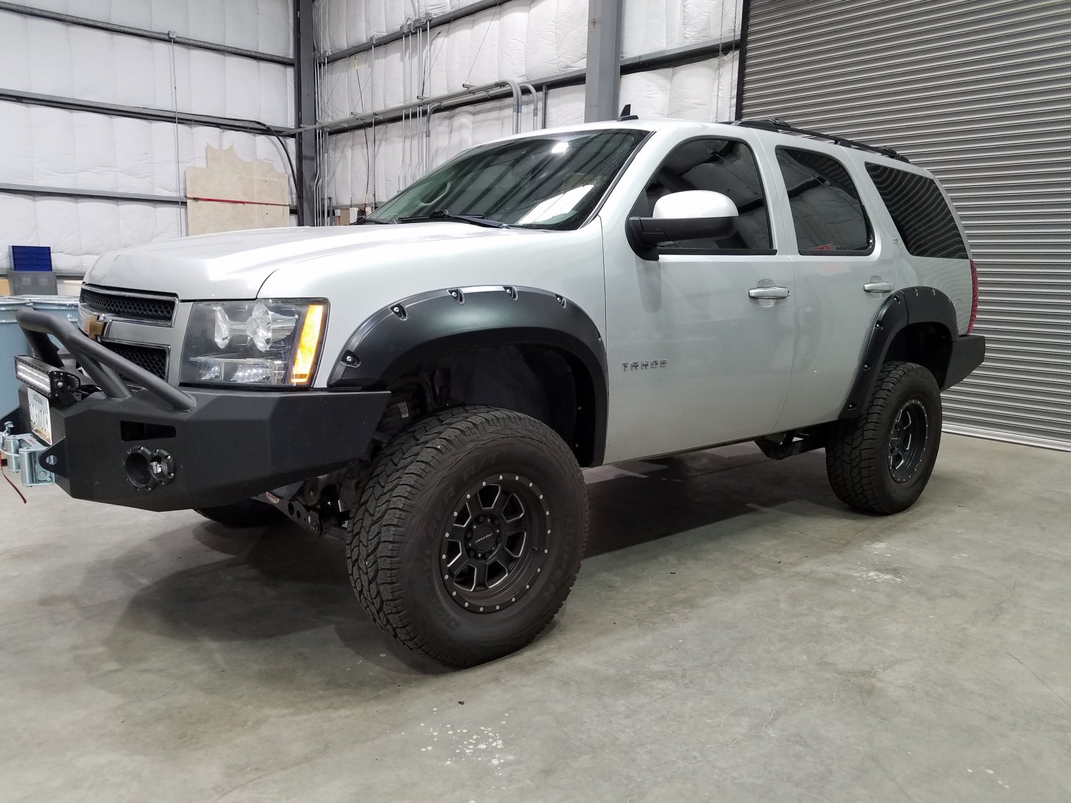

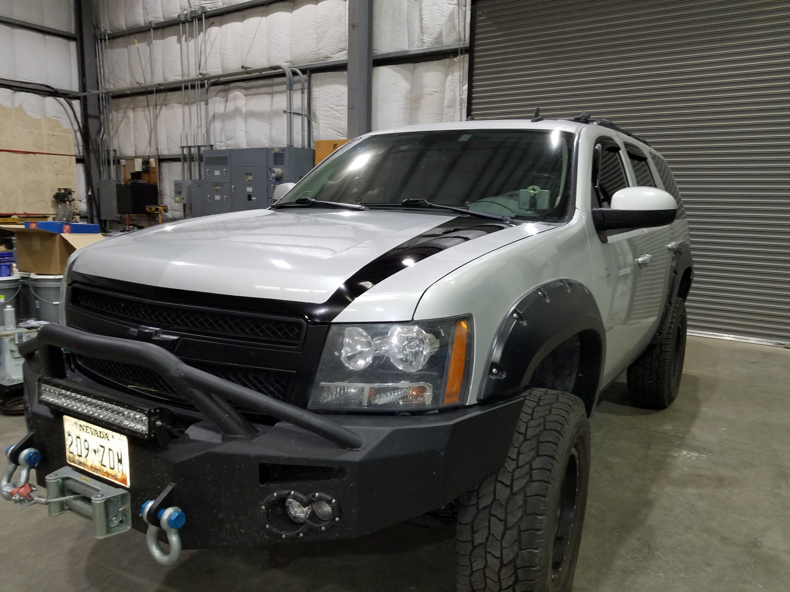

Installing the steel bumpers creates a lot of wheel clearance but there was some trimming needed to clean things up so the tires wont rub. The extra weight added to my decrease in mpg too but the need for a solid winch mount and tow points helps out off road and I think people are a little less likely to get in my way now since it does look a lot meaner than before.

Installing the 4 inch lift kit, new wheels, new tires, shocks and mounts trimming the inner fender, grill had to be cut out and shaped, running wiring for lights making light bar mounts, Alignment, installing Stainless steel brake lines, installing the front and rear steel bumpers, Reinstalling sensors, installing and wiring a winch, changing coolant and other maint. related stuff. The parts cost adds up pretty quick too... Total parts were over 10 grand.
