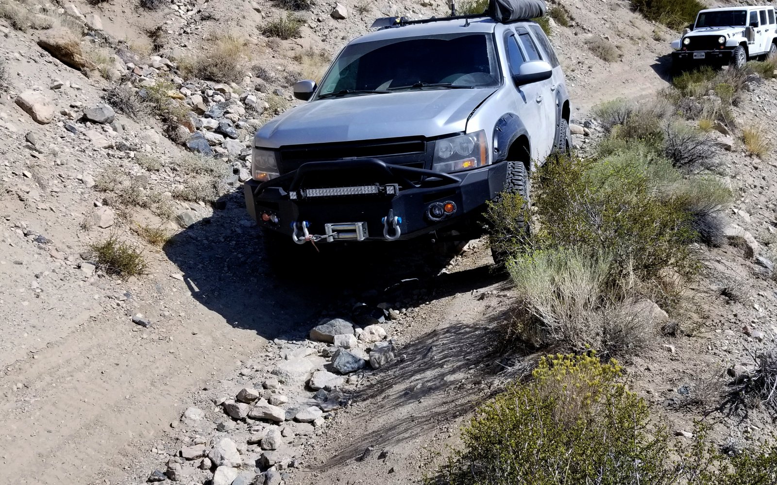

So far everything feels much better with the new 4.10 gears they are much better turning 1900 rpm at 70 the shifting is much better and I am sure after the learning phase it will be even better.
I installed a set of EBC rotors and EBC yellow pads on the front today what an improvement in breaking after breaking them in.
I also installed a set of window visors
I also decided to do a little paint work to accent the front end I think it needs something in the middle though maybe a hood scoop will work or maybe just some different paint work... 20171112_152902.jpg View attachment 186544
