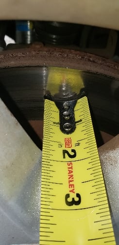

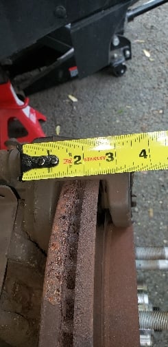

I do mean Brembos. I only mentioned that in regards to the naysayers saying you need an entire new brake system because the pedal won’t feel good and the power brakes won’t work.

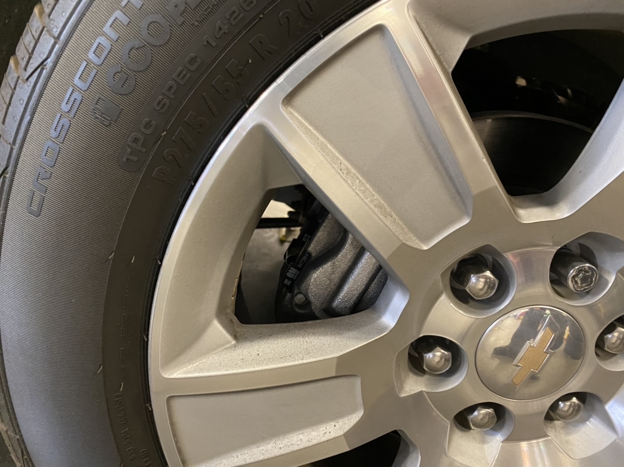

I test fitted the 21 calipers on my Yukon and the wheels don’t even come close to fitting and the ridge isn’t even the problem. These calipers are just super wide and since the rotor isn’t much bigger than stock they’re so close to the hub where room is tight with a concave wheel.

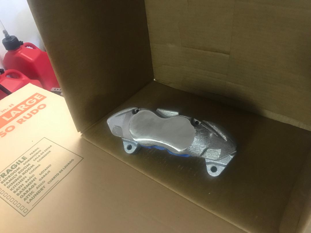

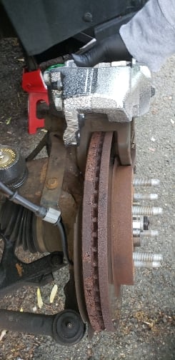

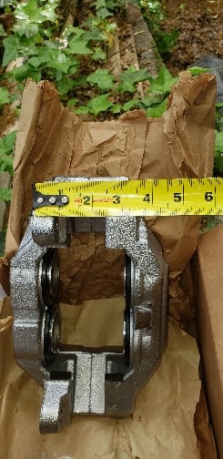

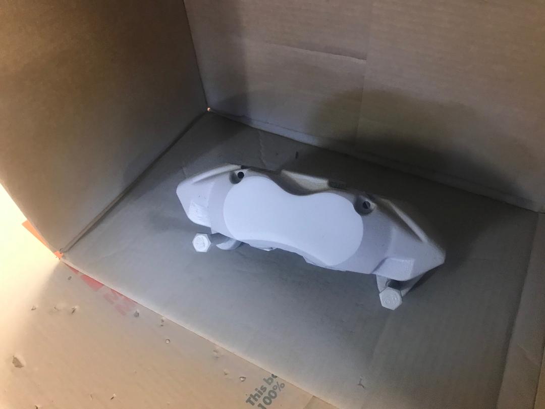

My calipers should arrive today.
I'll post up some pics later of what I'm working with here

The 2021 Tahoe shares the same front caliper as the silverado.
If the 2017 front wheel spindle is the same as the 2021 Tahoe it should bolt right up.
I would say you have a high probability.
Thank you for the info

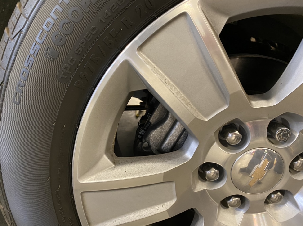

91RS what size wheel did you try.and where did they hit on the barrel or face?

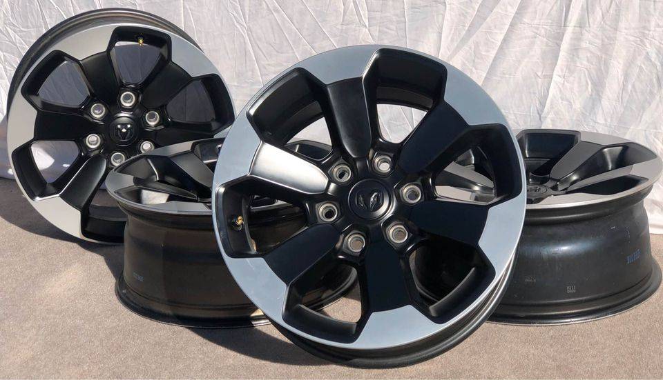

22” Snowflakes, the 22” 6 spoke black wheels, and 22” 19 Escalade Sport package wheels.
