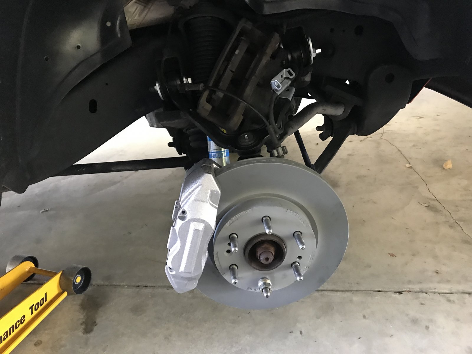

This is getting a little out of hand there....smoothing the texture of the caliper....but I agree.
I'm going to install and test mine first.
Then see if they fit on the back.
I also think the caliper would look better with that front ridge shaved off. Its steel so I don't think that would compromise the caliper too much.
Then you could put some heat resistant stickers on it.....I haven't seen any Tahoe ones.
Yeah many have shaved that forward facing ridge off with no issues

What would be the best way to shave off that ridge? It almost sounded like some people have had a machine shop do it and now I'm seeing people talk about grinders, flap wheels, etc. I got the Brembos installed on my truck yesterday and the pedal feels great and they stop great. I was planning on swapping over my old calipers with the EBC pads to my Yukon but now I may want to use these 4 pistons if I can make them work with the wheels I have because I don't really like the EBC pads.

I'd like to shave that ridge off to.
I think the folks here were referring to smoothing the rough texture of the caliper with flappers and grinders.
When you say brembos do you mean Brembos? Or the 2020 Silverado caliper?
I thought about buying a metal blade for my chop saw and just shaving it off but its a lot of steel material, will make a mess and could bind and launch a 20lb football into my groin.....So I put that on the back burner.
