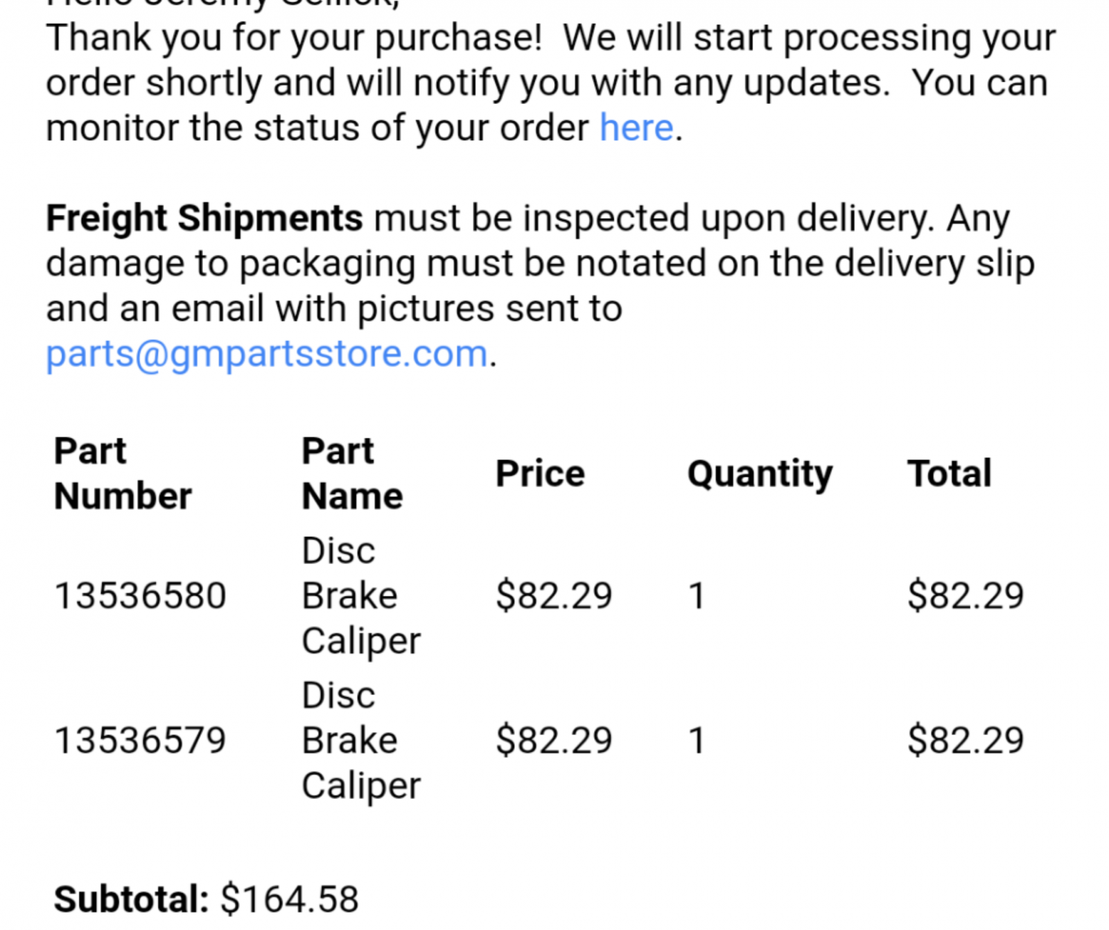

Everything brand new, should be about $350 to $400
Well just got back from the dealership (one that has always done right by me). There is a national back order in my region. And the few dealers that have the calipers will not sell them unless you have a VIN.
Secondly, they want $181 for caliper. There was a dealer about 1.5hr from me, but don't have that time right now.
