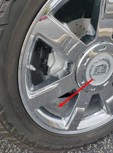

Fjs0001
Mar 1, 2018
97
73
Inside of the wheels…? You have pics..? I don’t understand.
These wheels were flaking on the inside part of the wheel. I painted them with the caliper paint to make them look better and hopefully slow down the flaking.
