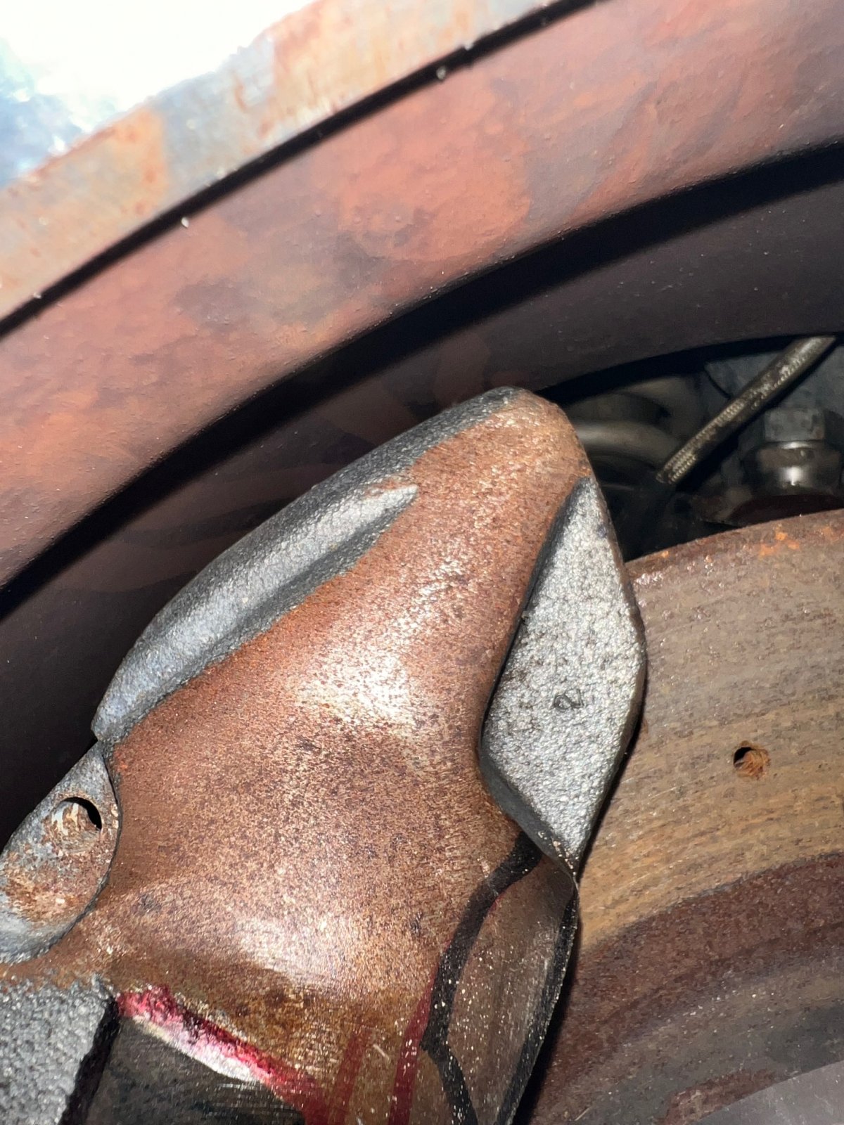

It's unlikely this info will help anybody but I can confirm that these brakes will clear 2008-2011 Dodge ram 2500 factory forged 17" wheels when 8 lug adapters are used to fit them on the front of an NBS truck.
Does anyone see any deals on pads and rotors for these? Or even a place to buy OEM pads and rotors as a kit instead of piecing stuff together.
Here's the barrel clearance at the top where it's usually the closest and, the wheels I'm referring to.
