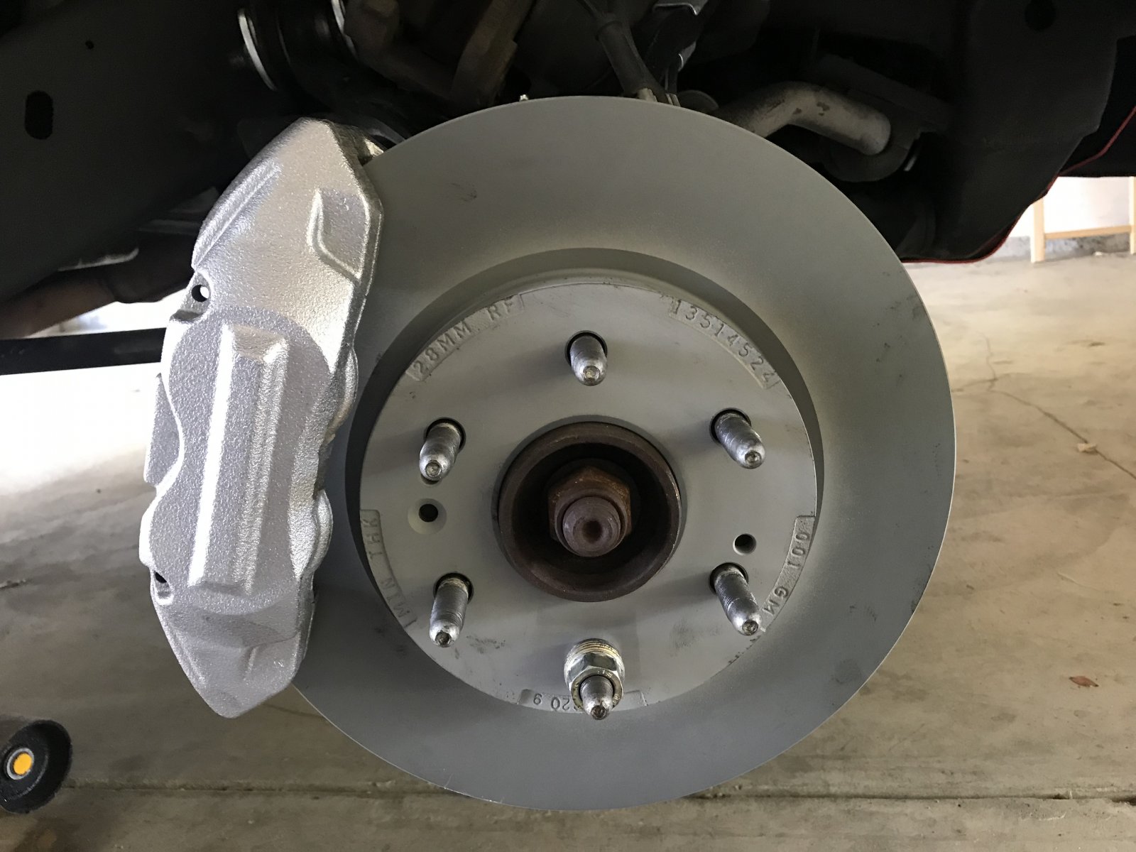

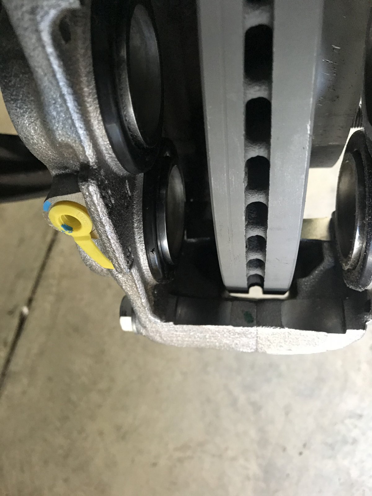

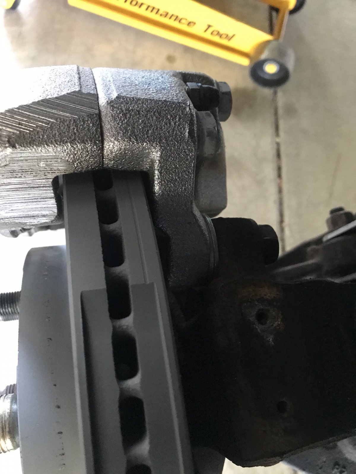

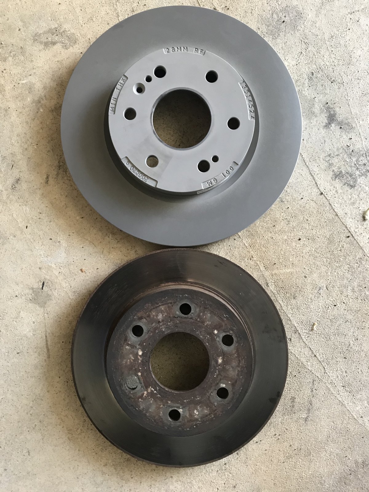

My calipers and rotors arrived today, Sunday, Easter Sunday. Thank You FedEx!
The calipers come with the pin kit so you don't need to order those.
They are BIG! Complete with pistons and seals and painted silver. What a great deal for like $80 per.
2 piece caliper, not monoblock, but you can't beat the price.
These will powdercoat really nice.

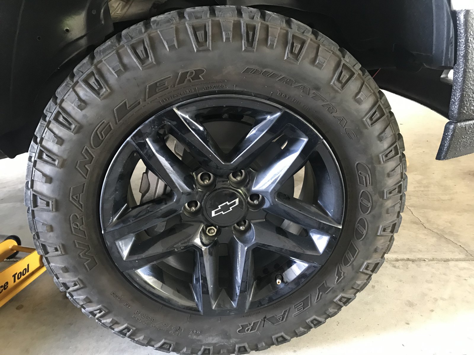

Very Similar to the calipers on my Colorado....different part number though
But I bet those Colorado wheels will clear.

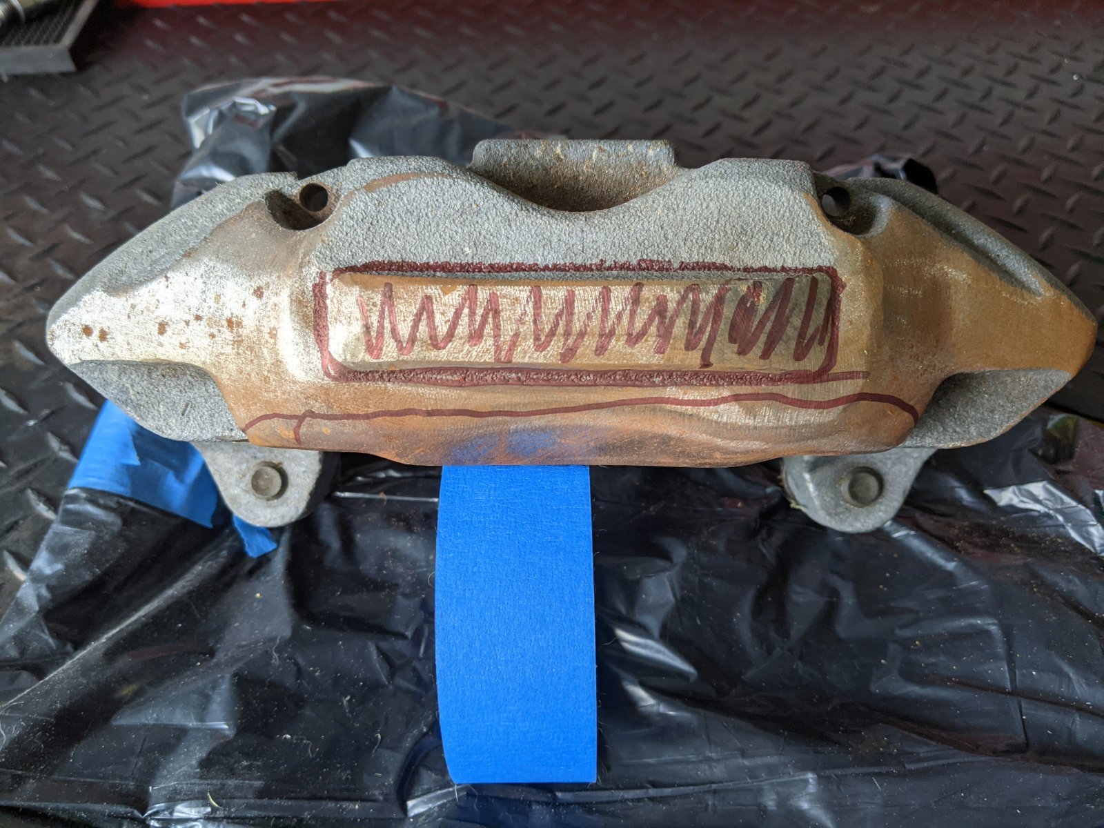

Here's a guy who just painted them for color....He was really pleased with the outcome LOL.
And he runs 1/4 spacers so his A/M wheels clear.
Duplicolor makes many colors of paint and a good option if you don't want to pull the caliper apart for powdercoating.
I would paint it before you put it on.
How to Paint your Brake Calipers 2021 Tahoe Yukon DIY Tutorial - YouTube
I've used that kit once on another vehicle. It worked okay. But no matter how hard I tried, I couldn't get rid of the brush marks. Eventually I stripped and redid them using the spray kit, when I had them off for a suspension rebuild. The results were much better. It never chipped or faded at all. I wouldn't hesitate to use it again. It was much easier than fully disassembling them for powdercoating.
