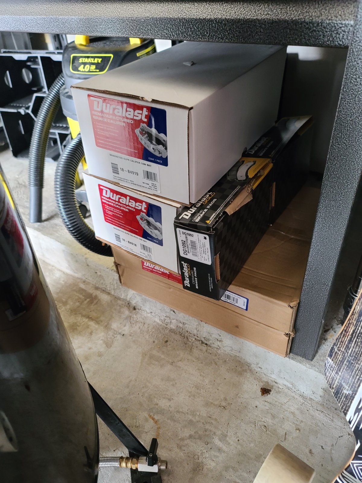

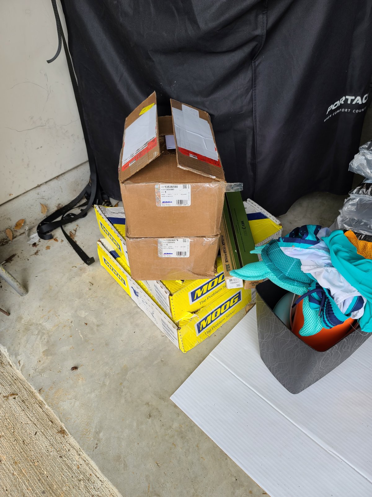

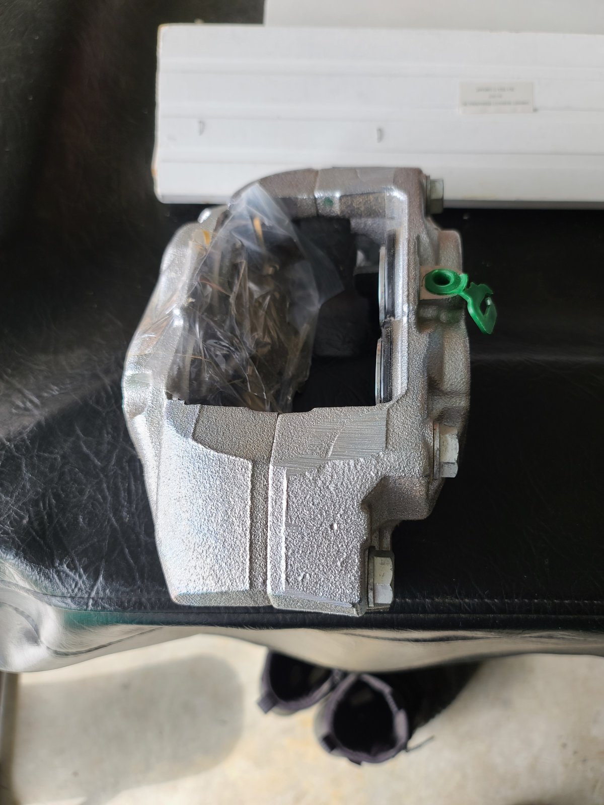

My caliper order shipped! I have tracking number.
I was so concerned that with the national backorder thing they we going ship me the rotors and rest and nix my calipers.
Even gmpartsdirect says "item no longer for sale".
So I should be able to test fit them later next week.
I'm also pretty sure that my 05 Z71 wheels won't clear with the +31 offset.
All of the 2020 Silverado aftermarket wheels are minimum +12.

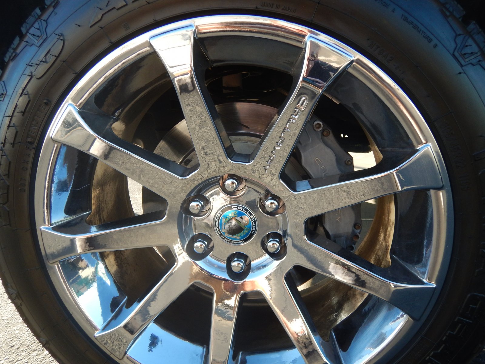

I'm wondering if these will clear 20" with 28mm offset. I realized after the fact that my stock 2004 17" are 31mm and the take-offs from my BIL's new Silverado I put on are only 28mm.
Well...if they are from a silverado with the 4 piston calipers they should clear.
