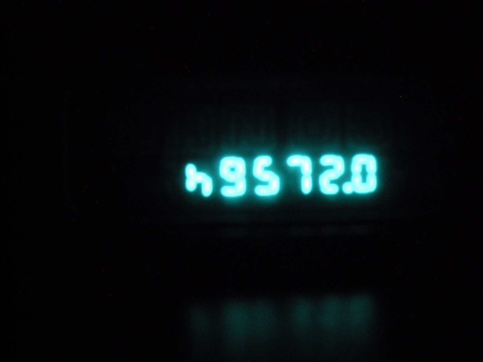

DSCF3665.JPG I have had the same issue once in a while. I never go more than 5k rpms and have only held it to the floor a few times till it shifts. 10,000 HRS that is more than my Tahoe with 295k.
