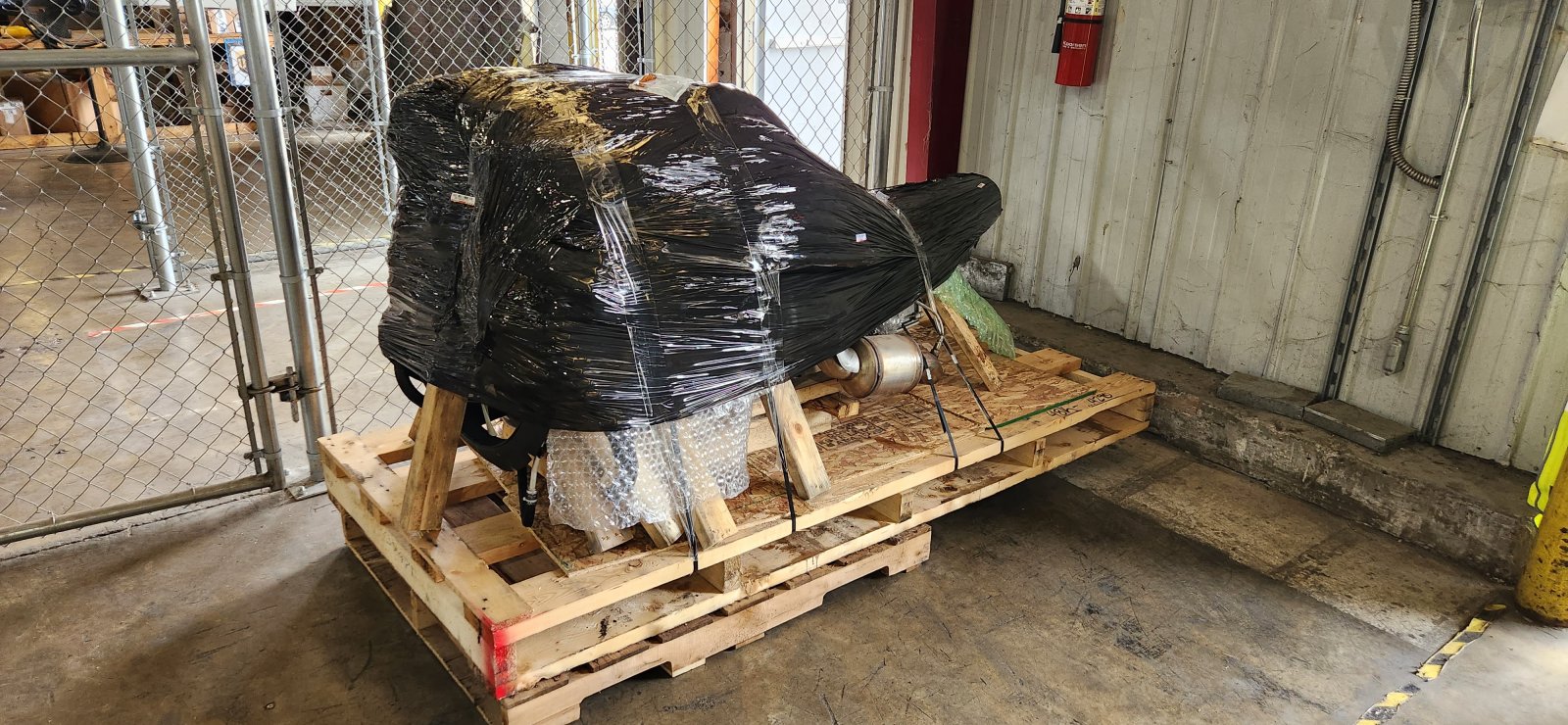

UPDATE!!
Engine/transmission has been purchased! The seller will be palletizing and prepping for shipment by weekend, and I should receive it by the middle of next week! I'm freaking PUMPED!!
Here are some pics of the donor vehicle and engine/transmission...
S.jpgScreenshot_20230824_125926_eBay.jpgScreenshot_20230824_125944_eBay.jpgScreenshot_20230824_125954_eBay.jpgScreenshot_20230824_130116_eBay.jpg
