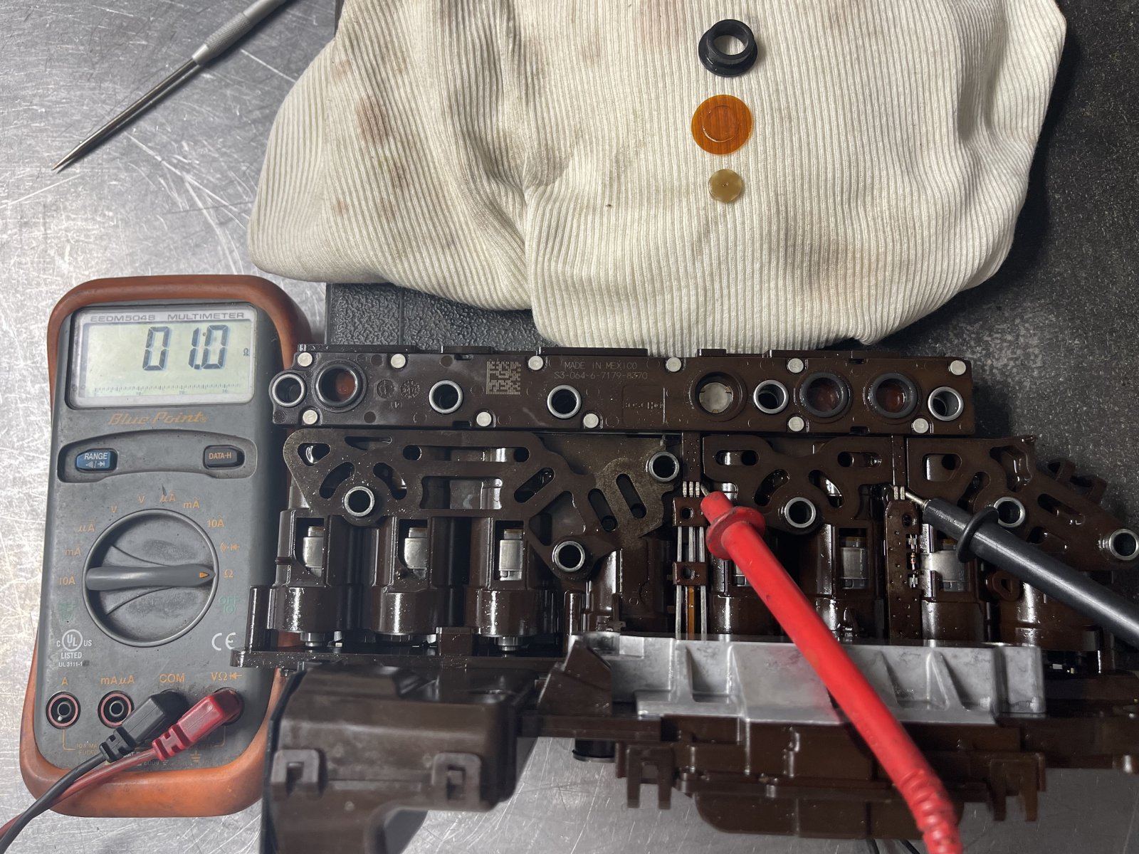

It can definitely be worth it under certain circumstances. I use that kit on all rebuilds where we're not replacing the TEHCM but as far as repairing a fault in one of the solenoids or malfunctioning pressure switch, that kit wont make a diff as it's not designed to fix those sort of faults. It's primarily designed to restore the positive seal for the pressure switches via replacement seals. Leaking seals can also cause flairs, etc but they'd have to very degraded (see it when the trans overheats, turns those seals hard thus they leak).
But if the TEHCM doesn't pass the resistance or voltage tests, the above kit won't restore it.
For those that haven't seen the pressure switch parts off the TEHCM, here's a pic:
