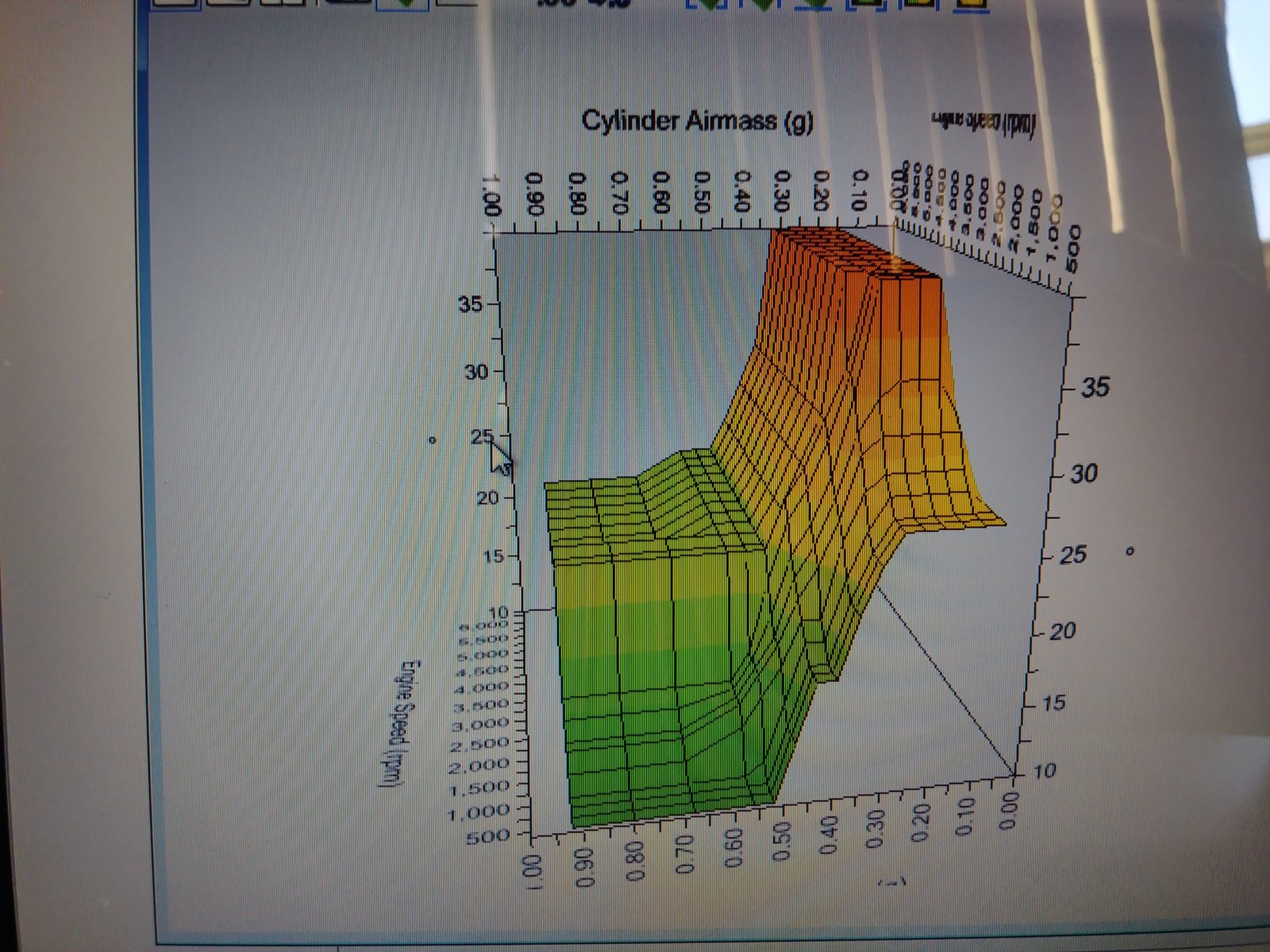

I agree that you should run what your owners manual says to run. If it's tuned to run on 87, you won't see much difference in mpg running 91 and you'll be wasting money. If its tuned to run 91 or has high compression and you run 87 you risk detonation or ping and damage. The tuning tables have flexibility but that's designed for differences in brands, not necessarily different octanes. I had the availability of 2 different tunes from BB on my Autocal, 87 and 91. I ran both for several tanks and saw about 1-2 mpg difference which wasn't worth the added cost. But now that I installed the Whipple I have no choice but to run 91+ and my tune is set up for it.
