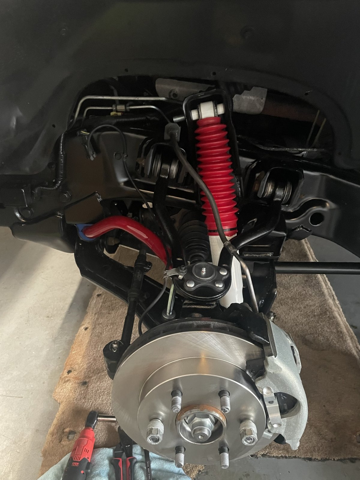

Good morning, I am also having this problem. I bought new bushings but they are loose. Parts store Guy said could be bad housing on the LCA. Can't find a replacement other than junkyard. Does the astro van have the same setup? I appreciate your time . No one I've talked to has an answer.
