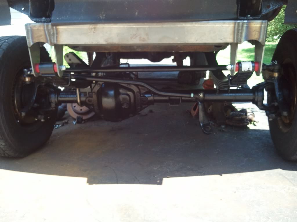

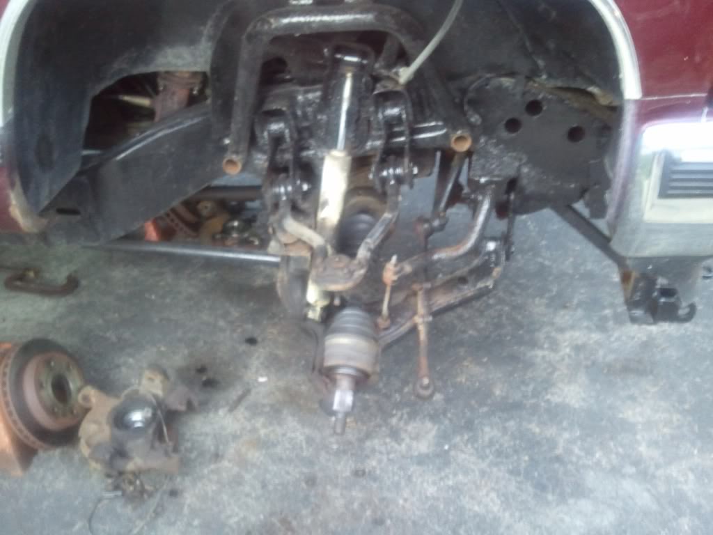

Just wanted to show my other projects that are on hold while I've been messing with one. First is my 97 K1500 Centurion Conversion. I bought it in January of '00 with 62,000 miles. Didn't realize at the time that it's a rare truck. GM didn't make crew cabs in 1/2 ton trucks in 97. It was ordered as an extended cab, cab chassis or camper special as dealer told me. Then went to a conversion place in Michigan for the frame extension and rear cab added. 350/4L60/241 but had a 14 bolt semi floater rear axle. I put a 6" lift on it and plowed with it for 8 years but I took care of it. Washed it after plowing every time and waxed it 3x/ year.
Then decided I was tired of completely replacing front end every year so it was time for a solid axle swap and an extreme lift.
I have pics of the entire conversion but this is where I'm at now. I have a 454/TH400/205 and running on Chevy Dana60/14 bolt full floater. But I also have an extra 4L80 that I might use. Was thinking about doing a Duramax but after getting into the wiring I decided to use a Cummins 24v with a P-pump conversion. It's too big for garage so I only get to work on it in summer.
