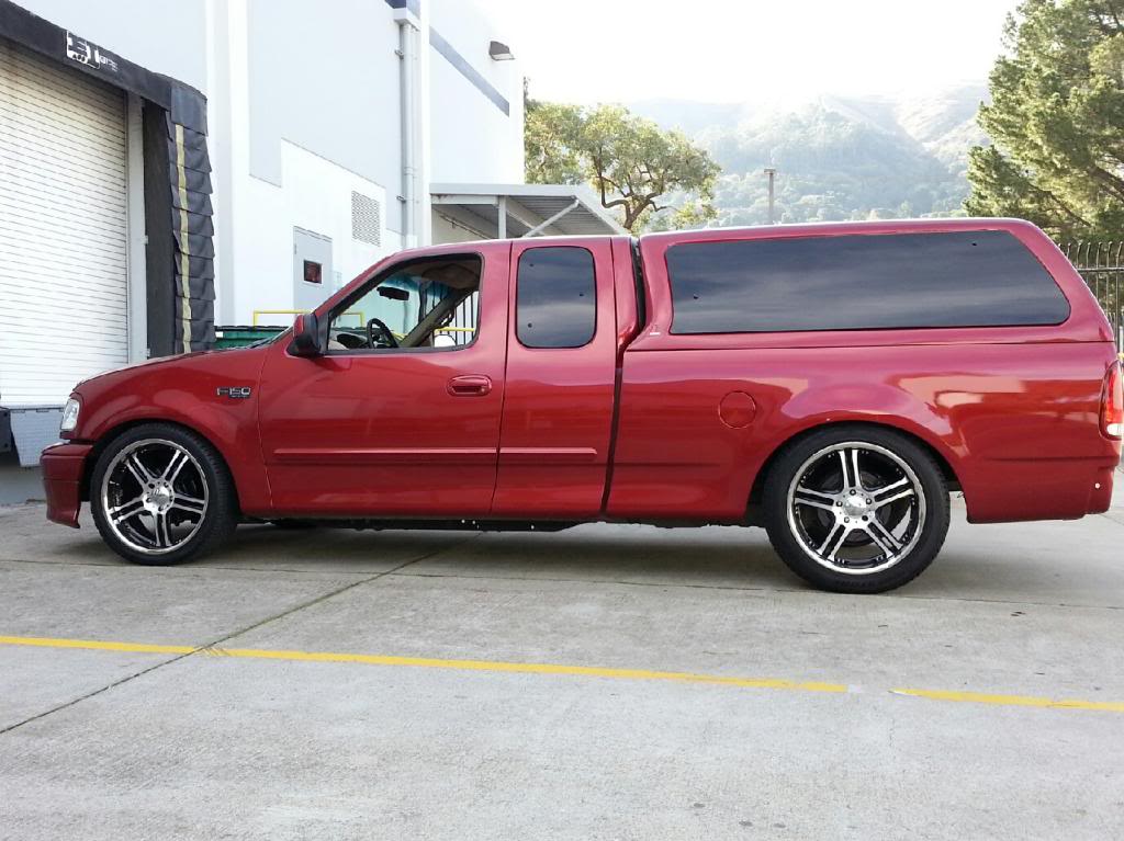

For example here is my truck
285 35 22 front
285 45 22 rear
22x9.5
In front 30 inches from ground to fenderlip and in rear 31.25 (about)

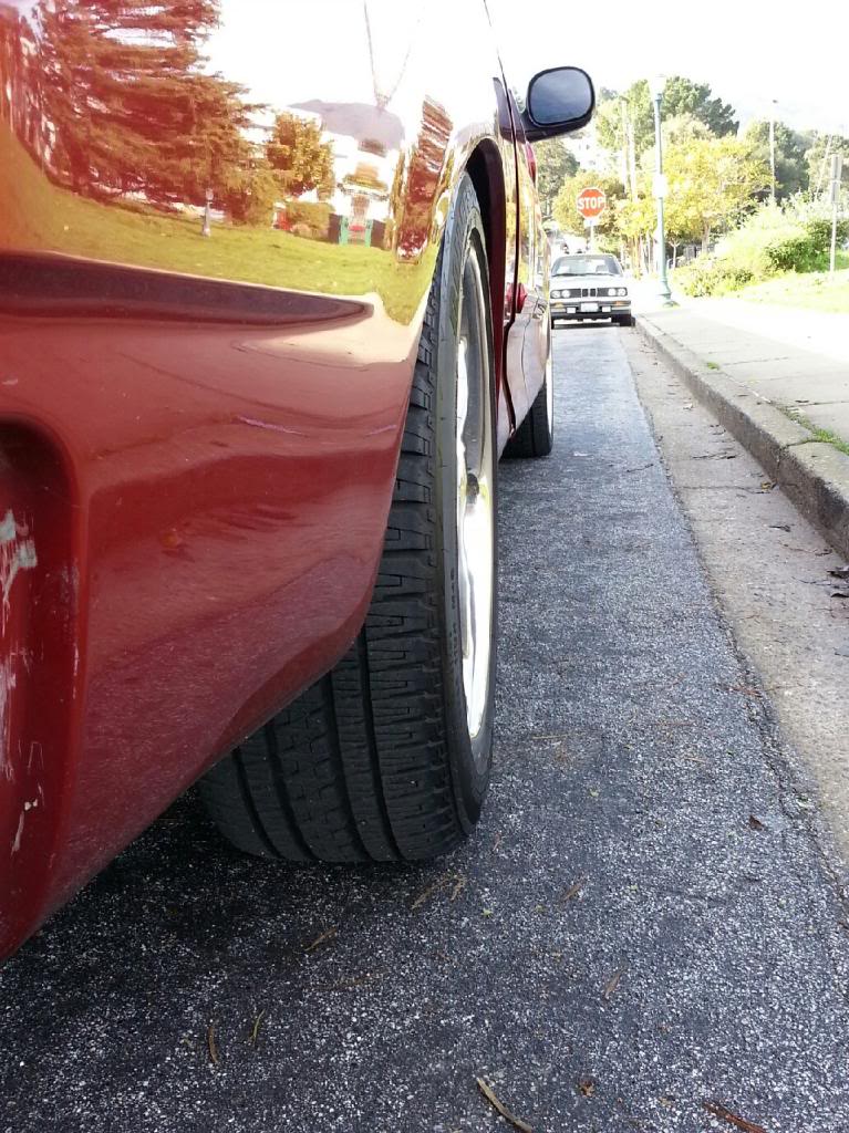

IN this view you can see the 285 45 22 protects the rim and the wheel doesnt really stick out
as for tires here is the 285 35 22 which was on rear before (you can really see how ****** rear brakes look front was just as bad thats why I had to repaint it all)
vs the 285 45 22 put on
