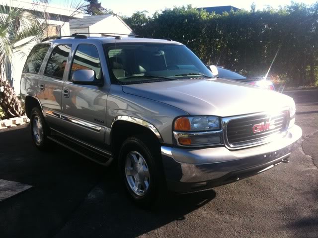

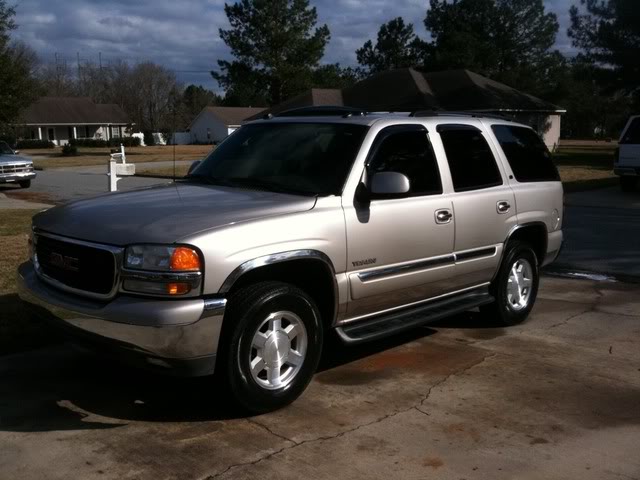

Hey everyone I've been lurking for a while but just now decided to post. I have a couple questions.
How capable is the NON-Denali AWD system offroad? I'm pretty new to trucks so i'm just curious. I wouldn't mind getting into some mud or something.
Also- Right now I've got the 265-70-17s on stock wheels. I'd really like to go as big as I can before needing gears or a huge lift. I'm already planning on keys and spacers. I like the Nitto Trail Grapplers in a 295/70 or the 35x12.50 17s. I'll be keeping my stock wheels for now to save some money. Will they fit? I know Another member did it with 20 inch wheels. Does it make a huge difference with my 17s? I don't mind a little trimming of wheelwell plastic. Thanks a lot.
Here are some pics of my truck. So far all I've got is the K&N FIPK. Tune and leveling kit should be soon.
