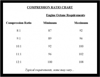

So for old engines (pre-electronic management, carburetors ) the hand rule was always, how higher the compression the higher octane grade you need. Otherwise (with too low octane) you get pre detonation and you will hear a "knocking" sound. which is really bad for the engine. I found this old chart on the internet:
If i look at the user manual, GM is saying it will run fine on regular grade 87. According to this chart gas with octane 87 is too low for compression ratio 9.5:1 used by the 5.3 vortec engines.
But i found out, that modern engines can handle even low octane gas by means of computer management of ignition/timing and the use of "knocking" sensors. (or whatever it called for)
But still, i think (especially under stress, towing, mountains, etc) the 5.3 Vortec runs better and more economic with octane grade 90/91. What are you thoughts about that?
...according to the US department of energy, in the US contains gasoline up to 10% ethanol. I think its not good for the health of the engine. Ethanol attracts water, and in worse cases you get things like vaper lock. Are there still gasoline's without Ethanol?
I drive and tow my Yukon LQ4 6.0L with 87. It's what the manual calls for, and I don't see any gains when I've tested higher octane. Our gas here in MA is all 10% ethanol year round. That does drop the MPG, but it's all I have access to. On my last road trip while I was towing my travel trailer one of the stations we stopped at had 91 octane that was ethanol free. I filled up with it, and really didn't notice a significant change from all the other tanks on the trip.
