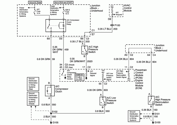

2 different issues and 2 different control problems that likely are NOT related. You can have Compressor Clutch working and Blower Fan(s) not working AND vice versa. Looking at the schematic for your vehicle you will see that once that ac relay is closed then all you need is 12v from that 10a fuse (fuse must be good in other words) and that low pressure cutoff switch in the low side refrigerant line must be closed (pressure needs to be roughly 30PSI+ roughly in other words). The low pressure cutoff switch is in series with the PCM which gives the A/C Clutch a ground for its coil which comes from pin C2-55 of the PCM.
Of course your clutch could be fried from a locked up compressor too or just normal wear and tear.
But you did say in your previous post to this one that your clutch "is making a nasty noise when I try and turn it on" so that leads me to believe that you are turning a/c on with engine running and the clutch is engaging or atleast is trying to anyway. If that is the case then look down at the clutch while engine is on and look at center of clutch and see if it is turning at a decent rpm. If it aint then it is slipping because of the air gap issue or compressor is locked up.
