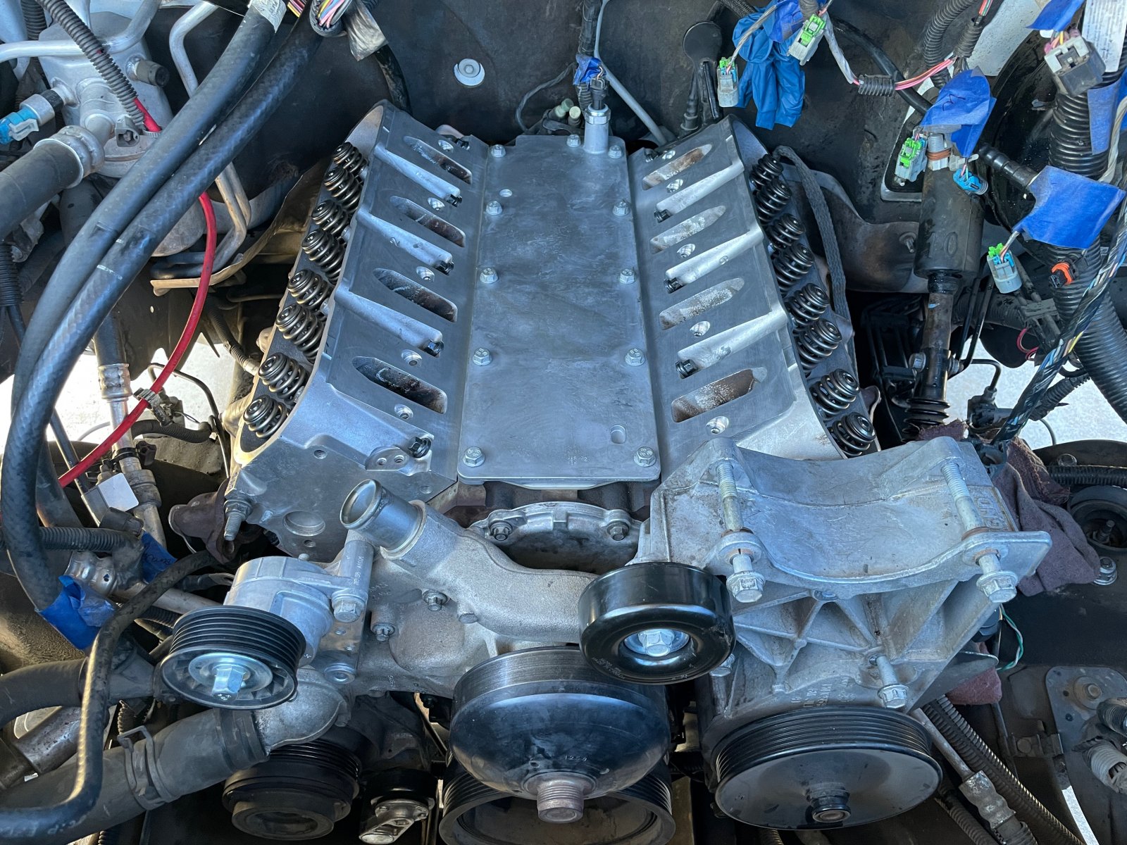

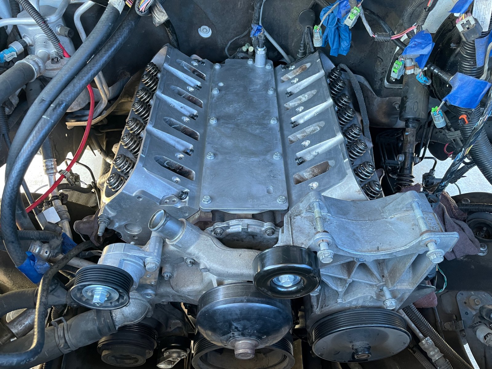

Well guys took the morning off work to take the cam out and here is what I found. At this point I am pretty bummed out, I don't know if I should just throw new cam bearings in it or look into having the bottom end rebuilt. I figure if the cam bearings are this bad the rest of it is probably the same condition. I don't want to rebuild half a motor when the rest of it is on its last legs. What should I do?

I would replace the cam bearings only, just to match the new cam.
Thats assuming you had no other issues, audibly, or visually with the engine that would create un-ease.
Was it just that one cam bearing or were all of them like that? That one looks like the proximity to the damaged lobe was its undoing. Replacing a cam bearing can be done with the engine in the truck as I understand it, but I've not personally done it. I do agree with Brian though that rebuilding the whole bottom end shouldn't be needed.

@Geotrash The bearing in the picture was at the very front and the damaged lob was near the rear, all of the bearing lobes on the camshaft had scoring on them so I assume the rest of the cam bearings look like this first one. I am doing research on how to replace cam bearings for now
Bummer man. My heart goes out to you. Sorry for the $hitty luck.
