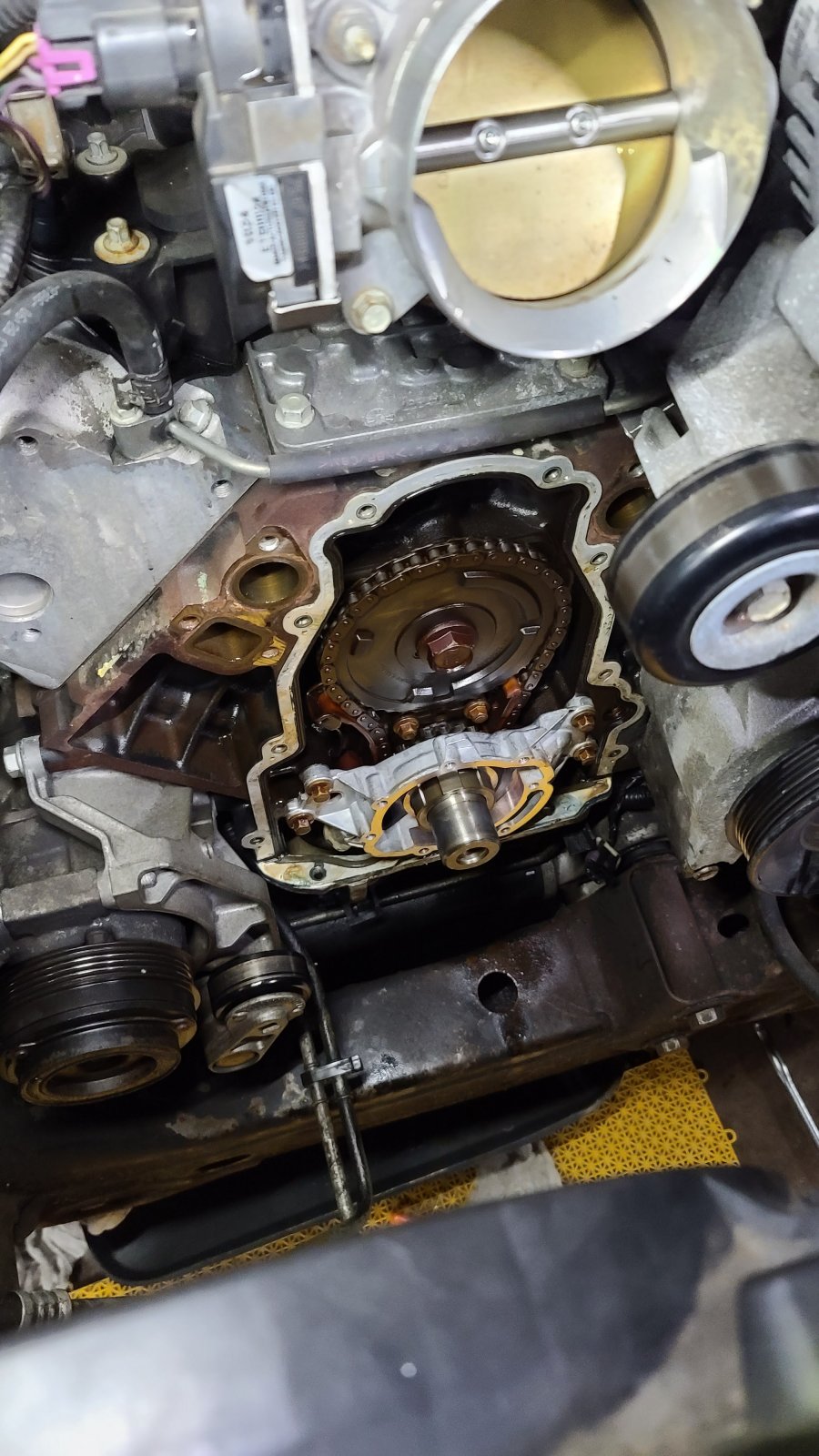

Got around to working on this project again. Installed the new pump. Rotor is larger in diameter and thicker too. The housing outlet passages were smoothed out and I filled the gears up with assembly lube before putting the front cover on right before starting it up so I wouldn't have to prime it the hard way through the side of the block.
Got it installed and put back together just to have the oil pressure immediately go up to 50psi cold instead of 40. The oil pressure after driving around and warming it up hasn't gone below 40psi since the new pump.

As it warmed up, I test drove it around the block and down the highway for 2 exits and back. The ticking went away in V4 mode and came back during V8 mode. I was thinking maybe the rocker arm for cylinder 7 was having issues since it was inoperative for so long. So I took off the valve cover and swapped the rocker around (AFM to non-AFM cylinders) just to see if the noise stayed in V4 mode or not. The noise still only happens in V8 mode. I took a video of the engine running with the valve cover off and now the oil is shooting out and over the fender instead of just dribbling out of the rocker arm oil holes.
Do you think the new lifters I got are bad? I thought there was supposed to be a gush of oil instead of long distance squirting. Maybe they're not pumping up like normal and are just letting the oil blow right through.
