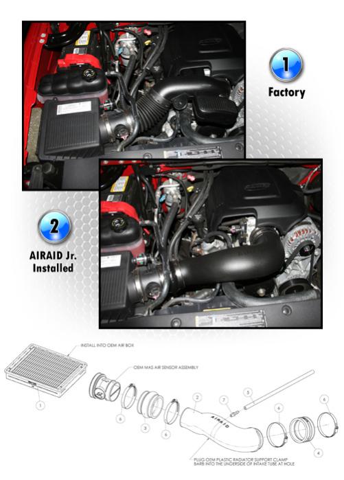

The only actual air flow gains you get with this AirRaid JR kit is with the air filter supplied.
The tube only smooth's out the air flow, this helps a little but very minimum at best.
The air flow still has to travel first thru the short smaller section that the MAF sensor is in..
You could go with just a aftermarket air filter and not really notice any difference.
Doing a dyno it might show but very minimum gains if any.
Most defiantly NOTHING by the seat of the pants testing, by comparing the two.

The issue on the stock intake is not the filter and box, it is the Helmholtz tube. To decrease the sound of the intake air, the is tuned to a specific frequency which causes airflow disturbance.
The dyno doesn't lie. Keep in mind, our testing was done on one vehicle on the same day, same conditions. The results were without tuning.

The dynos show the most improvement was gained from changing out the intake piping. That is where the restrictions are, so any upstream changes will have relatively minimal gains. In the end the gains are relatively low.
Don't get me wrong, I am all for DIY performance mods and have done quite a few on my vehicles. Since I am cheap and have little time to work on vehicles I have to be efficient in choosing my mods.
I applaud those who try various things and share :cheers:. If someone would like to dyno the larger intake hole, versus aftermarket, versus stock that would be great :peace:. IMO the results will be similar to the dynos already performed.
