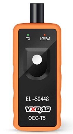

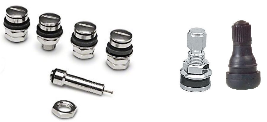

Brandon, why are you using metal valve stems? While I bought 4 new factory takeoffs, I only replaced them as they failed. That was dumb as now I had to pay to dismount the new tires just months after putting them on.
Also learned that to reset sensors, all other sensors, vehicles and remotes had to be kept far away from the host vehicle. The sensors are supposed to last ten years but my truck had the original 4 replaced about 13 months after it was built and then 2 of those were replaced less than six months later. So those lasted an average of seven years and my new ones are now three and a half years old. I figured on replacing them all when we put new tires on in the next year or so.
I reckon though that if you use GM sensors with the rubber stems, they should last at least 3 years up there. Prices have come way way down too. I paid less than $50 for my OE 2016 take-off sensors in 2017 and have seen even better deals since.
Hey James :happy160: Most tire shops are using the VDO SE1001HP Redi TPMS because they are quick and come pre-programmed for relearn. While they do offer them in the rubber stem configuration, they dont seem to be using them for some reason. Maybe they break more often when installing them? I dont know.. Either way, rubber or not, the batteries just dont last long in our climate. OEM sensors can cost $100+ each but the Redi brand and after markets sensors are $30 apiece. I think most people simply dont have a clue as to what is involved in the programming or relearning but tire shops portray it as rocket science and charge crazy amounts for this service.
