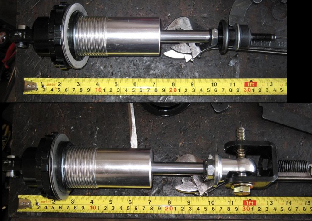

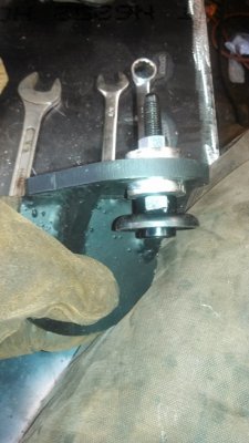

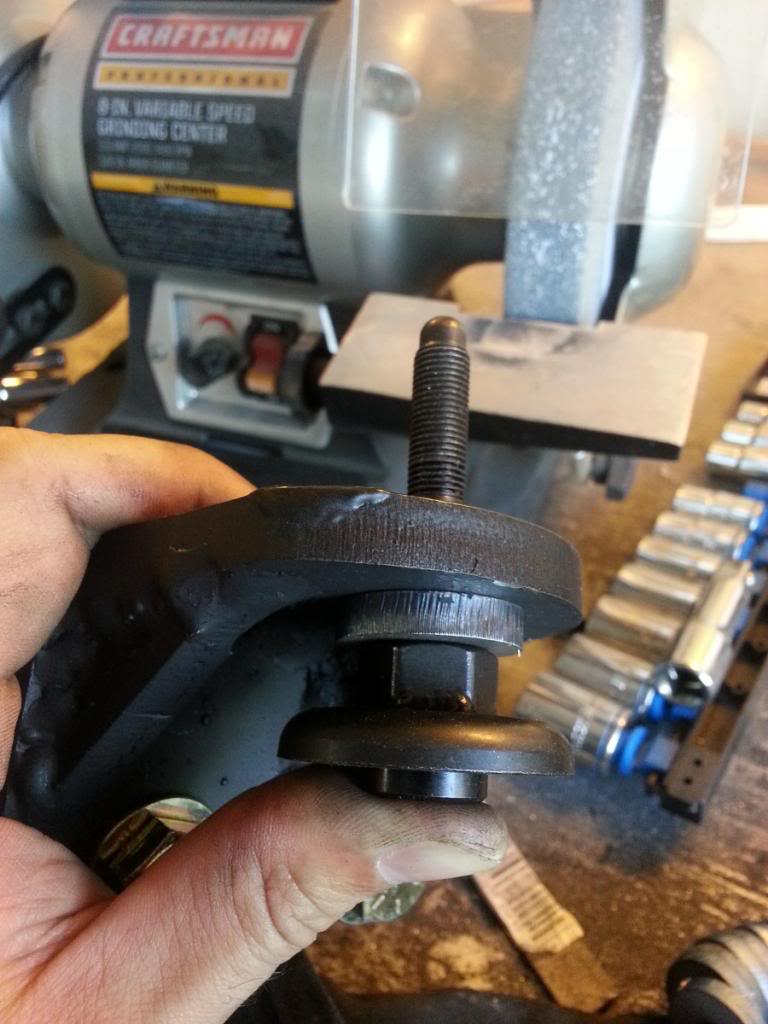

Shocks have a certain range that they recommend running the ride height, so relative to the shock the ride height needs to stay pretty constant (within an inch or so usually). Longer stroke shocks have a wider "ride height" than short shocks. For the spring, you can run whatever preload and stiffness you want, just as long as the shock stays in its range. The danger of running a lot of preload is having coil bind before the shock has all its downtravel.

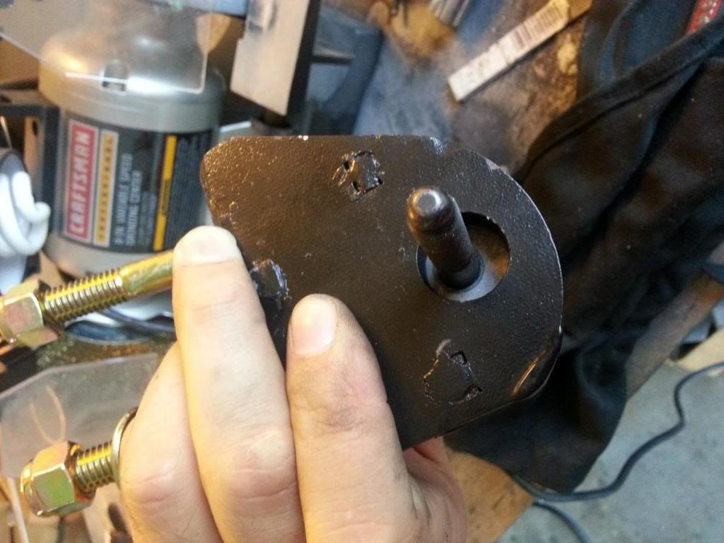

If by raise top mount you mean the stud mount, then yes you could do that and it gives you 1.5" of room, but the bushing is iffy since this is more weight than it is designed for. There is nothing wrong with a solid mount, so Im not sure the bushing is absolutely needed...

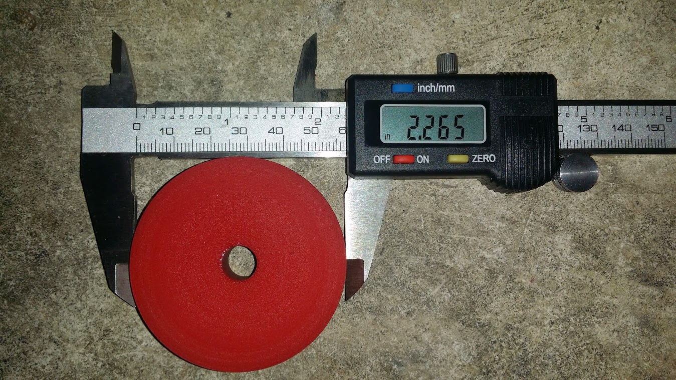

Still very interested in this mod. Gotta get all the buggs worked out tho. The fellow over at PT.net that has the stud mount top just tried a different rate poly for the bushing. Need to see how that goes. I wouldn't see a problem with putting a derlin or solid material in for the stud mount bushing. Not like it needs to move left to right or rotate unless I'm missing something it's still just a shock right?? I deff think us that are slammed would need the stud mount to gain the travel and for it to work. That's my thinking....any thoughts?
