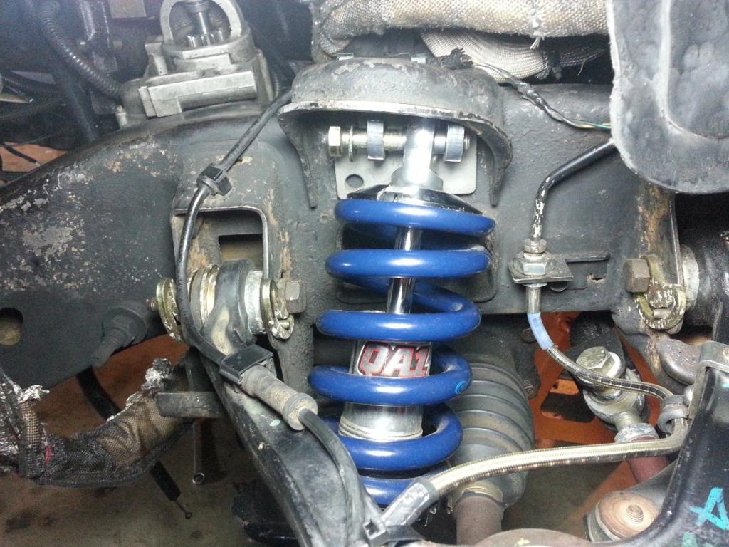

I put together a quick list last night of what I think would fit and what I need to make it work...
Qa1 coilover shocks, hyperco springs, atomic brackets, new lca's, bumpstops up front
ridetech adjustable shocks, tony's 6" springs in the rear
Roughly $1700 total... I have no problem spending the money, but I DO NOT want to do it twice, which would actually be a third time bc this is already the second go round. The ride right now doesnt bother me bc ive always had lifted trucks, but I know my wife hates it, and if I spend $1700 and it still bounces around I would never hear the end of it

Coil overs installed
COIL OVERS INSTALLED -
Review coming soon. Just installed.
I'll leave you with one word ---
WOW - Vast improvement over torsion bar setup. Even on the firmest setting on the shocks, still better ride and control.
ok, more than one word. lol
(ecstatic)

For a quick response:
For pics, honestly none really of the install, its quite simple, bolt on mostly. With the exception of cutting off the corner of the bumpstop bracket and the little section of frame right there (as are in atomics pics) If you look at atomics pics, mine look identical.
But one thing to note, i did not drill holes for the bolts for the upper brackets. I saw no way to do it (to bolt them on the backside) as the motor mount is right there on the drivers side. So i just welded them. I think they are only about 3/8 thickness anyway. Not a big deal to me.
Pics, parts used (which is exactly as Atomic listed all of them will be used if you use the procomp adapter, as no bushings for stud mount have held up at this time) details, reviews, etc.. hopefully tomorrow.
And height, i am at the same exact height as before i started the install. 32 ground to fender or 16.5 center wheel to fender bottom. Not a difference at all. But the only negative is i can only go up not any lower till someone finds a bushing that works for the stud mount. But at this present time, I have absolutely no complaints.
