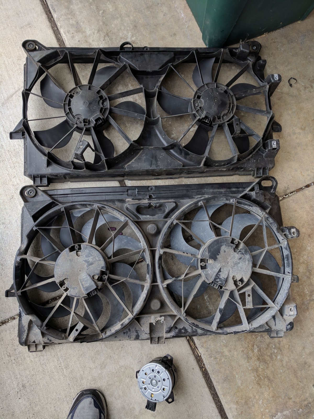

let us know if the 700w fans help any.

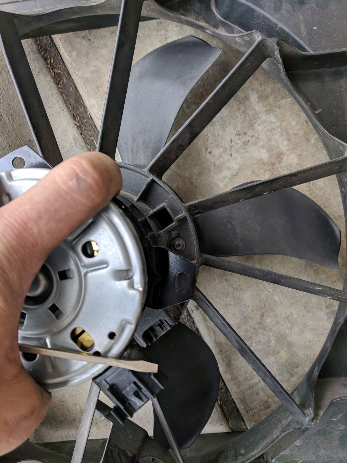

The one in the link was exactly what I had. And I do not have the k5l option so they are the 500 watt motors. The research is scant but it should be 5/5 or 7/9 blades. And the motors are not interchangeable. The 5/7 is what I ordered and they are the wrong ones for anyone who finds this post 2 years from now. I'm bracing for a fight with that ebay guy as he had them posted as k5l fans.
