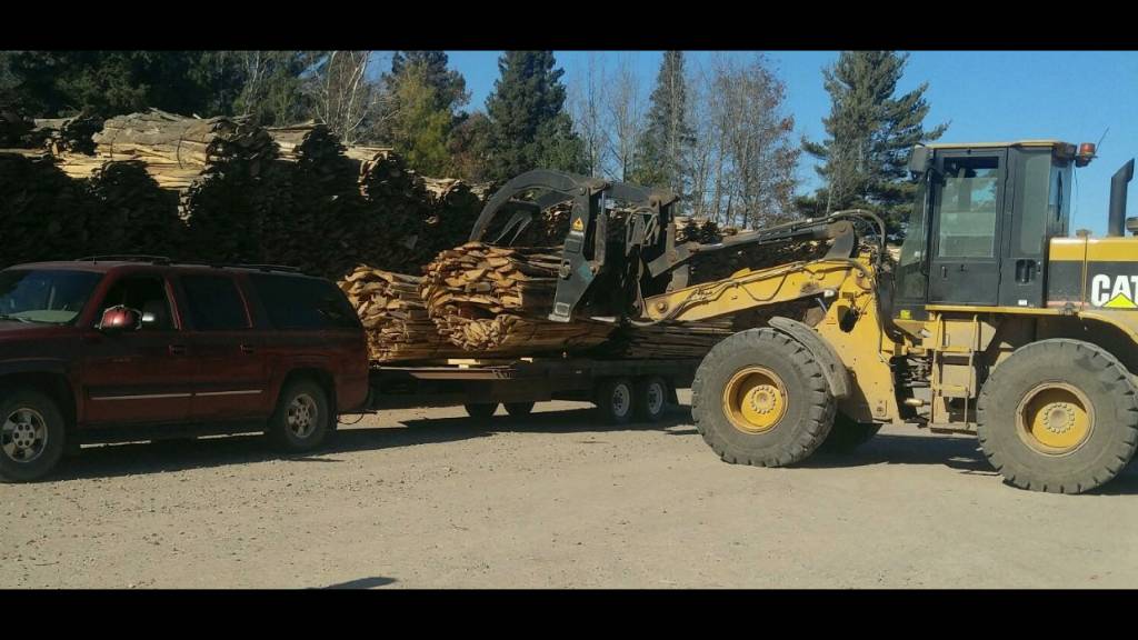

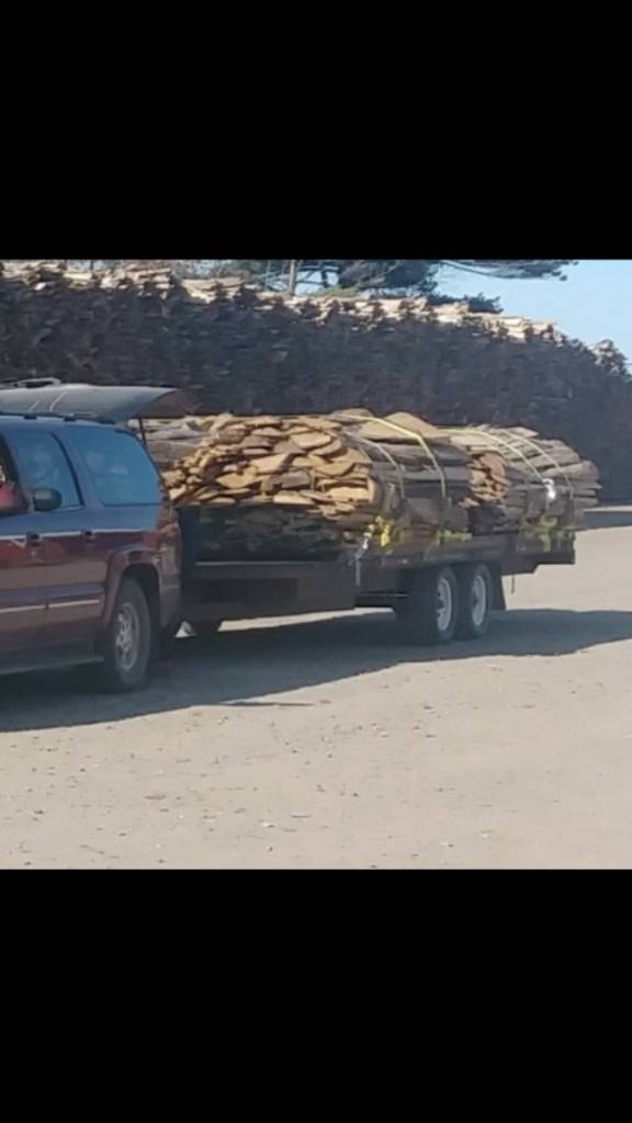

I'm hitting 14,606 lbs GCVW on 1/2 ton you guys should be able pull alot more then me . That's with a 5.3L 3:73 4x4 rolling at 55-60 mph good trailer brakes.
Weight distribution hitch with about 800-1000 lb tong weight . And it can do it all day everyday. I got another used 1/2 4x4 this ones got 4:10 ( good for 14,000 GCVW ) I'm sure it do even better job. Last year hauled 63,650 lbs with the rig total in multiple trips. I have realised it's not about takeoff power when towing it's more can you control the load . And get it rolling again . 295 hp on 4:10 for sure a force to be tamed . Durability is key. And keeping heat in check .[emoji106][emoji3]
