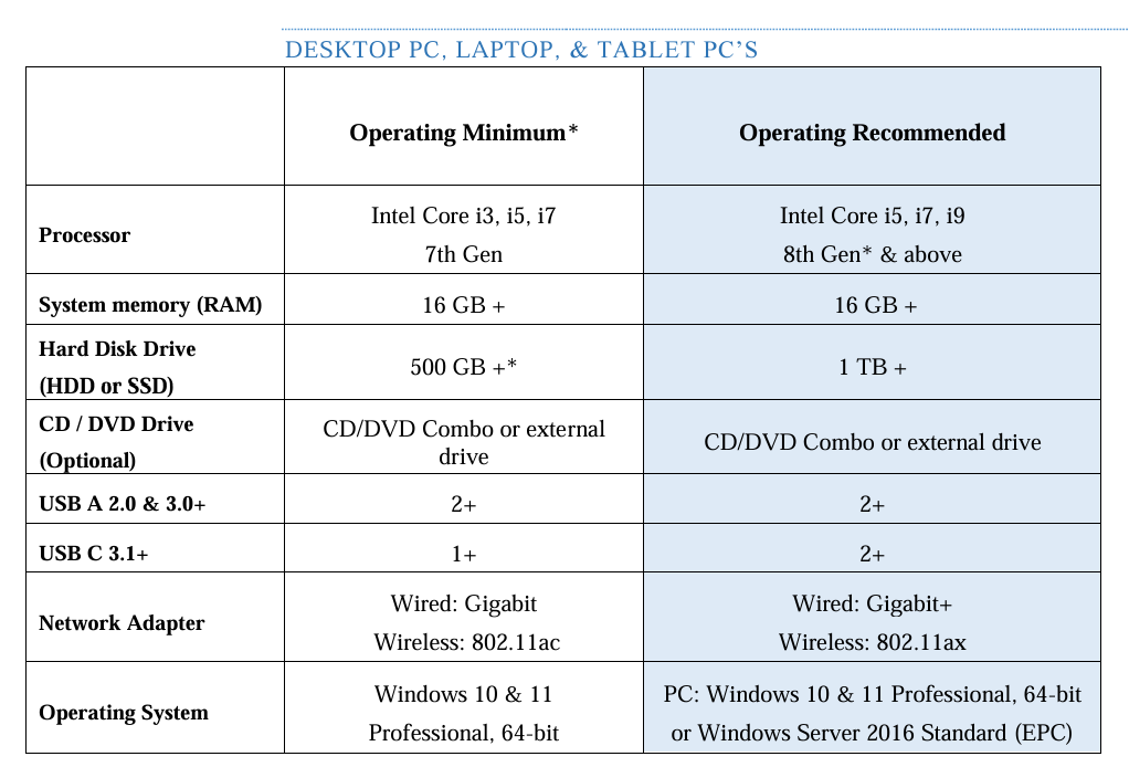

So I decided to try a different computer, I read some other posts about making sure you have the minimum hardware covered and admittedly my Surface 7 does not meet that. So I drug an old gaming tower down to the garage and hooked it all up.

Great work! Keep us posted! And what are the minimum requirements for SPS programming?
