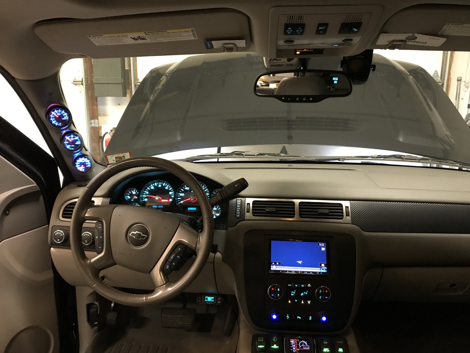

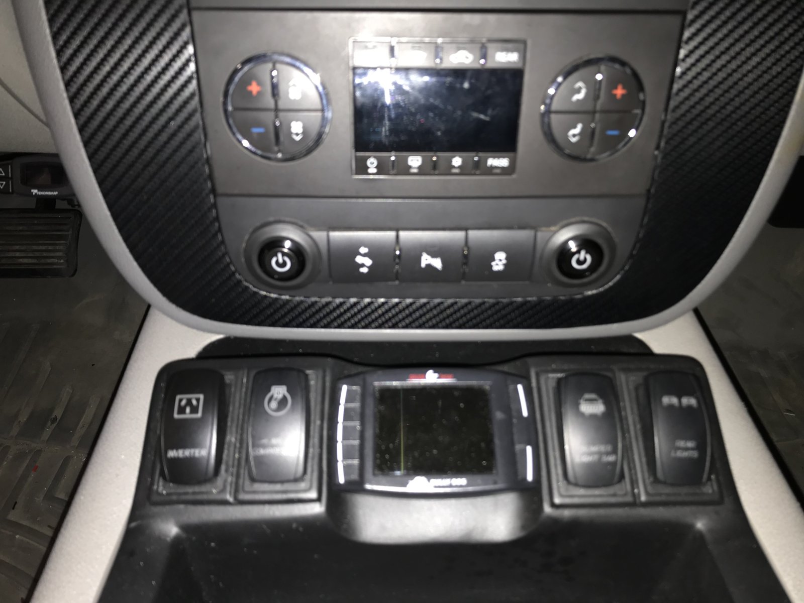

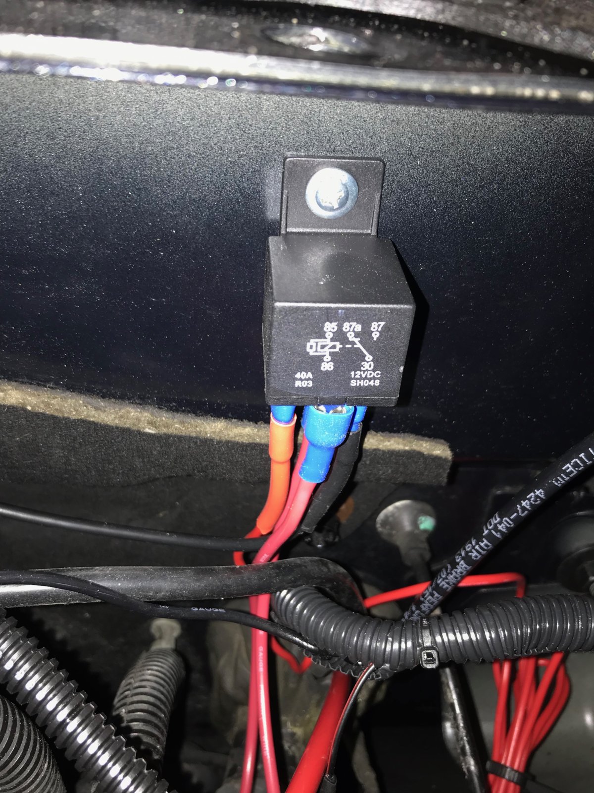

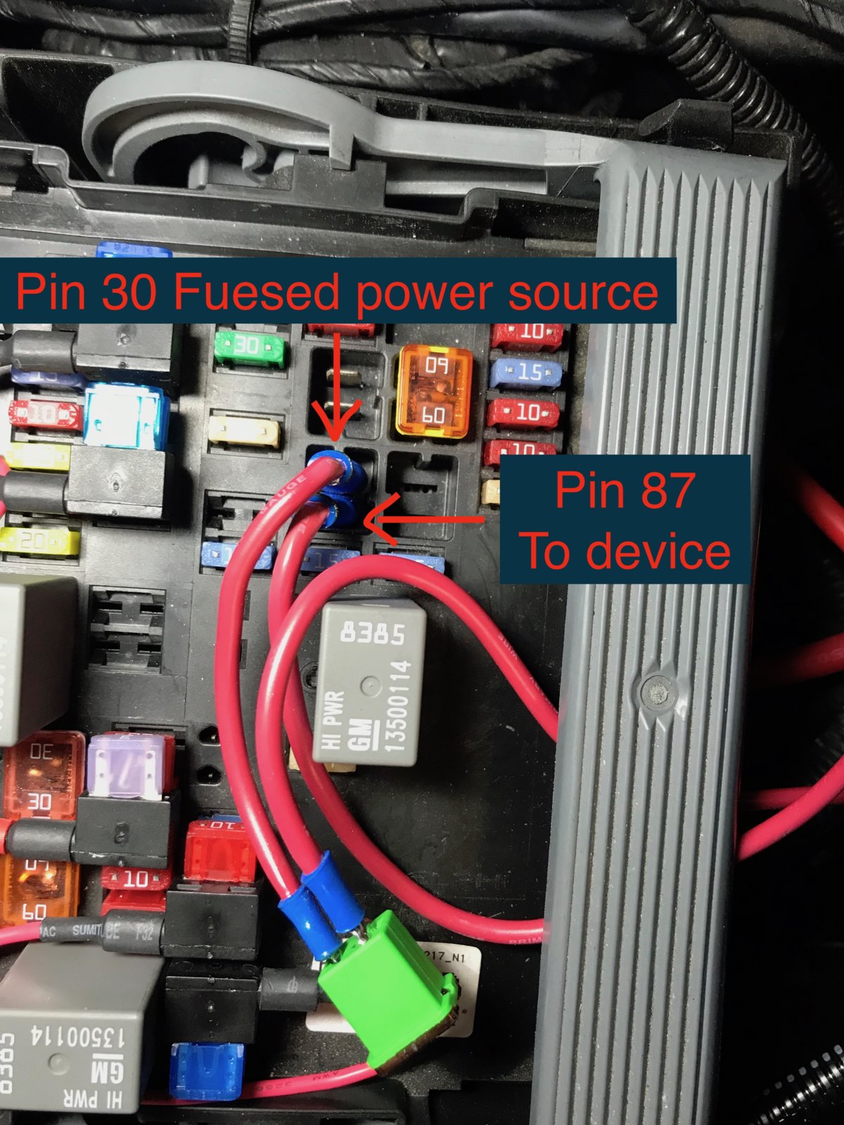

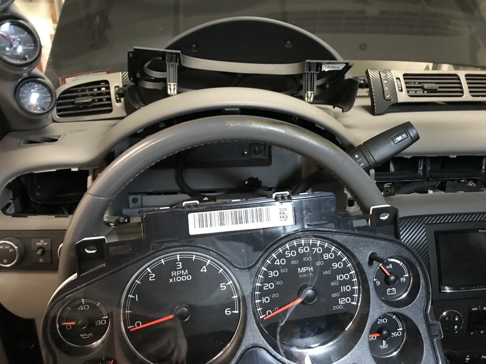

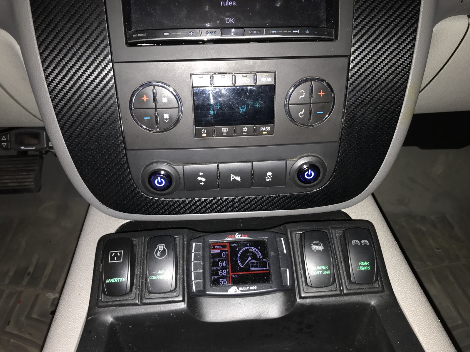

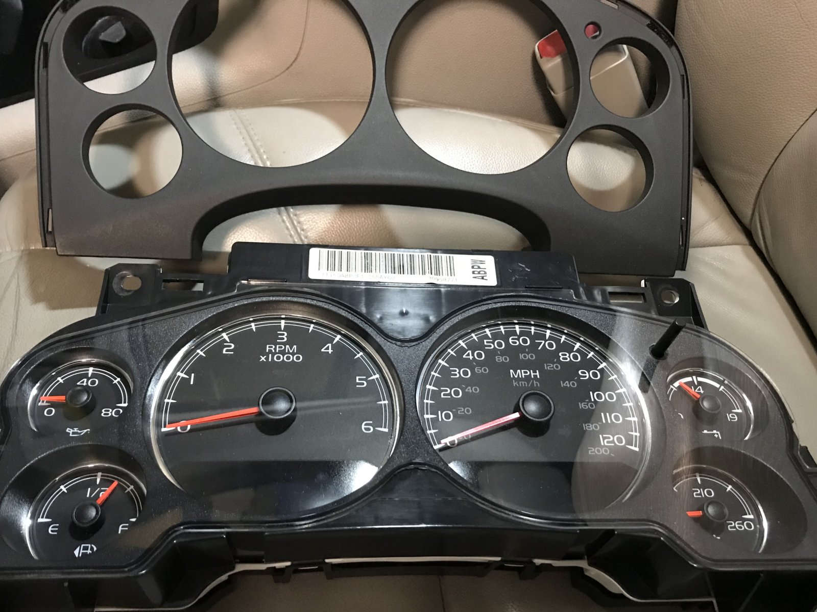

Here is some pictures of Big 3 upgrade and 2nd battery system, first impression on the national luna split charge system is very positive, should say I rarely get that excited about stuff. I will give you guys more info on it after few months of use. The biggest plus of the system for me is that I can charge my primary battery (starting battery) from 2nd battery, jump start myself, 2 the same batteries are not required and this system does not interfere with truck electric. Here is a link of another guy install and his review there is 17 videos (parts) to it.
