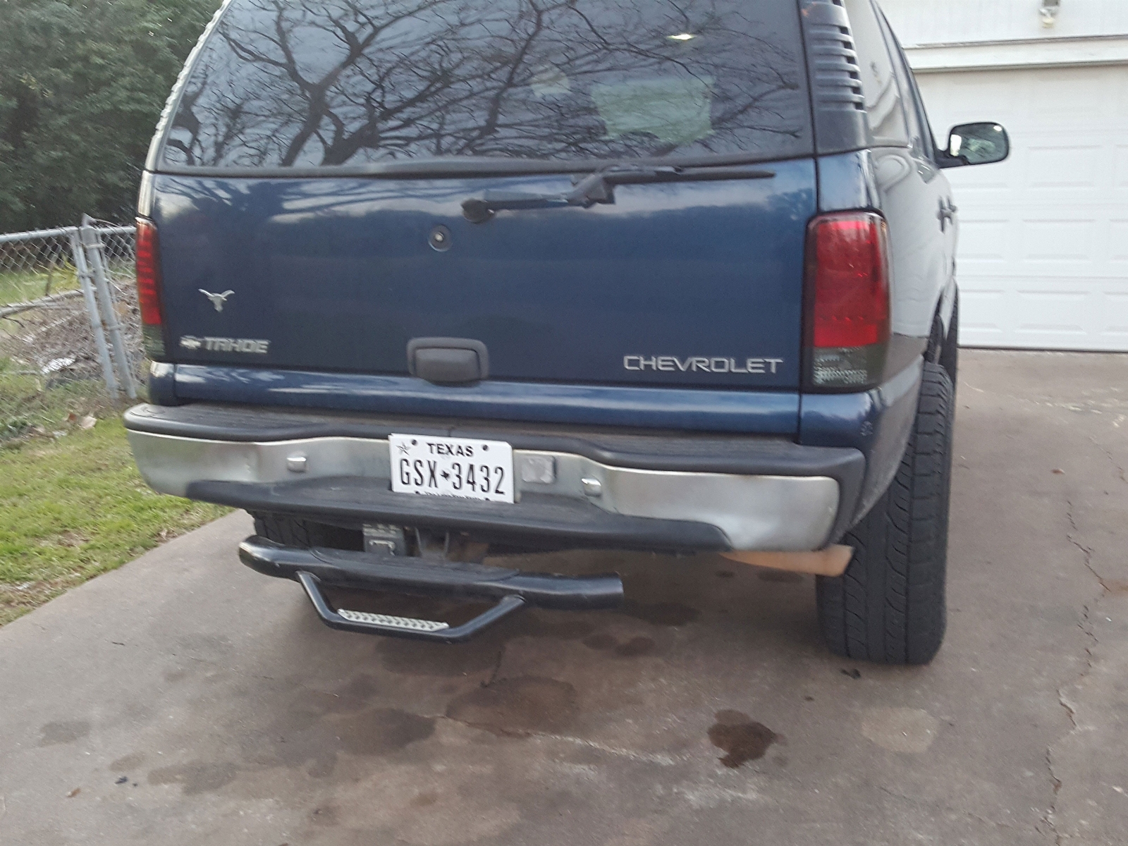

Installed the 3" rear coil spacers and adjustable panhard bar from Supreme Suspensions. When you go up over 2" in the rear it can mess with the lateral movement of the tires/wheels. Mine were sticking out about an inch or so further on the passenger side and the adjustable panhard bar put it back to normal.

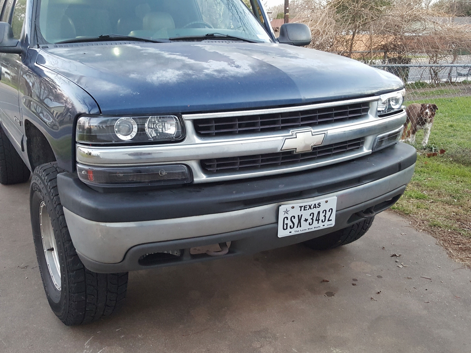

I added the Ford Raptor Style Amber LED Grille lights that are slowly growing on me. I wasn't 100% sold at first, but I've gotten a few compliments on them already, so I guess I'll keep em. I also added a Daystar Jeep Rocker Switch A-Pillar Mount that ended up fitting perfectly and looking pretty custom too. For anyone that doesn't follow college sports, the "Hook 'Em" switch is for The University of Texas at Austin's hand signal for Hook 'Em Horns. I ran out of ideas basically and the lights are kinda orange... I might end up smoking all the front lights to match the running?cab lights one of these days too.
